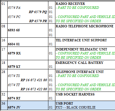

Ok, so you have the "RD4/MP3" RDS COMPACT DISC AUDIO SYSTEM, but with independent telematic unit and USB cable already (good - as you'll need that to update the maps etc.)
So the configuring will be key in Diagbox, to ensure the correct screen is picked up and that the options are ok. The Dual tuner settings should be fine as that is what you currently have. I strongly suggest you write or print out a backup of ALL your BSI settings and the Head unit and display ECU configurations before doing the upgrade so you know what the original settings were.
Hard to say whether you will have the positional problem with the sat nav that Vborovic had - time will tell. There should be no reason why the parking assistance should not work - you already have front and rear detection - so that should transfer to the screen.
The steering wheel commands should work once the correct system is configured in Lexia.

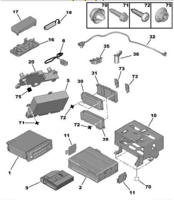

I can tell you what you do have from your VIN. Only the parts on the Diagram that are indicated on the key - if they are not on the Key, you don't have them.
There are so many options even between Exclusives - depending on options and Head Unit systems that a lot is guesswork until you get the unit out and start seeing what you do and don't have.

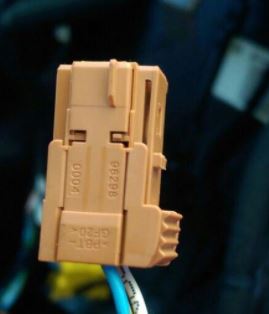

Hi. I have bought the navigation RNEG2 that I was talking about. What is still unclear for me and perhaps you can help me...I can't found if the brown connector from my small display is the same with the connector from RNEG2 display. Or if not, if I have to adapt the connector according to the pinout indicated from the colleague vbrovic. But if I have to do this, then what will happen with my connector from the car? Shall I leave it in the air there? Thank you very much for your help, again.
vlad2004v
- Posts: 88
- Joined: 27 Sep 2017, 13:30
- x 2
Re: C5 X7 2-in-1 navigation tutorial
I found out that the old small display has a completly different connector. Therefore my question is: Shall I leave it in the air and link the connector from display with + and gnd? I will not have troubles with error codes?
- x 6946
vlad2004v wrote: 01 Oct 2017, 08:41 I found out that the old small display has a completely different connector. Therefore my question is: Shall I leave it in the air and link the connector from display with + and gnd? I will not have troubles with error codes?
Old System (RD4) and Mono Screen
Ok, so I've had a look at the wiring diagrams on your current system with the standard audio and screen. There should be a brown 12 pin plug, although only 4 pins are used. These carry the CAN High, CAN Low network signals from the display to the Audio Unit, the Independent Telematic Unit, the Instrument Panel (on the Dash) and the BSI. Additionally, there is a battery positive and a negative. Those are the 4 wires on the brown display plug.
New DG4 Display
The DG4 Colour screen will have 2 connectors.
Usually a 10 Pin White and a 6 Pin Brown.
- The 6 pin Brown contains the Lighting rheostat control, the positive and earth (only 3 wires used).
- The 10 Pin White connector will contain all the digital video signals. Both these are connected to the back of the new Head Unit.
So you need to wait and see what connectors you get with the system - you really need the proper Brown and White ones.

I have received the interface cable between the display and the RNEG2 unit. It's clear that on the white connector I will insert the interface to the main unit.
For the brown one, I will leave it in the air and deactivate the display type from Lexia. I also received together with the new display the connector from the car. And it has not three wires, but two (photo attached).
Therefore I will connect these two wires to pins 9 and 15 from the main connector of the unit. Is this right?
And for the main connector of RNEG2, everything seems to be fine. So Shall I connect directly my connector from the car with the new unit? Will it work?
Thank you.
Thank you.
