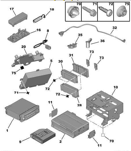

Yes, sorry I can't be of more help - my system is totally different with services module and everything else. I think from what I could read up on the first few pages I linked to was that he needed a microphone and a secondary video cable and the wiring for the microphone - he also had to change the pin outs and buy the GPS receiver. The reason it is difficult to say is that Vborovic did not have the 'Exclusive' to start with, so he would of been missing some wiring for sure. I can't say what you will have as standard until you get the unit out. According to your VIN you already have the microphone and wiring as you have the independent telematics unit installed already.
There are so many options even between Exclusives - depending on options and Head Unit systems that a lot is guesswork until you get the unit out and start seeing what you do and don't have.
I can tell you what you do have from your VIN. Only the parts on the Diagram that are indicated on the key - if they are not on the Key, you don't have them.
