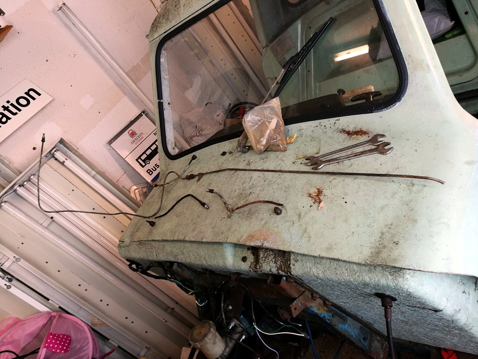

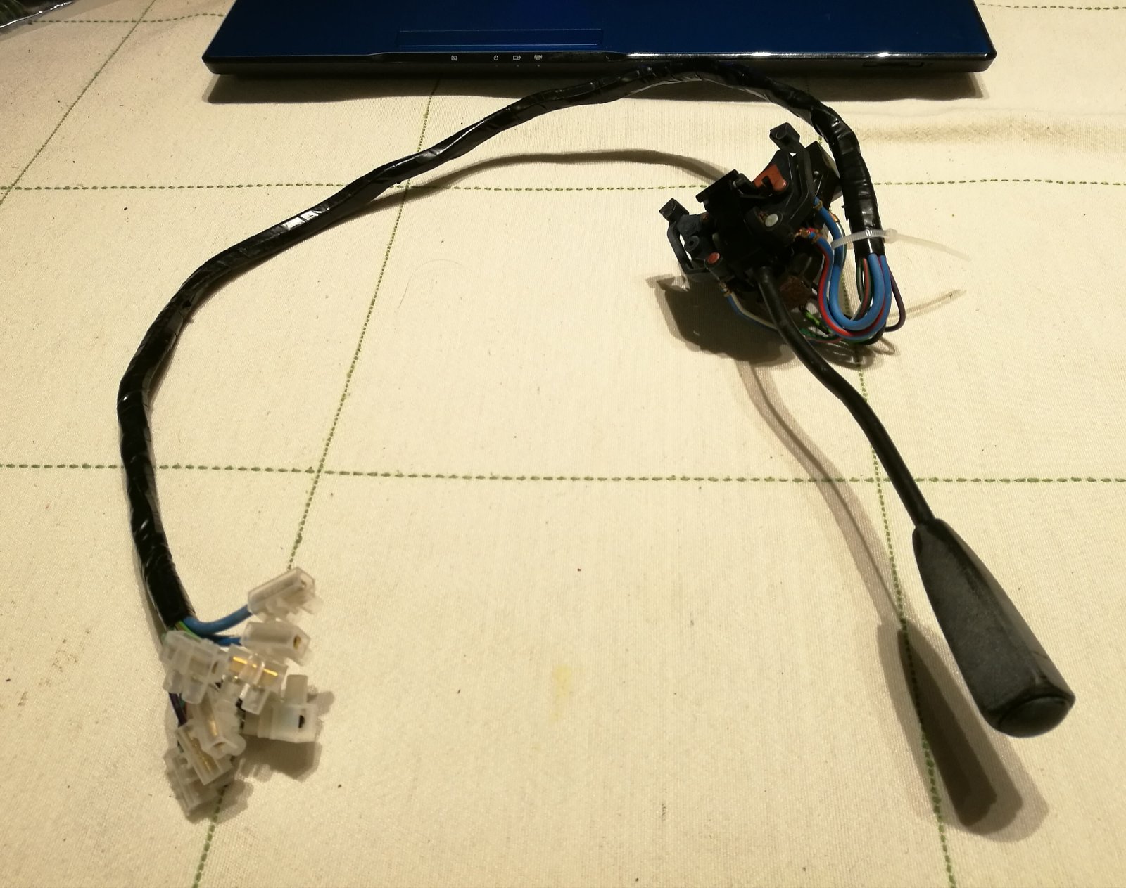

Today I had two tasks in mind. Firstly was to get the indicator stalk assembly off the spare handlebars. This involved getting the drill out to drill out the one screw that someone had rounded the head off of some time in the distant past. Then allowing me to get at it to unscrew the remains.

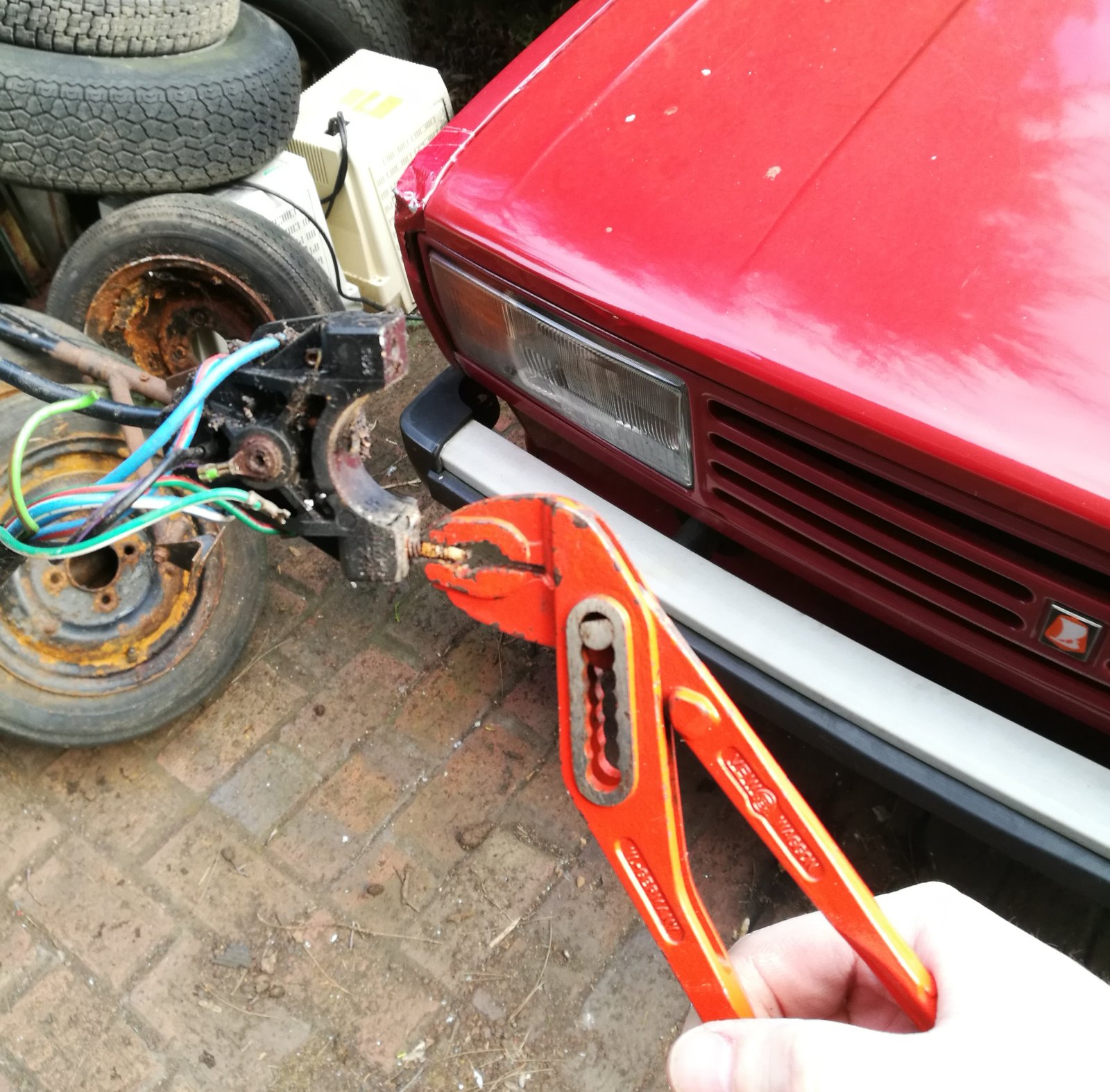

This pair of adjustable grips is a standard piece of the Saab 900 toolkit, and is one of the most used tools in my toolbox.
I am however going to need to do some repairs to this before I can fit it, as there are several broken wires, which are going to be at best fiddly to sort...Waiting to find out what car the stalk assembly is shared with, as it a replacement is readily and cheaply available I may just opt for that.

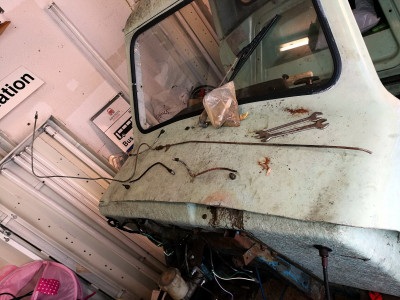

Next task was to get the rigid brake lines off. Having the correct sized spanners made this a much more approachable task. This is one of those areas where the quality of fasteners etc that have generally been used on this thing really shows. Every single union came undone without any drama, any stripped heads or anything. The only slight casualty was the bracket the rear T joint body is attached to the chassis by is now slightly bent.
Here's what came off...
I did cut the main front-rear section in half just to make the job simpler, as I had perfect access to do that with the floor currently out.
...The final bit of the front-rear section is actually hanging on the master cylinder, I forgot to pick it back up for the photo.
The only bits I've left be are the first pipe from the master cylinder to the first union, and the pipe that goes from the rear flexi to the rear wheel cylinders, as they look fine. The one to the front flexi would have been fine too if some idiot (that would be me) hadn't nicked it with the grinder when cutting the master cylinder bolts off. Oops.
Will be having a closer look at the rear wheel sections before I make a final choice on whether they come off too though as I'm not taking chances with this - especially as I know I've said this before, but it bears repeating...You don't take chances with a single circuit braking system as they don't take prisoners if things go wrong.

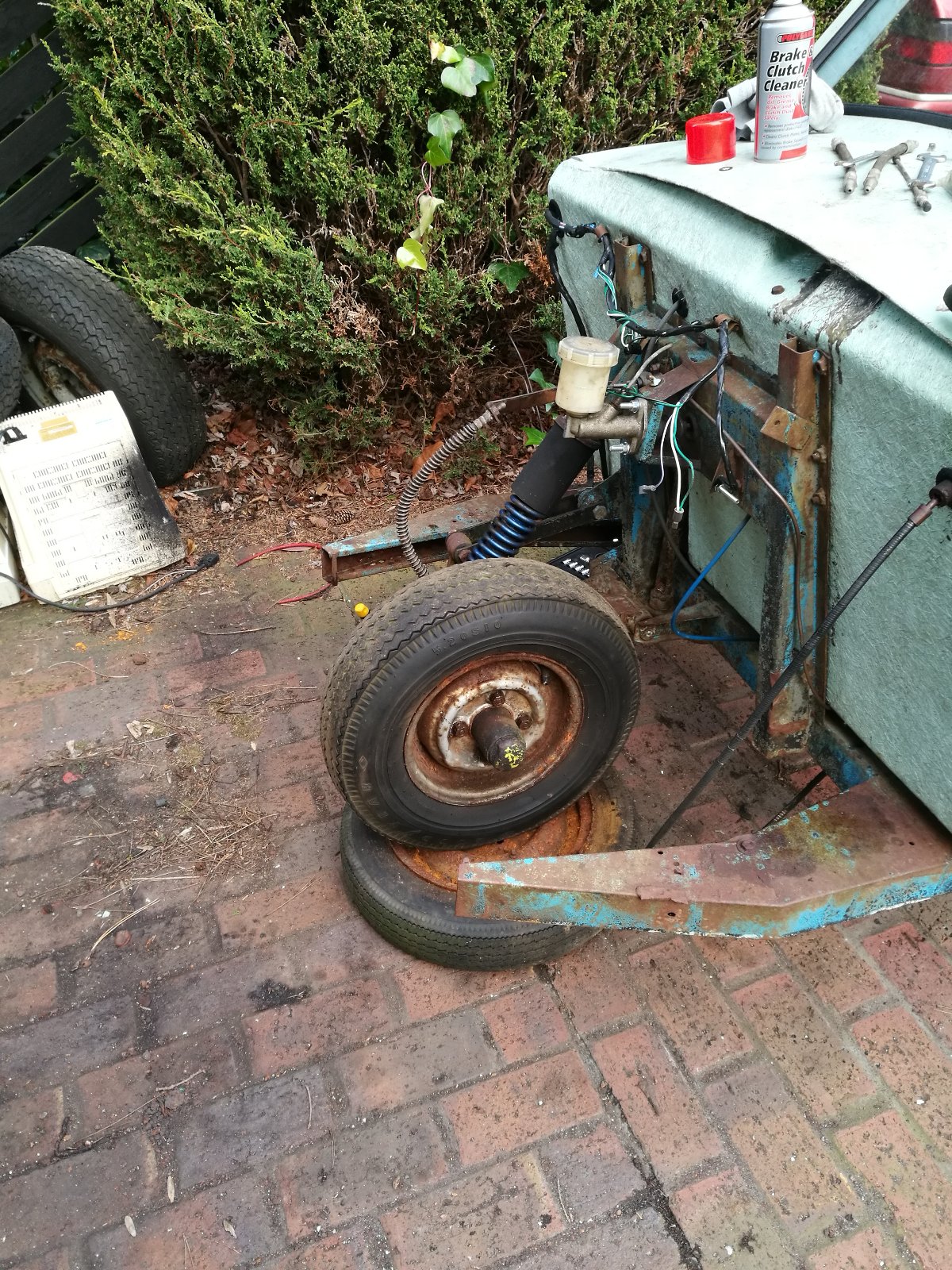

First up was hitting things with hammers. Have successfully managed to free off the parking brake mechanism. This is good. Can confirm it's working nicely on the wheel with shoes in as well. Planning to get that reassembled tomorrow.

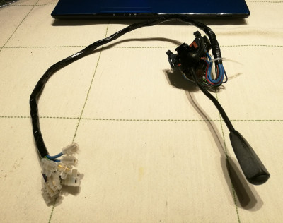

This evening I got the indicator stalk assembly cleaned up and reattached the couple of wires that had come adrift. It's not pretty, but should do the job. Have also attached screw terminals to all of the wires ready to be reunited with the rest of the loom.
The fuel tank I've got is definitely full of gunk... cleaning that will be "fun" I'm sure.
Will have a dig around tomorrow as well to see if I can track down some suitable materials from which to fabricate a battery tray, as it would be nice to get that back in the right place again.

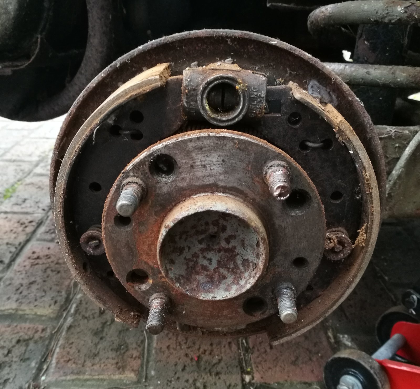

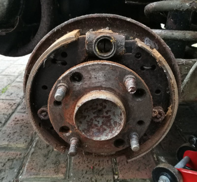

Okay, first task for today was to reassemble the one remaining wheel as I now had the full compliment of clips etc.
Jack it up, wheel off, drum off...
...This one hasn't been dismantled.
Cue much swearing as I'd been sitting around waiting for a week to get bits that it turned out I didn't need. Have also confirmed that the handbrake is working on this one too. It will happily hold the car sufficiently well that I can't push it, the cable is still binding quite a bit though - will give it a thorough greasing as soon as my grease gun appears (there's a grease nipple on the cable at the mid-point).
Fine...Stuffed that wheel back on (with a full compliment of four wheel nuts rather than the two it came with) and turned my attention to the rest of the brakes. I knew I had quite a few bits of NOS braking kit floating around, so decided to do a bit of a stock take.

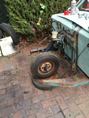

First up was a new full front-rear section, still in its massive cardboard sleeve. That was immediately dug out and I set about installing it. I was definitely right to do this before putting the floor in, as threading it through the cutouts in the chassis would have been quite fiddly from underneath.

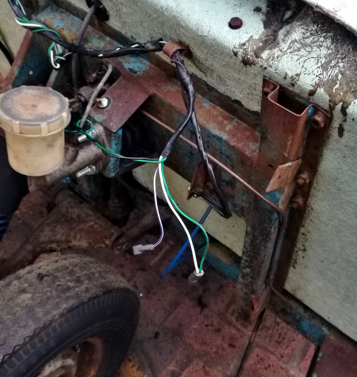

I needed a bit more height to get at the union between the two sections at the front (which is helpfully under the bit where the floor and body overlap, so there's no access from above!)...however was able to do something you just can't do with normal cars.
Now this doesn't look too unusual...what's unusual is that I was able to simply pick up the front wheel by hand and plonk it down on that wheel rim. I should have used a couple really, but one actually gave me ample space to work. Rear wheels were of course chocked so it couldn't fall off.
You can't really see much difference here - but there's now a nice new brake hydraulic line running from the front distribution T right back to the identical one which splits the feed to the rear wheels just ahead of the rear axle.
Even successfully managed to get it back into all the original clips. I'll probably cut a bit of rubber pipe and put it in where the pipe goes past the upright and vanishes under the body - I don't like the idea of the pipe rubbing on that unfinished metal edge.
