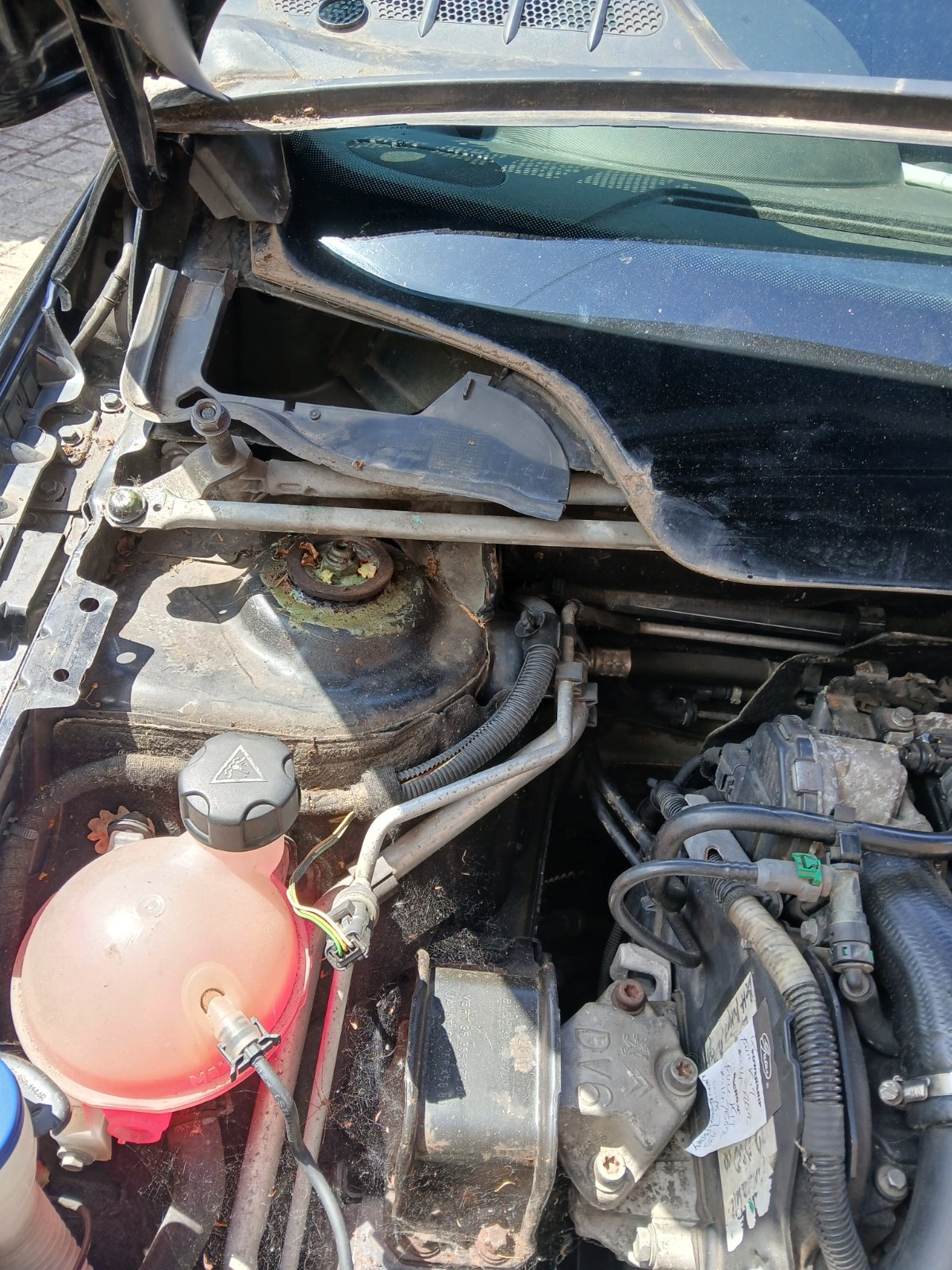

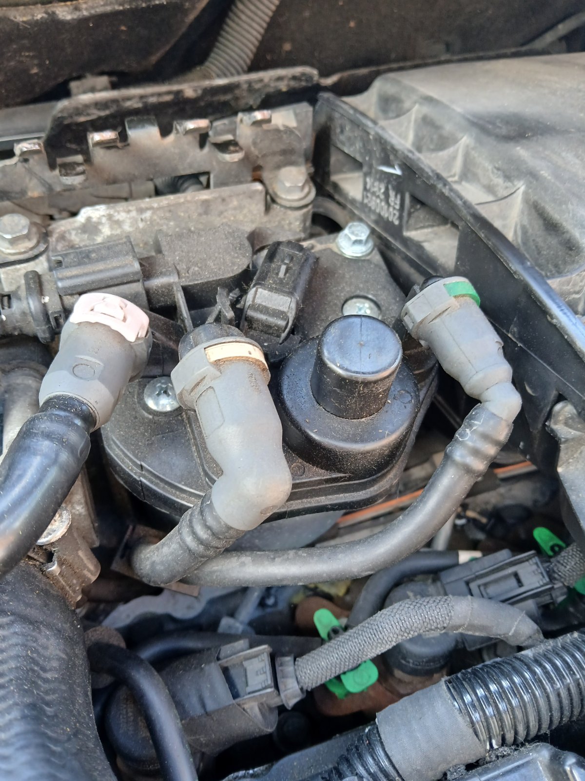

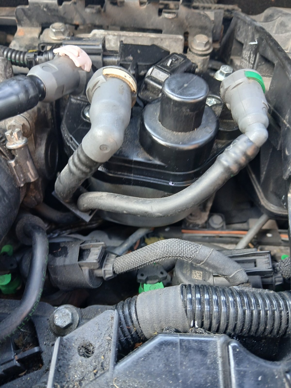

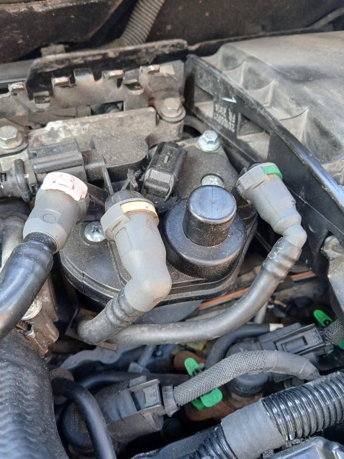

Right so today out with the old fuel filter which shock the screws that secure the metal canister to the top part were just over a tad finger tight ! Any way I still changed the part as id purchased it several days ago and it was time for a new one.
I primed the system by turning on the ignition 8 times counting 10 seconds each time I them tried the primer button on top of the filter housing and it was hard , it wasn't like this before the change over . So time to start the car . First turn first start . Lovely let it run for 2 minutes switched it off then did another scan , cleared the old stored codes then re scanned all clear , then went to live data with Gemini helping .
Vehicle Service History Record
?Vehicle Details:
?Make & Model: Peugeot 308CC
Registration: AK60 PDU
?Service Log Entry
Date
04 July 2026
Mileage
152,311
Service Description
Fuel Filter Replacement
Status
Completed the following.
Active Diesel Particulate Filter (DPF) Regeneration
Notes:
?The active DPF regeneration was successfully completed during a 20-minute run on the M23. ?The cooling fan ran on full blast for approximately 2 minutes post-ignition shutdown, confirming a successful cycle termination. ?The dashboard warning light has cleared, and the vehicle is running smoothly.
Some photos
The inlet fuel pipe might need a need push fit connector any one know the size ?
When i took the filter out is housing i noticed a little puddle of diesel, which now the odd smell of diesel has gone after the new replacement.
:-D

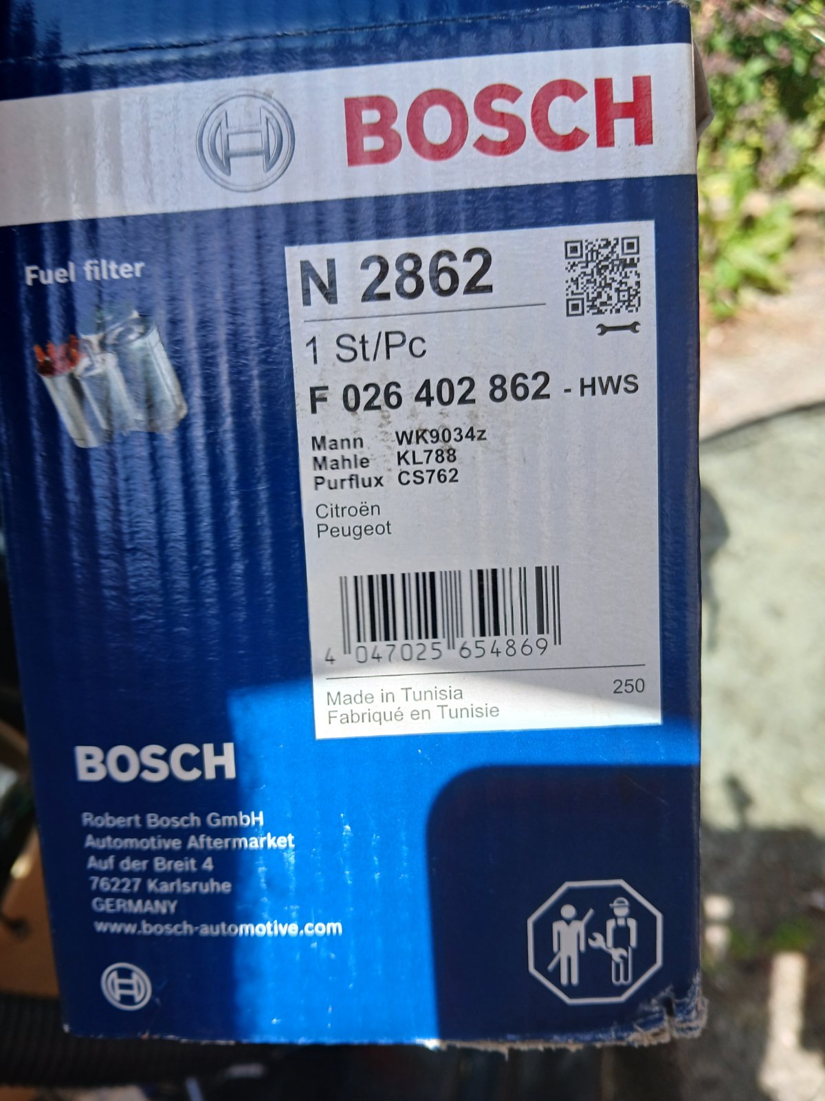

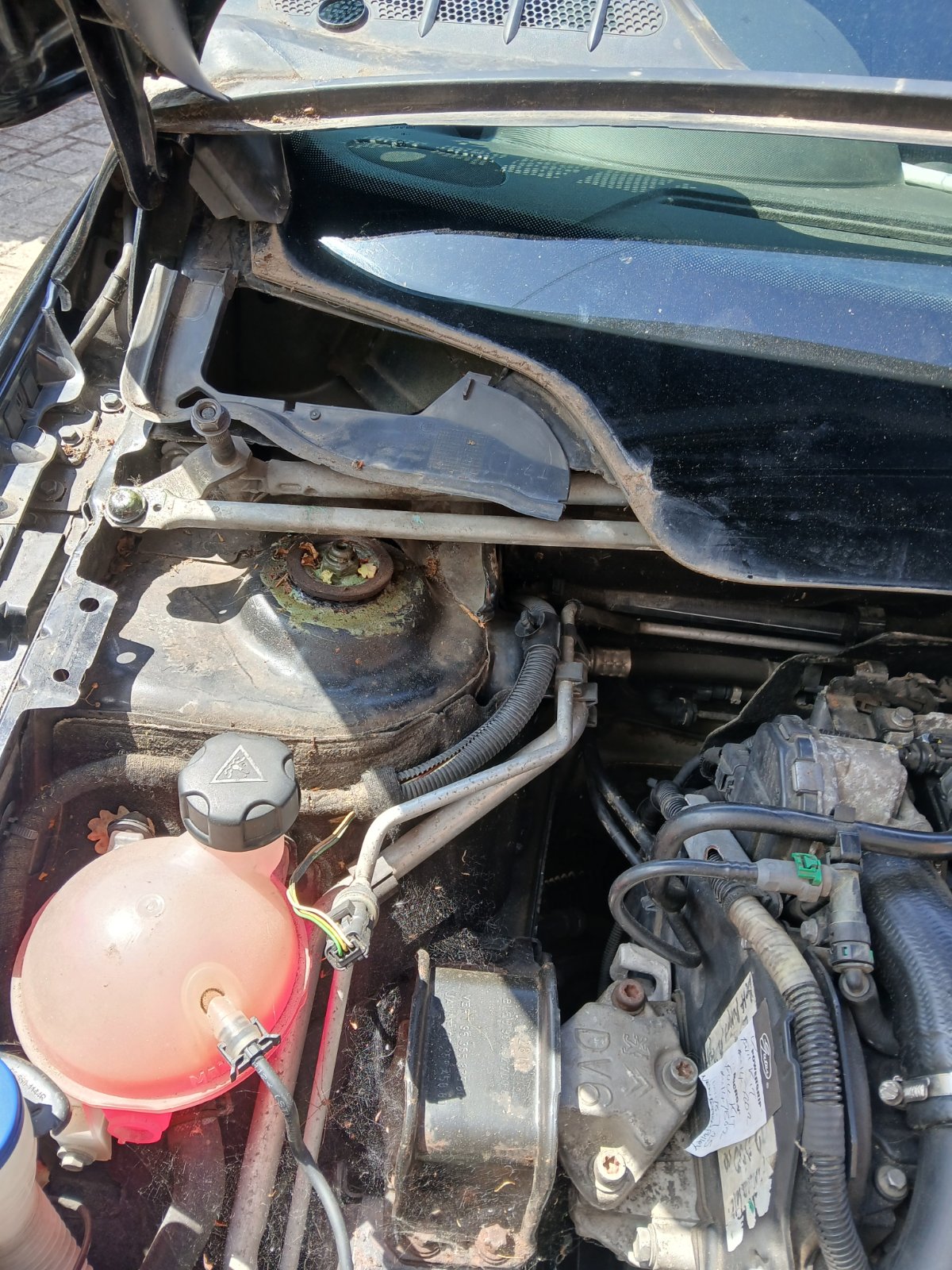

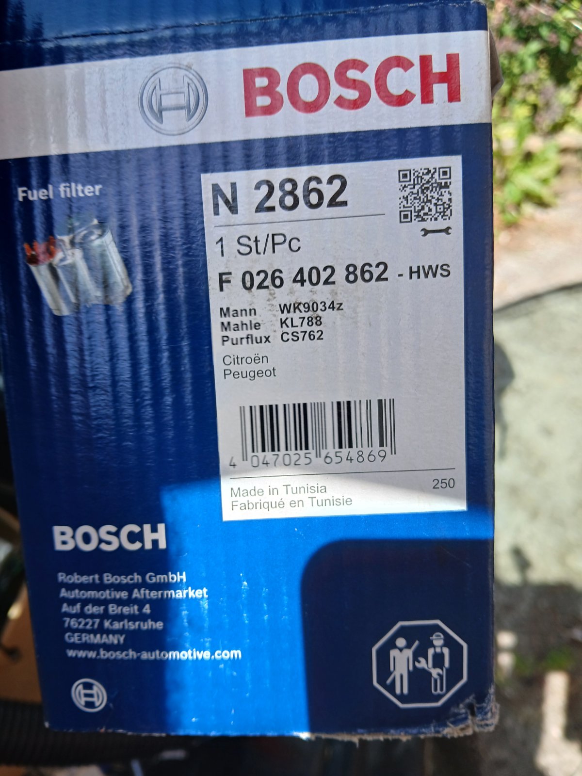

Top photo i like to remove all the wiper panel scuttle to have plenty of room to work on the filter housing area bottom photo filter type used
:-D
