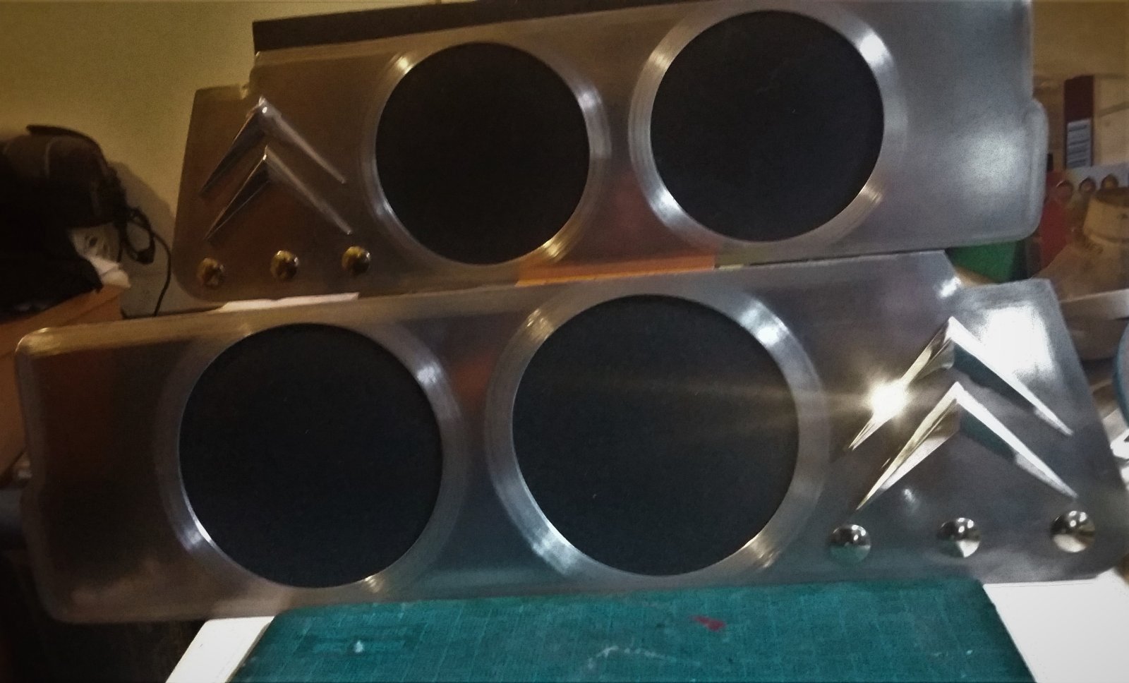

Hi Chps
A small update on the headlamp project
Front plate s finished and design set, the brass pins will be replaced by a set of LED Drl's sealed behind the plate and showing via holes.

Posh! ^
Be nice to see that completed.

They do look nice and retro for sure - will they affect the beam patterns in any way though - especially the reflective material that is usually at the back of the headlamp clusters?

GiveMeABreak wrote: 29 Jul 2018, 16:08 They do look nice and retro for sure - will they affect the beam patterns in any way though - especially the reflective material that is usually at the back of the headlamp clusters?
All the "internals" are being replaced with Hella units and the glass front modified to be clear and not a lens as originally.
The primary aim is to keep the whole headlamp "silver" as per now and not like the Morrette ones that have a painted shroud. I hope that from a medium distance the car will retain the original look.

Alasdair. now that looks superb. well done 8-) 8-) .

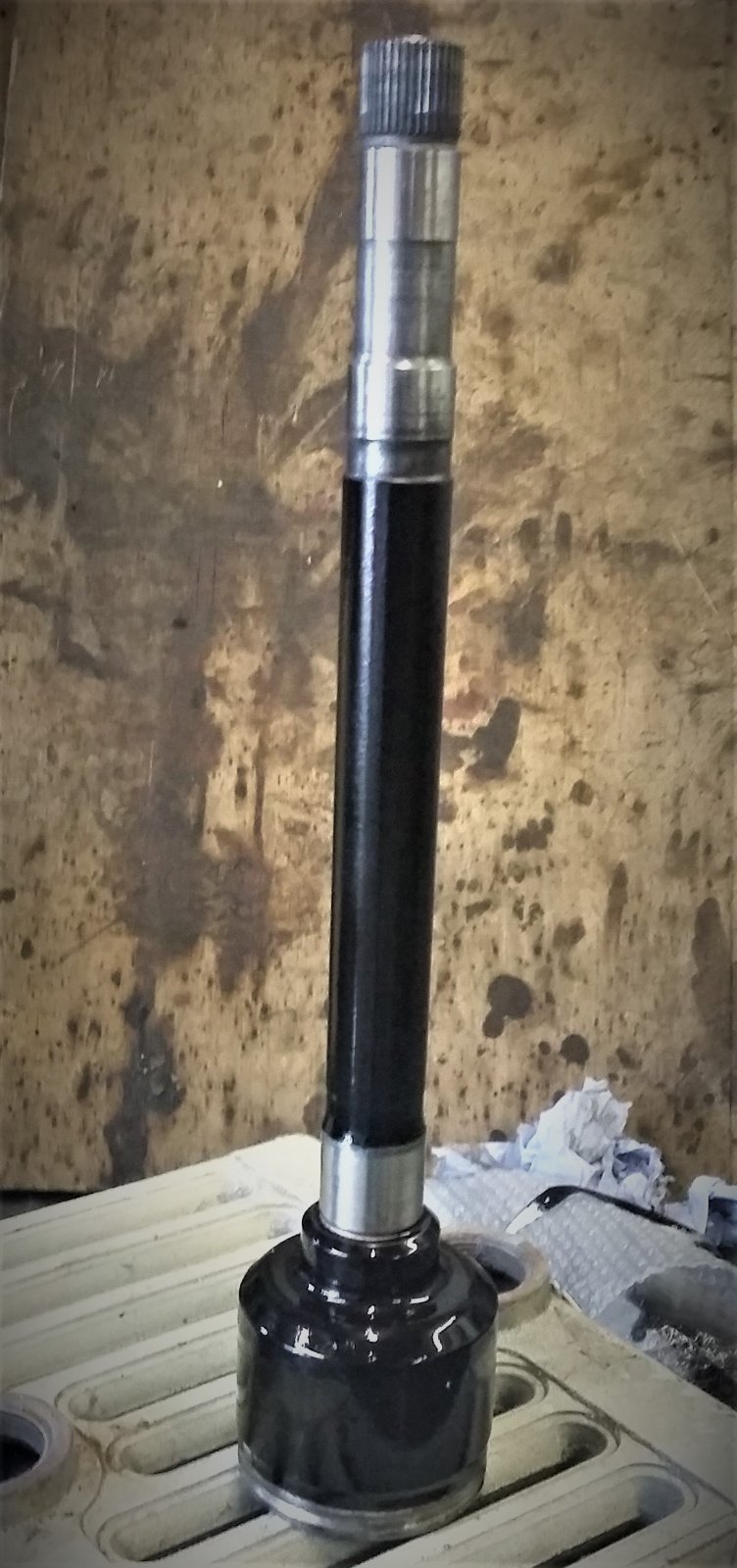

Rebuild of the drive shafts (OEM) starts
Posts: 11853
Joined: 28 Mar 2013, 21:05
x 2007
Re: I am an Sado-Activaist with a V6 and now I am a Volcanist and suffer AX-isum as well
Unread post by Stickyfinger »
Clean up on the other end all done, all washed out and smooth running.
Just to note
The magnets I placed to keep the caps on are NOT needed, a Xantia drive shaft (oem) CAN be pulled apart without destroying the needle bearings in the cup. You can see the retaining cage for the bearing needles
