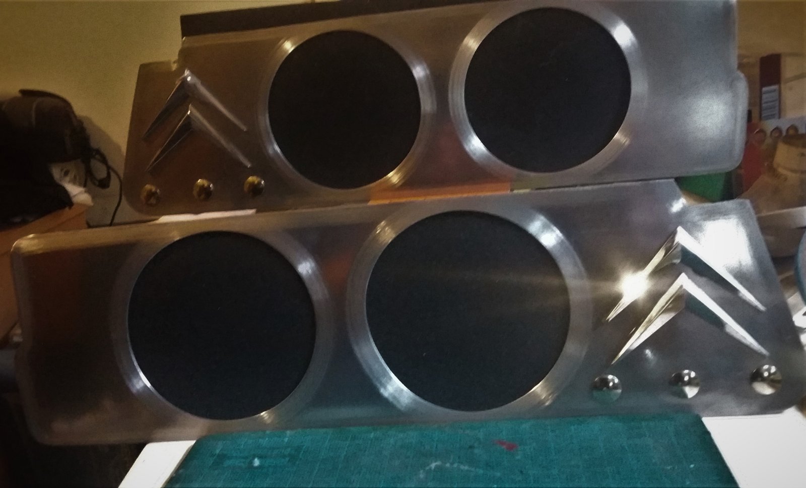

A small update on the headlamp project
Front plate s finished and design set, the brass pins will be replaced by a set of LED Drl's sealed behind the plate and showing via holes.

Posh! ^
Be nice to see that completed.

They do look nice and retro for sure - will they affect the beam patterns in any way though - especially the reflective material that is usually at the back of the headlamp clusters?

GiveMeABreak wrote: 29 Jul 2018, 16:08 They do look nice and retro for sure - will they affect the beam patterns in any way though - especially the reflective material that is usually at the back of the headlamp clusters?
All the "internals" are being replaced with Hella units and the glass front modified to be clear and not a lens as originally.
The primary aim is to keep the whole headlamp "silver" as per now and not like the Morrette ones that have a painted shroud. I hope that from a medium distance the car will retain the original look.

Alasdair. now that looks superb. well done

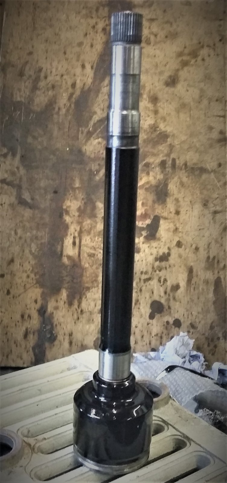

Finally removed the shaft with the bearing, what a dreadful job on the V6 (when on your back)
Next challenge, how to get the collar and bearing off..........thinking hat on.
- Posts: 11836
- Joined: 28 Mar 2013, 21:05
- x 2005
Re: I am an Sado-Activaist with a V6 and now I am a Volcanist and suffer AX-isum as well
I cut the outer race with a mini disk (Dremmel) and cracked that off in two parts....
The cage was all twisted up and a hell of a mess in there, balls all a mess, metallic paste inside.
With the outer shell off I I mounted the shaft vertically (splines facing down onto wood/bench) in the big vice.
I then heated just the collar with dual blow touches..........and BEAT THE BASTARD for 10 mins.
It fell off.
Citroen, simple, delicate and in need of a soft touch.......huhhg ?
It fell off.

Rebuild of the drive shafts (OEM) starts
