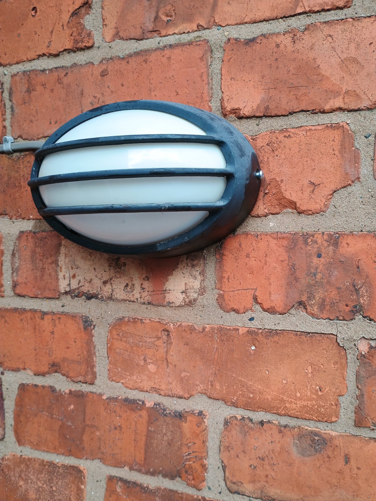

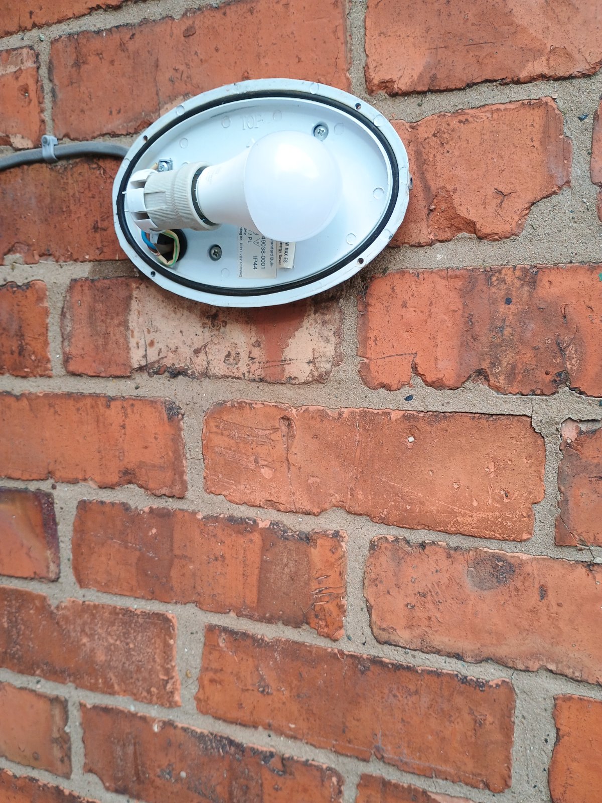

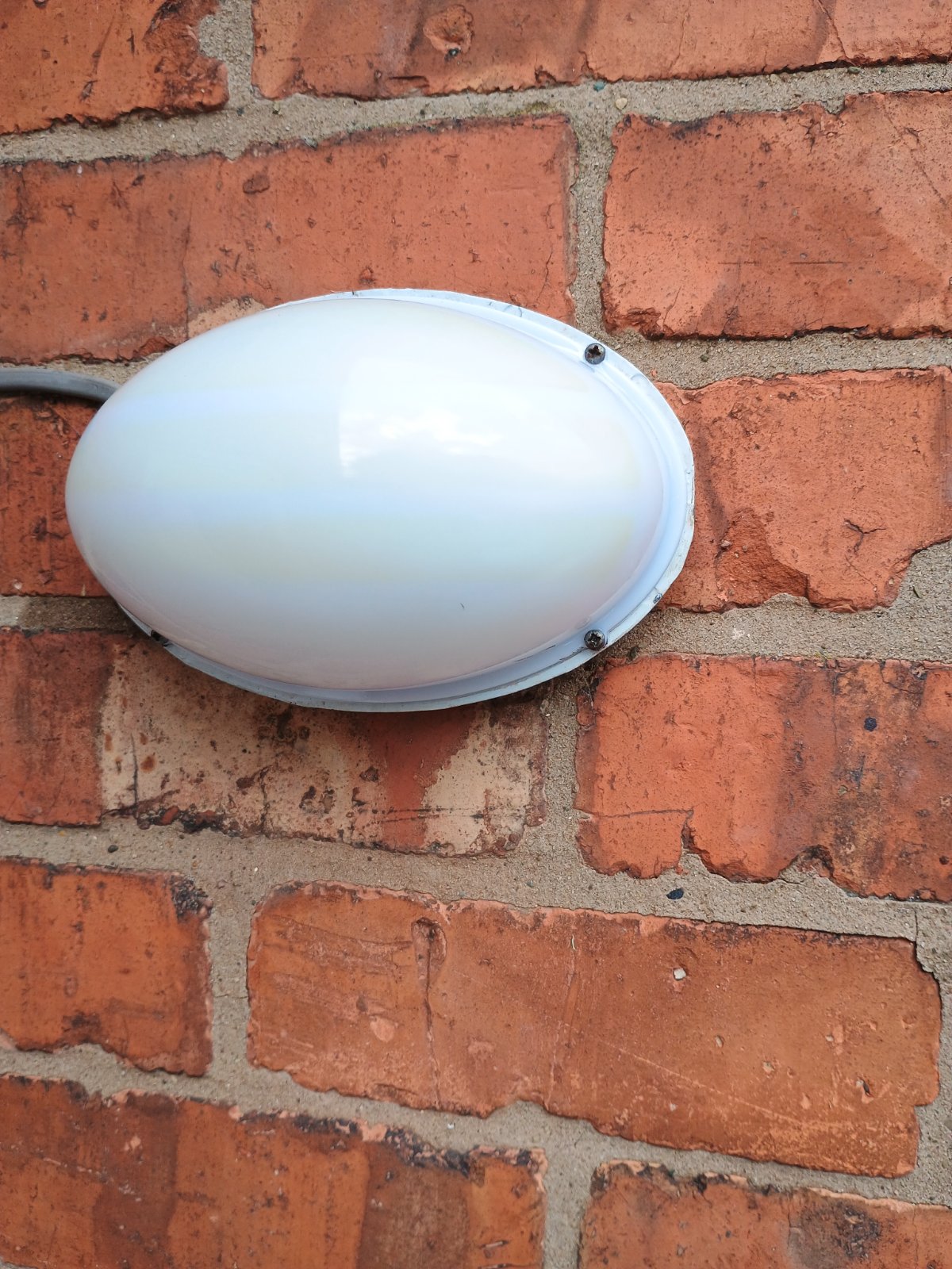

LED bulb (replacing CFL energy bulb)
Finished diffuser
Finished diffuser
Reassembled light
Reassembled light
Done
Posts: 21300
x 8146
Looks great Matt! Now I realise where the stripes came from! :-D

mickthemaverick wrote: 04 May 2025, 17:12 Looks great Matt, Now I realise where the stripes came from! :-D
Yes, when I bought these - at least a decade ago - there was an "unarmoured" version, missing those three horizontal bars. I guess I saved myself a tiny amount of polishing there!

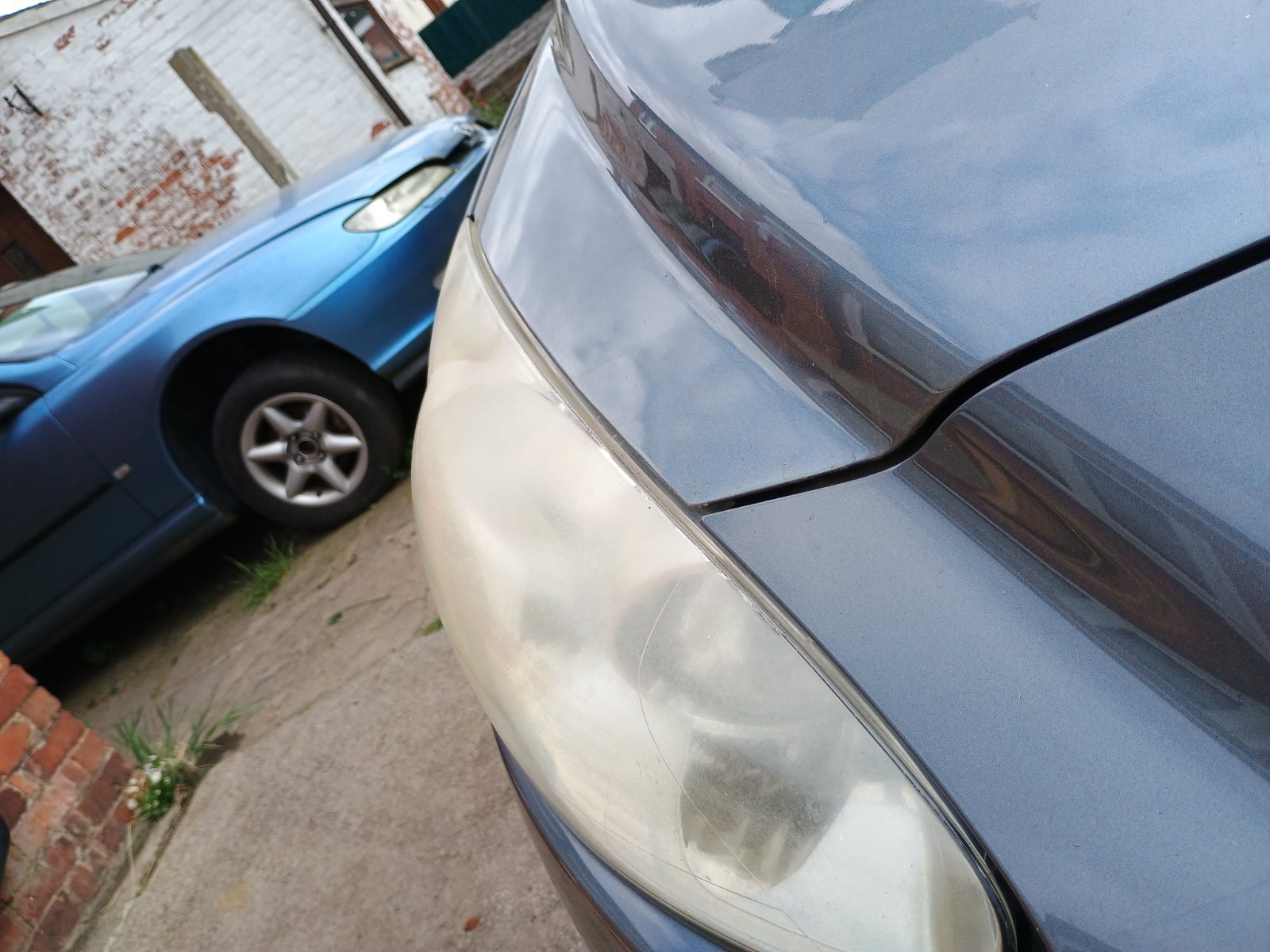

Working up the confidence to tackle the headlights, maybe tomorrow...

Room for improvement, definitely!
Posts: 21300
x 8146
They will come up great, I did mine with 400, 600, 800, 2k and 3k for the best finish!! :-D

mickthemaverick wrote: 04 May 2025, 17:47 They will come up great, I did mine with 400, 600, 800, 2k and 3k for the best finish!! :-D
Ah good to know. I've got (40, 60, 80, 120, 240) 400, 800 - I think, 1200 and possibly some 2000 grit if memory serves. Bracketed variants included to complete the list rather headlamp attacking options, hopefully obviously! :-D

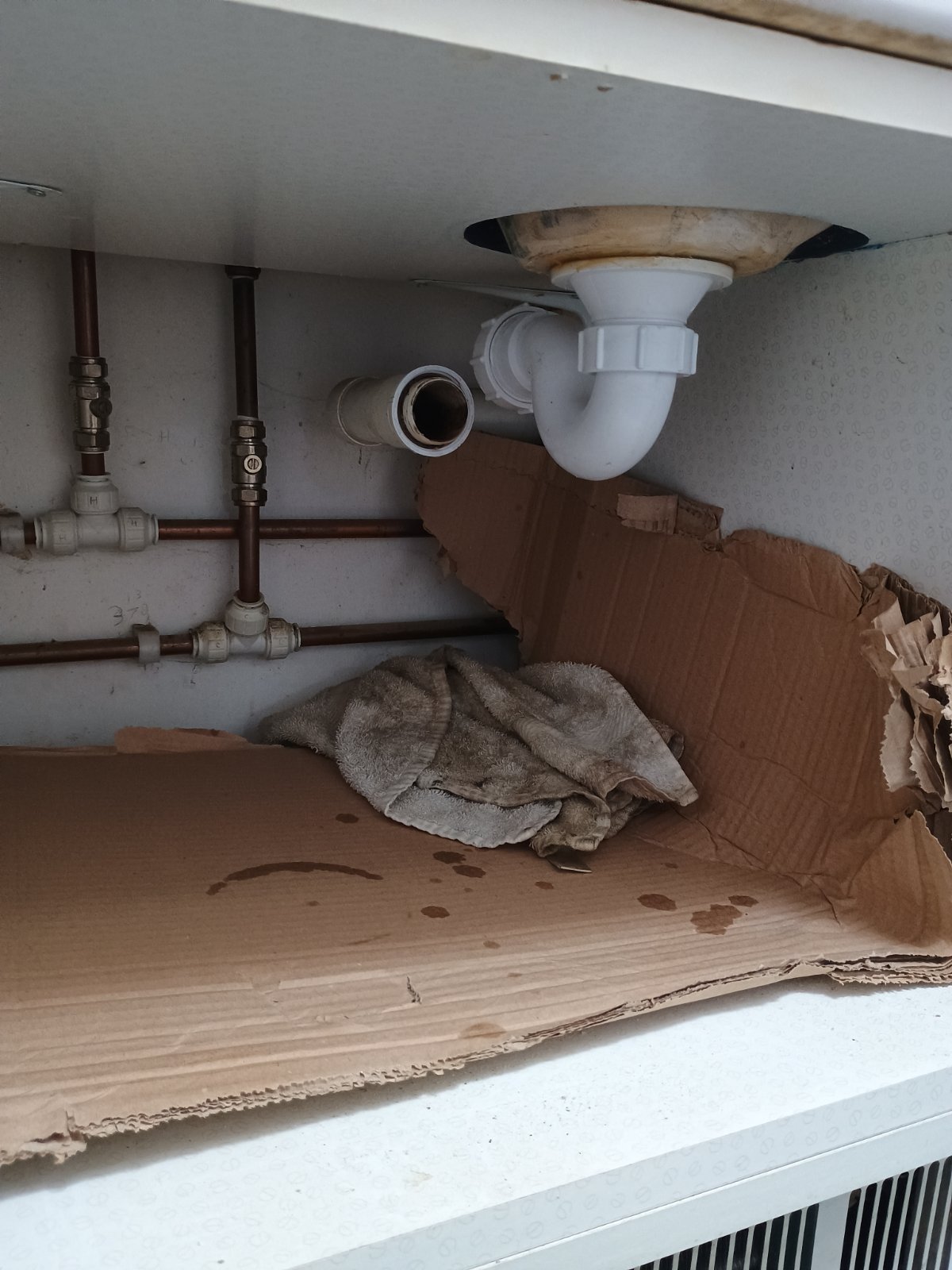

Kitchen sink does not drain well.
Current low profile trap thought to be the culprit. A big depth of seal isn't needed (why will become apparent shortly)
Current trap
Current trap

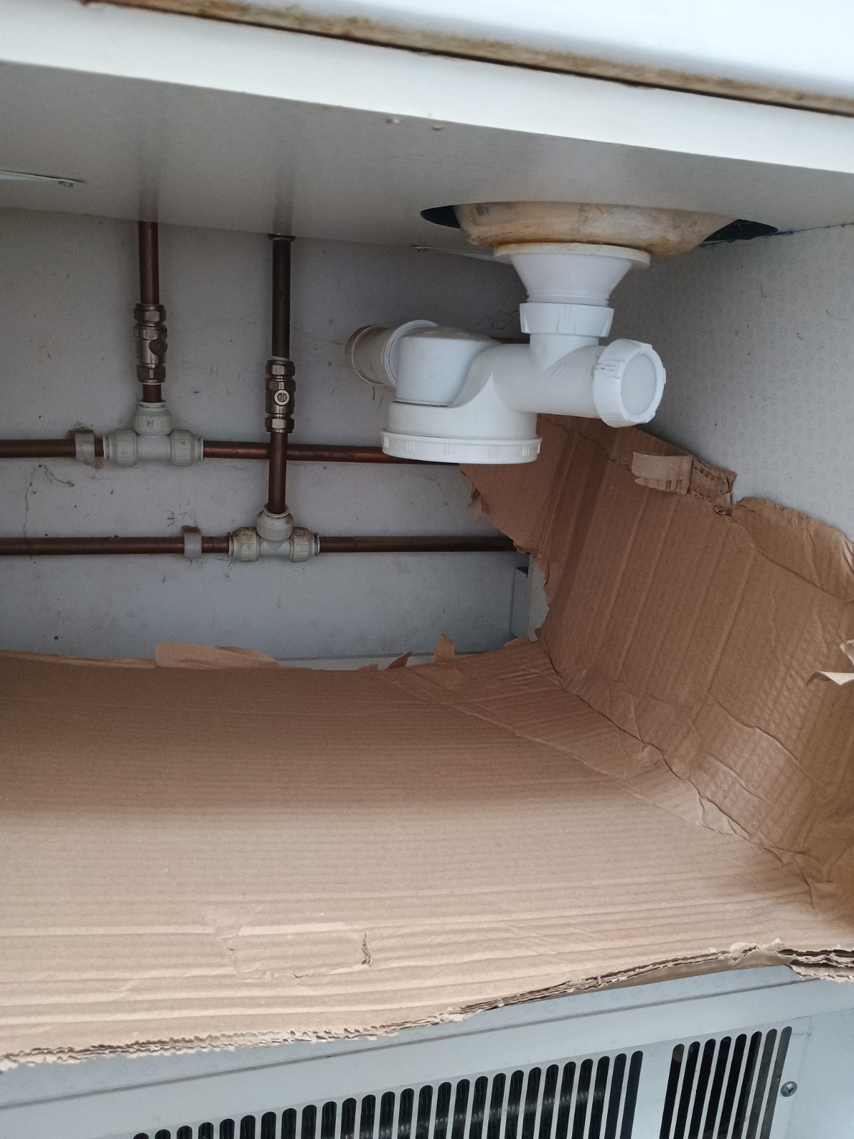

This trap was selected to give a meaningful drawer capacity.
Now swapping to a shallow bath trap. First test
Shallow bath trap
Shallow bath trap

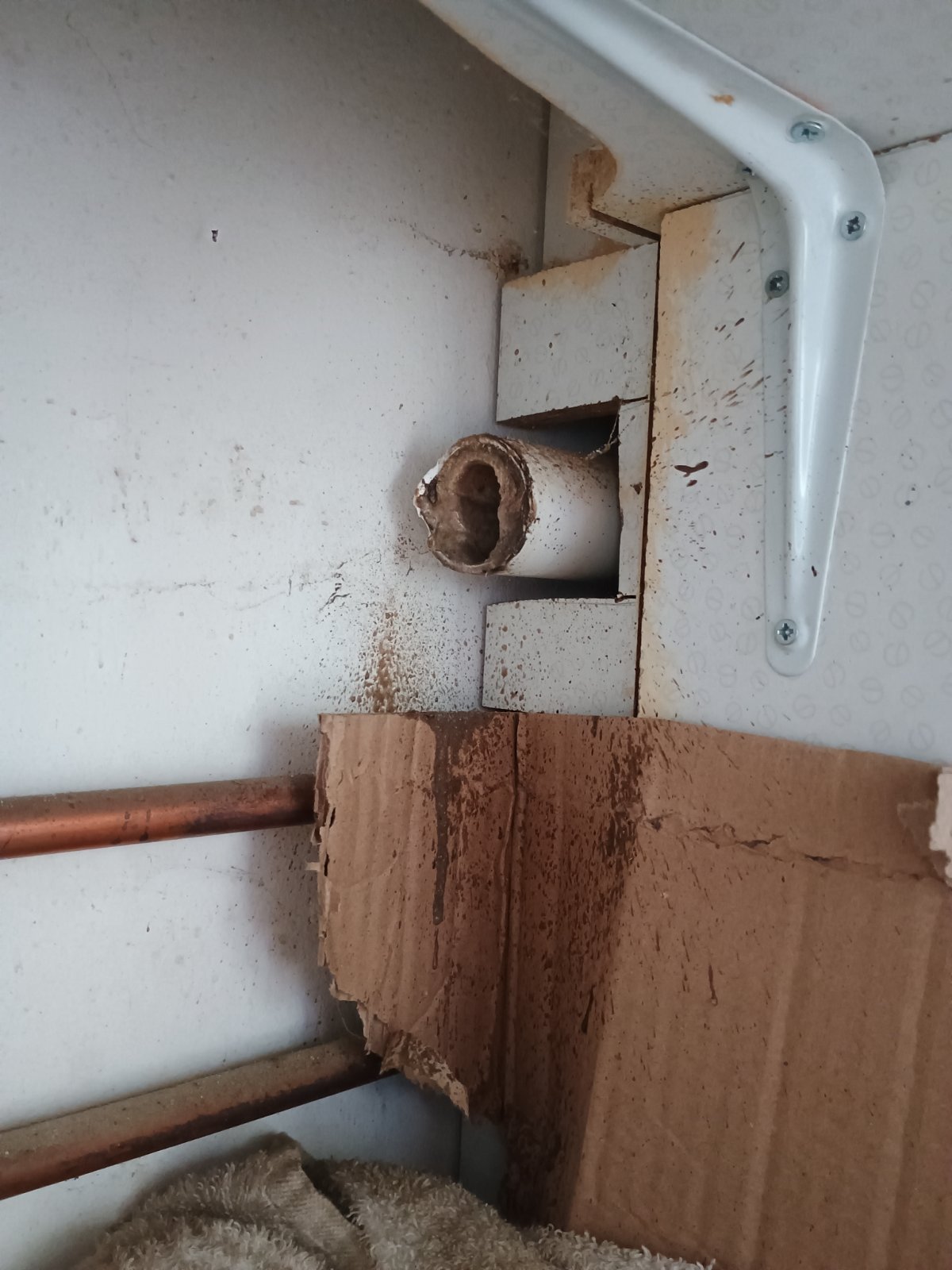

Became obviously the trap isn't fully responsible
Spoiler: show
yuk!
Pipe hacked back
Pipe hacked back
Yuk hidden given lunchtime posting.
Fair to say image really does not convey the aroma!

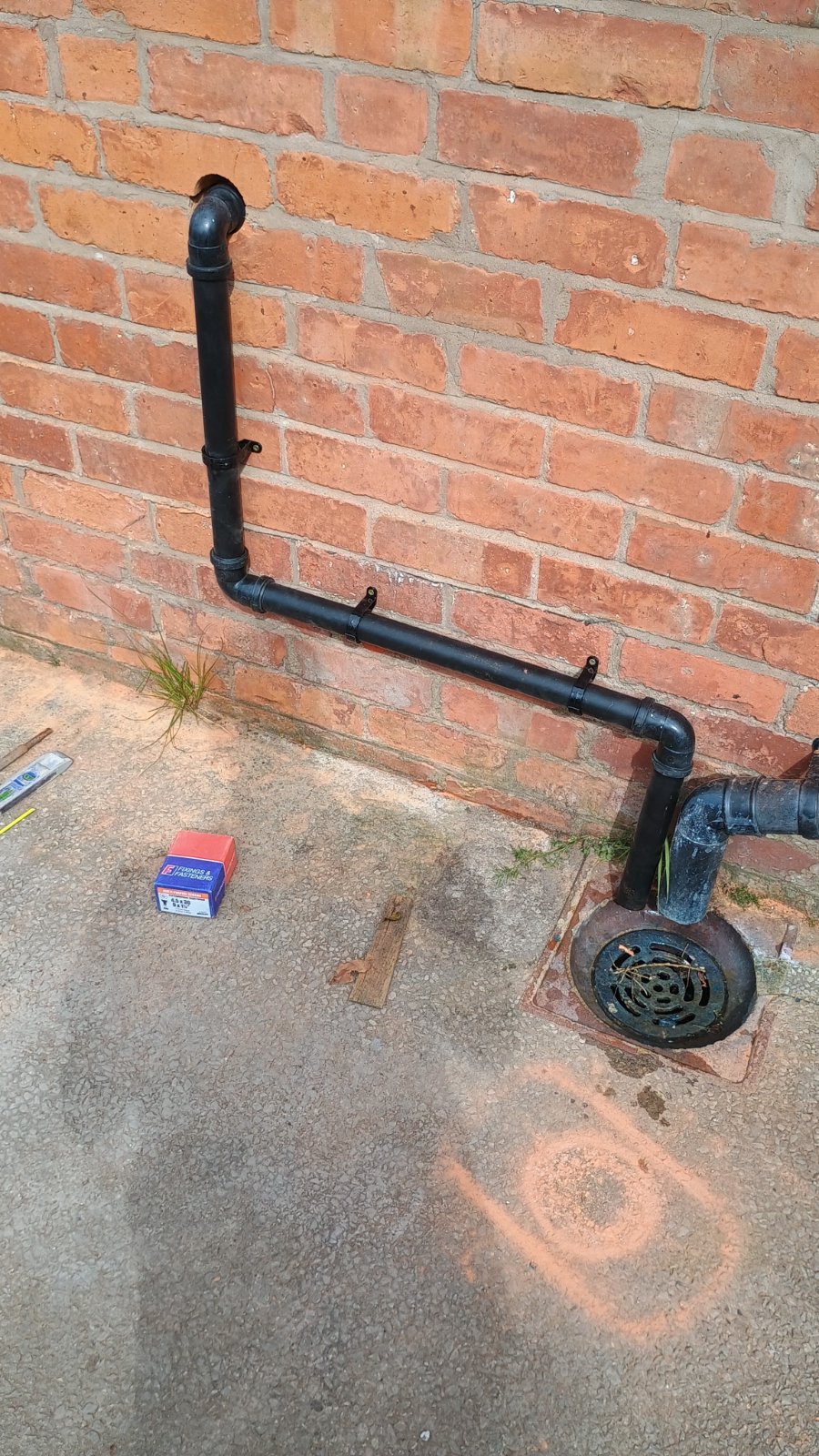

Still cementing around the pipe to do, but otherwise here is the finished job:
Down a bit, across a bit, then down some more = angled towards the grid
Happy with that, no leaks. Drains a bit faster :)

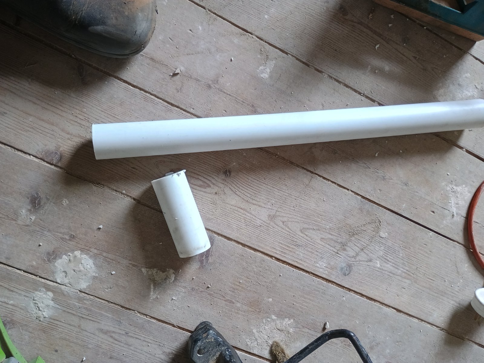

Oh, and moment of (slight) euphoria from earlier:
This length of white pipe, I used for the bit passing through the wall. White matches the trap so when laid on the kitchen floor for whatever reason it is pleasing to the eye....
Anyway, it's been "saved for future use" in the garage for at least a decade. This little offcut is the waste from today's use. Ahhh, so it was worth saving it all that time !!! :-D
