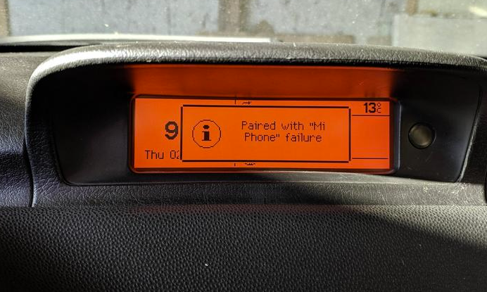

Re: RD45 questions + Microphone installation C5 X7 + Amplifier installation
Is it possible to update MFD sw to be comaptiable with RD45,because i cant connect with phone bluetooth?It is JCE EMF- C- CEM1 with SW v51.6 and HW v1503?Tnx in advance.

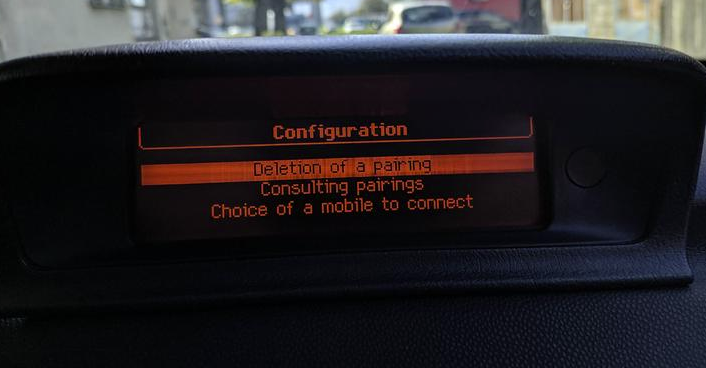

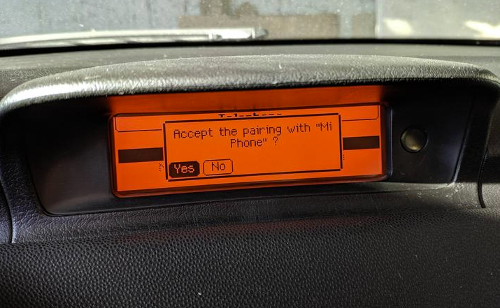

Tnx for answer,thats what i thought..But is there anyway to pair phone with radio somehow on blind,my english is not best so i cant explaine but i saw on youtube video when radio is found with phones bluetooth there are numbers on screen(on my screen there is just confirmation after that nothing).I have tried on blind type on phone 0000-pair-confirm yes on radio screen-ok ok ok ok-arrow down and left..But i didnt succided..xantia_v6 wrote: 21 Oct 2019, 07:40 I don't think that there is any way for update the software on the EMF-C, you need to find one from a later car with a compatible software version.

I have diagbox and enabled bluetooth kit,it showing telephone options but as you said they are not correct..
- x 6945
Can you post your VIN and attach a couple of screenshots of the screen so I can see which options you have selected and then I can compare these to make sure you have the correct options selected.
