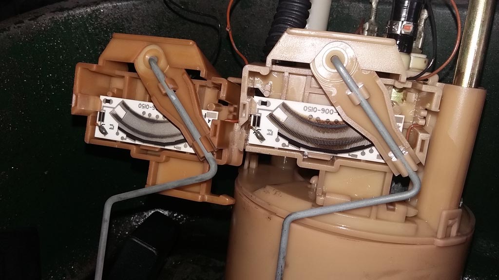

Got sick and tired of false Empty warnings and levels from the fuel tank......so swapped the sender over for a cleaned one taken from the pump on the scrapper car.
You can see the build up of crud you can get

And that's in a petrol car.. In a diesel it is far worse... Veg is even worser...

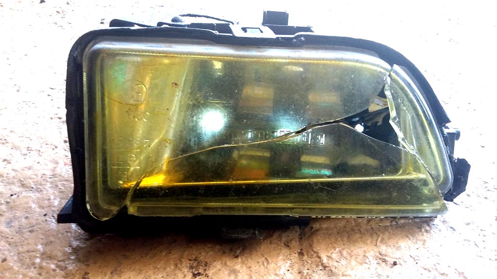

It never rain but pours...out on the test drive to check the fuel tank sender was working and this happens. Stones + truck = guess
Replaced....bugger
Replaced....bugger
