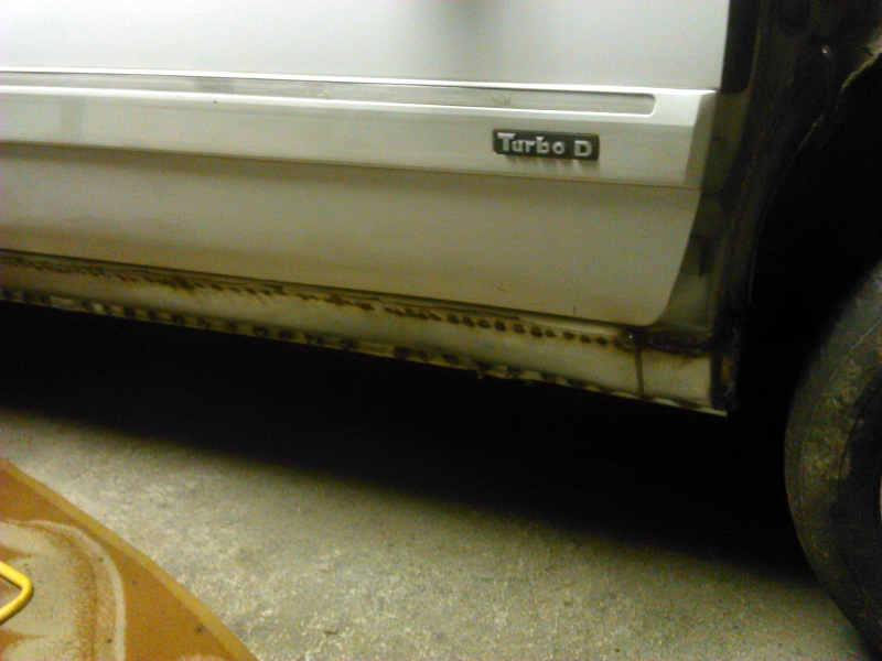

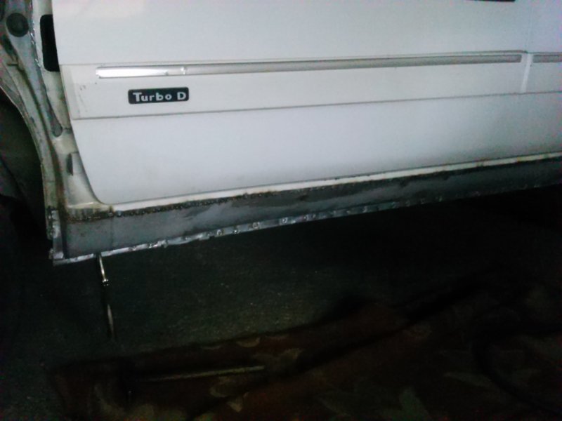

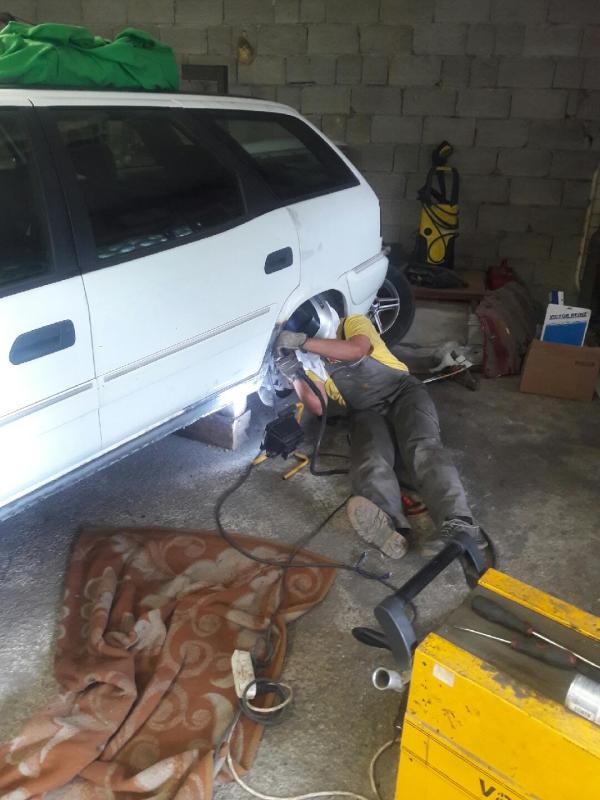

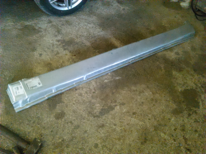

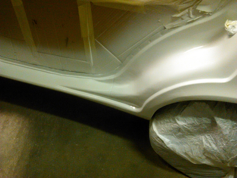

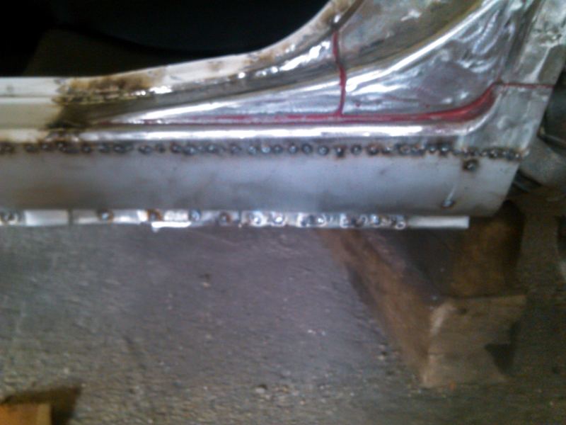

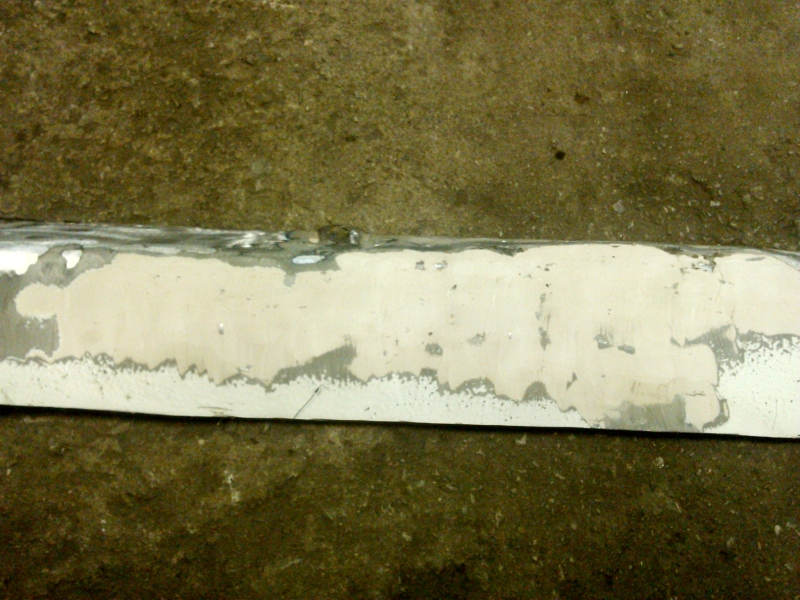

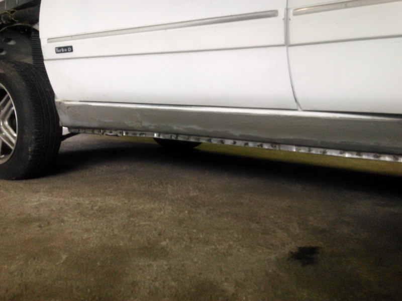

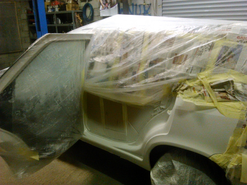

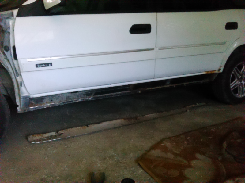

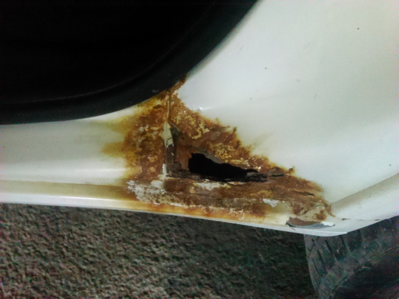

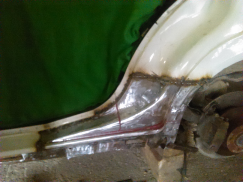

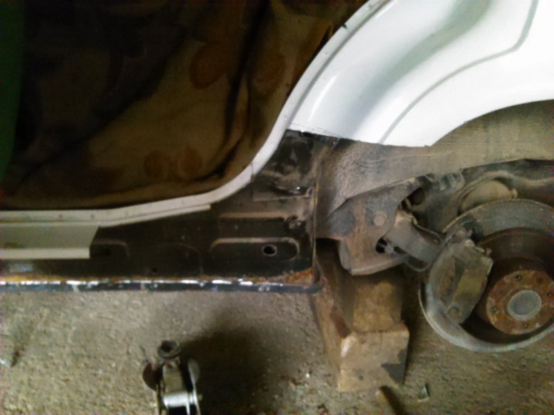

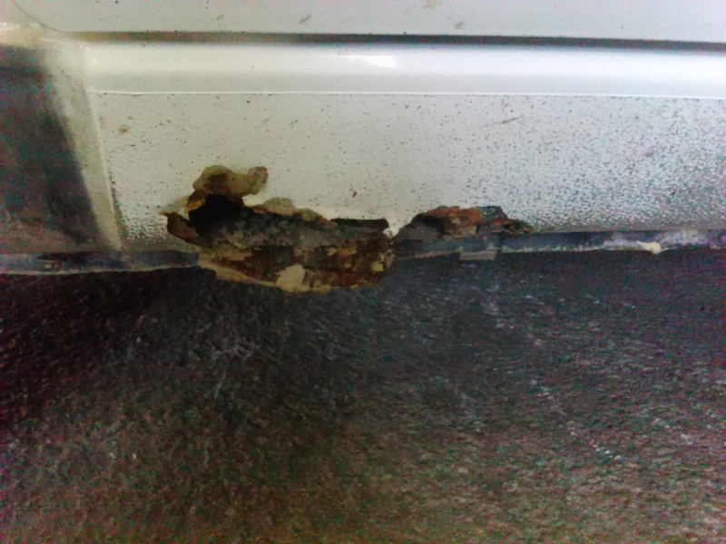

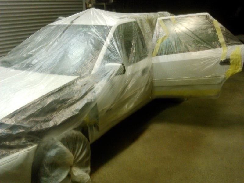

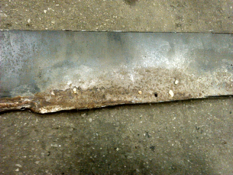

Well haven't been around for a while but done some work in the mean time...
Pictures say a thousand and ninety three words...
I didn't do anything like this before before you start criticizing take this into account. Class A DIY

Good work indeed and very useful pictures of how to do a great job of repairing what is now a common rust issue on the Xantia. Well done!

That looks like a top class repair. Both xantias I have owned needed remedial work there, although none were so bad as that. I believe that nearly every xantia which hasnt yet been repaired in that area will need soon. The current one did not look bad, just a little bubbling, but the MOT man put his thumb straight through it, which then fails the MOT as it is too close to a seatbelt mounting.

Quite a few others, it is all down to end plugs and seam sealer
