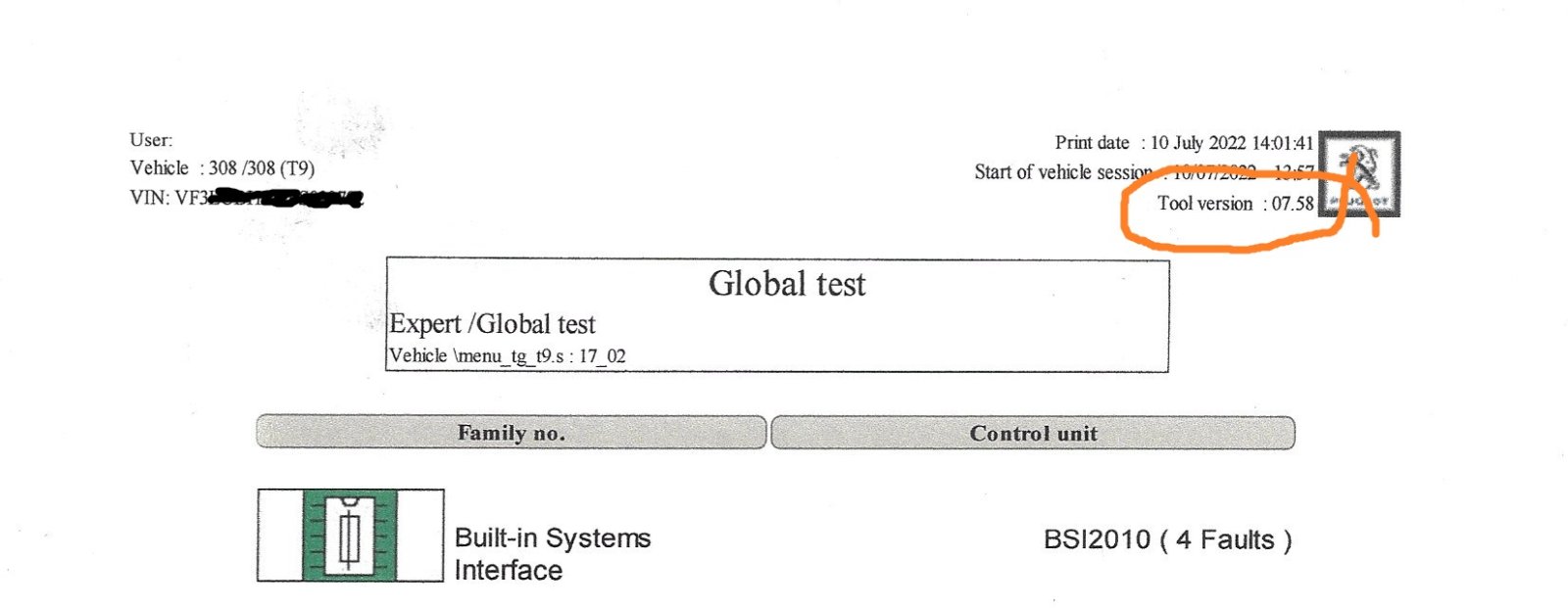

- Posts: 9457
- x 1946
Re: C5 Lexia help!
When you're using Diagbox the version is displayed towards the top right of the page. If you've taken any screenshots when using Diagbox that might show the version.

- Posts: 9457
- x 1946
Re: C5 Lexia help!
If you have any test results printed out or saved as a PDF or JPG (or any image format) then the version is printed at the top.

- Posts: 9457
- x 1946
Re: C5 Lexia help!
Unfortunately my Diagbox is on a different laptop which I can't access at the moment so can't screenshot what the operating screen is like. Maybe someone else can oblige?
Having said that, for my 2013 X7 version 7.57 was sufficient.
How sure are you about the hardware side of your Diagbox? Is it full chip for instance?
