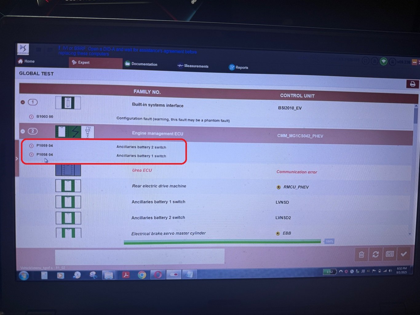

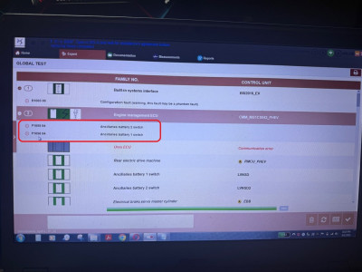

My DS7 Crossback has a problem and stop on road..
After i reinit phev with diagbox, car starts normally in termic engine - but not switch in electric drive, and I get the error message (electric traction system fault), first in orange and then in red.
Ecu errors:
-ancilliares battery 2 switch
- ancilliares battery 1 switch
I removed the small battery from the trunk and had it tested, but the values are ok.
Does anyone have any other suggestions and experience with this issue?
Would it make sense to replace the small battery even if the values seem good?
I did not find any diagram for this car: VIN is attached
How can I reset the breaker fuse or how can I realise if it doesn't reactivate?
I cannot find the switch for ancilliary battery 1 and 2.
errors attached -
thank you in advance
Ecu errors:
errors attached -
