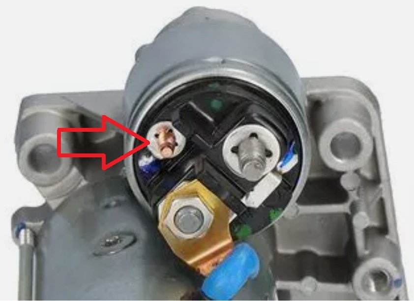

Hi Steve. By "small terminal" on the starter do you mean this one that the red arrow points to?Steve Walsh wrote: 30 Jan 2025, 07:26 I would still try a 12v to small terminal on starter, If it turns over it works and your problem is elswhere

Re: Missing fuse module nut, what size is it?
That's the one, that energises the solenoid / starter. The one with blue on becomes live when the small one receives 12v. the one on the right is 12v from battery
I appreciate your support Steve, I now just want to be absolutely sure I get the right post becasue the image I shared above doesn't look like the same starter motor as I have.
I think it's the one with a yellow box around it, am I right? I've taken the photo from underneath in case it's not clear.
It is the smaller one, It is a 5mm thread with a nut/spanner size 8mm
The large top one is battery power / heavy duty. The lower large one is from solenoid into starter. You need a 12v feed into the small one, if the starter turns the engine that starter is OK.
P**s! I just tried it using the exposed terminal/post and got nothing - and now I know why.
In this photo I can see that it appears to have the main cable connected to that post, so tomorrow I'll try it in the proper place (yellow box).
I do hate being thick.
Use the small one above it
The small one as in this picturerocco wrote: 30 Jan 2025, 19:36Hi Steve. By "small terminal" on the starter do you mean this one that the red arrow points to?Steve Walsh wrote: 30 Jan 2025, 07:26 I would still try a 12v to small terminal on starter, If it turns over it works and your problem is elswhere
OK, thanks I will try but I don't think I'll get any purchase on it with jump leads. What is the cable that is already connected to it? Where does it lead?
