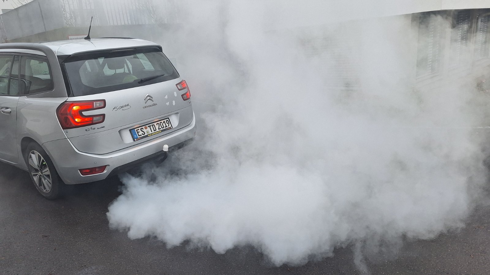

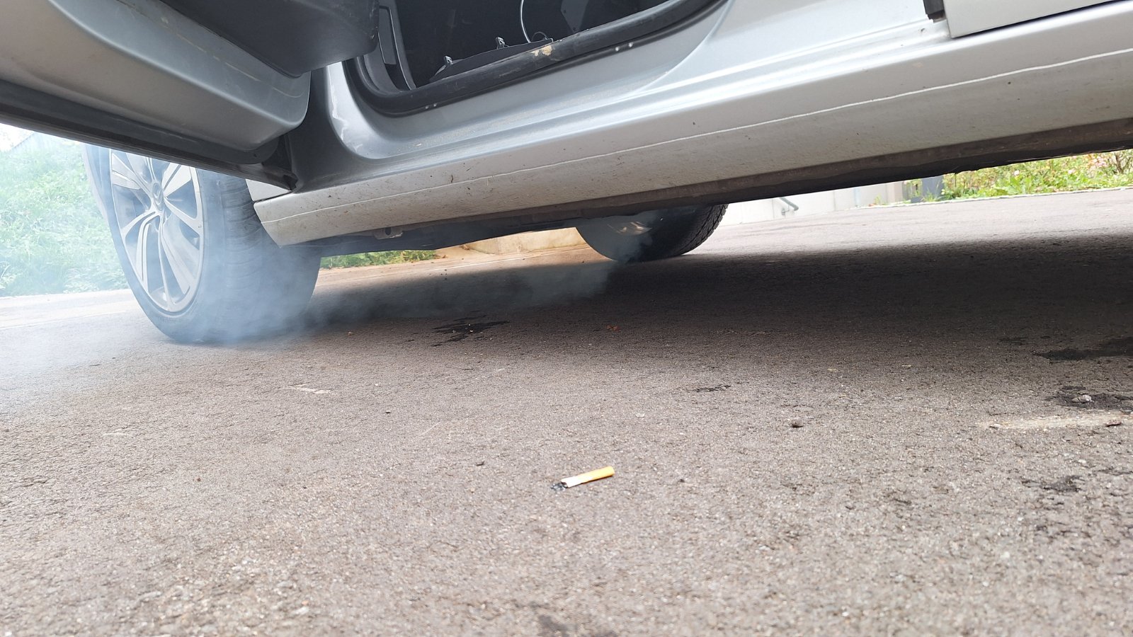

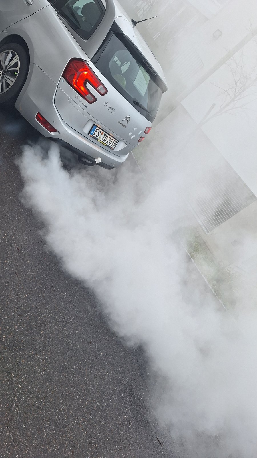

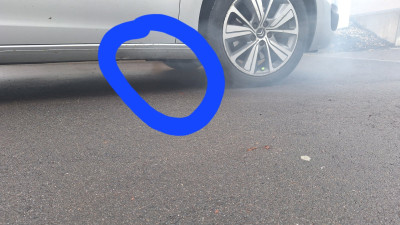

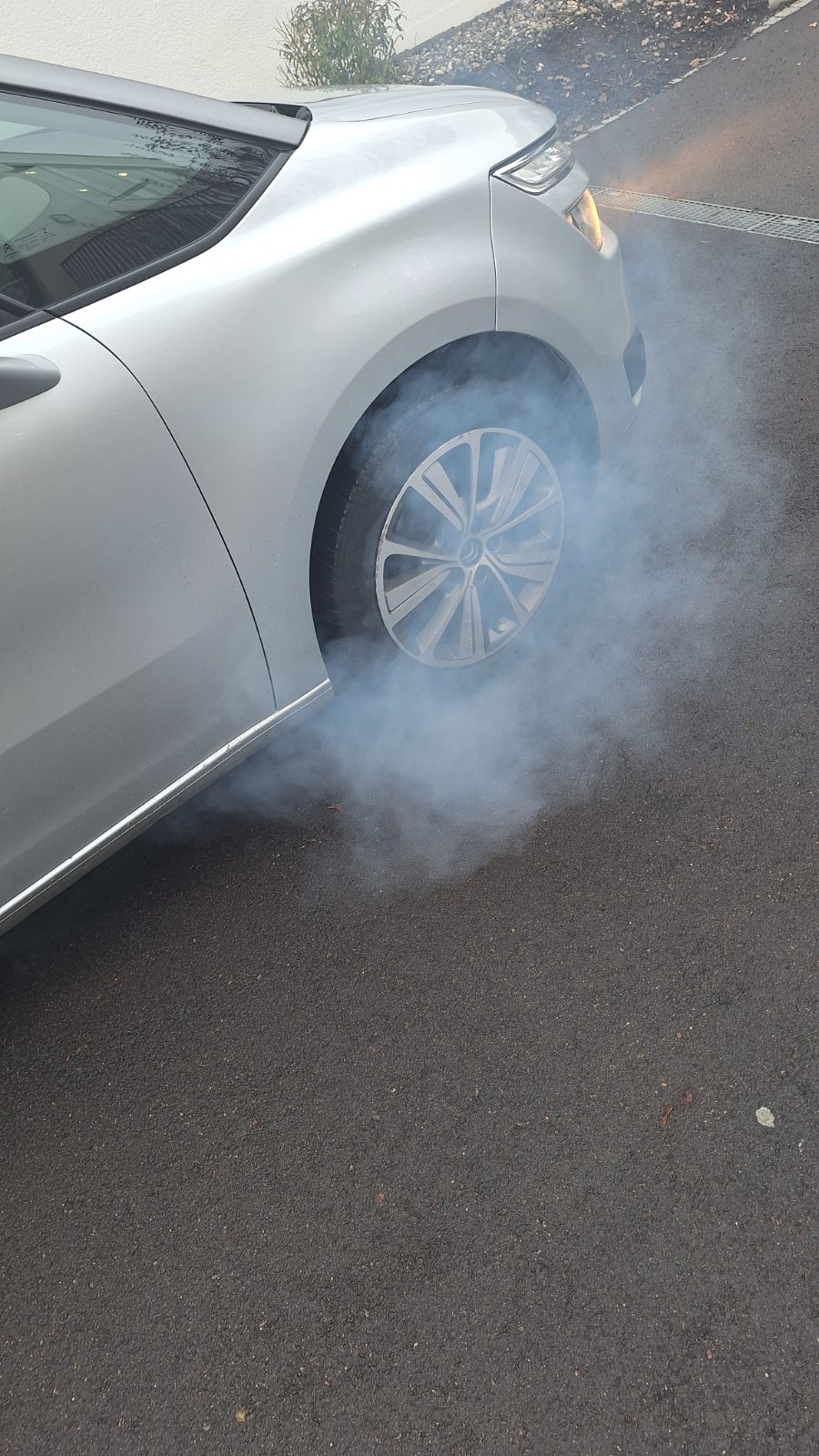

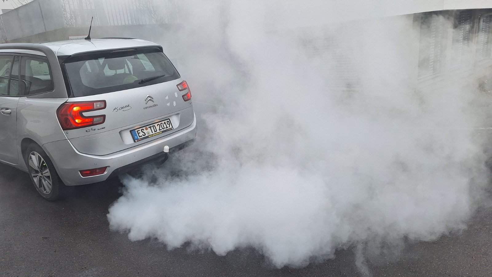

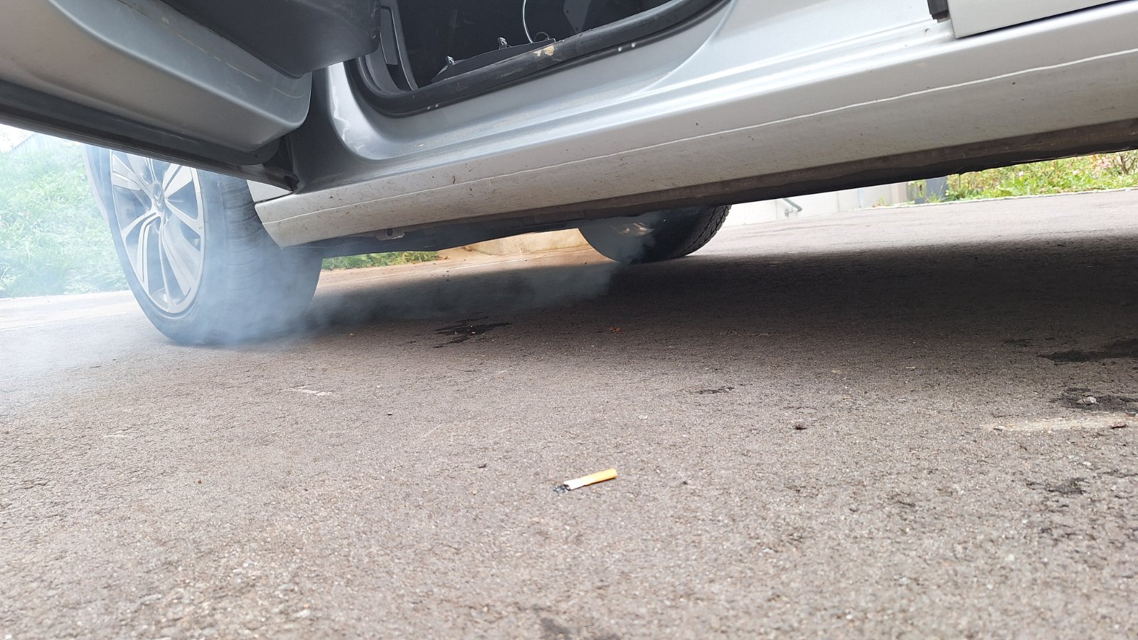

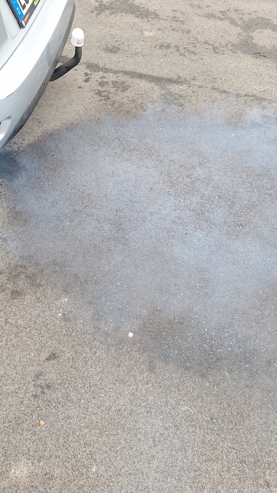

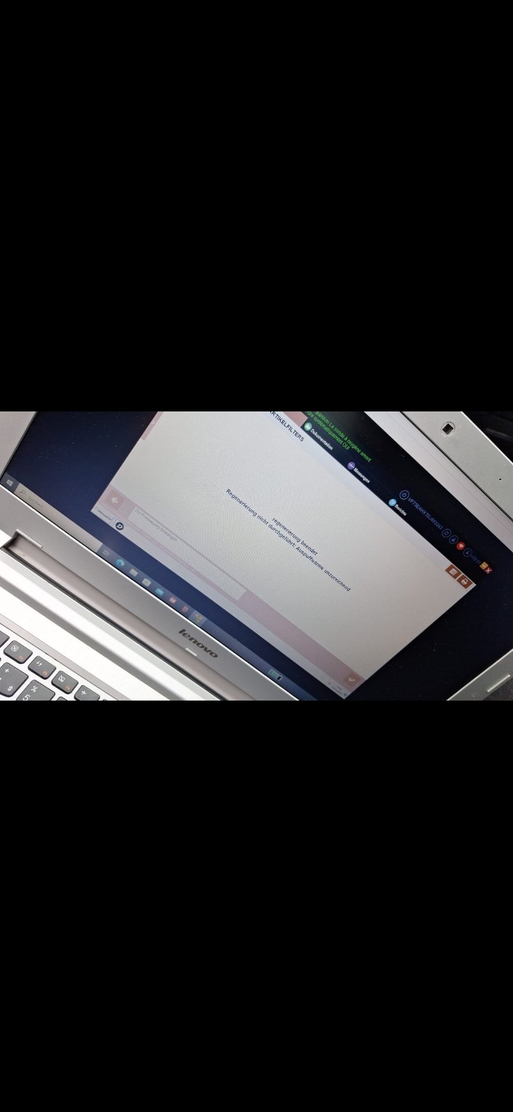

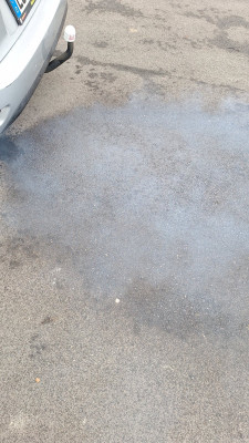

Today I did a regeneration. Was done with Diagbox. Unfortunately, success anyway. In the end Diagbox said exhaust heat not reached. There was a brief burst of blue smoke for a few minutes that smelled like it had been burnt. is this particle filter completely defective?

So DPF is completely clean. But after installation diagbox brings again error exhaust heat not reached. Where do I have to look further?
