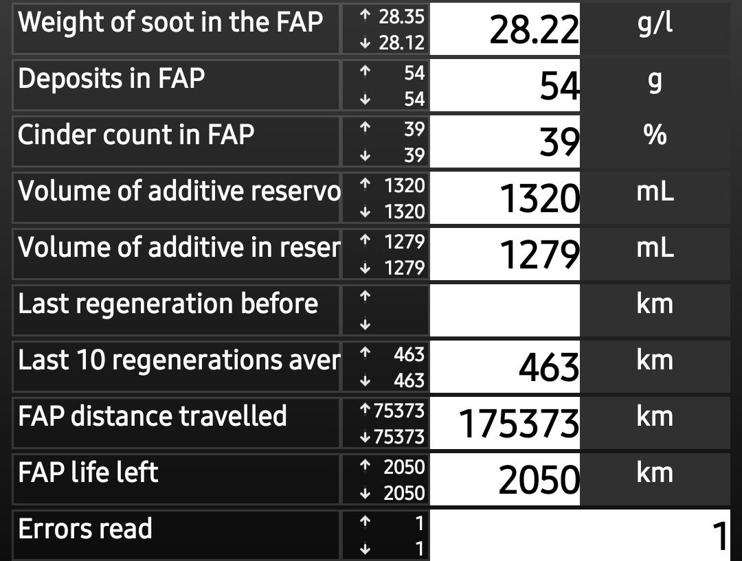

So after driving on the highway I got the top value down from 33 to 28. The check engine light does not come on. After the trip I deleted the errors and they no longer appear. But it doesn't show any regeneration either. Should I initiate one with Diagbox?
I took the screenshot before deleting the error.

Re: P2463 P246C
The values of the soot in the FAP will go up and down - ignore these as they will fall after regeneration and rise again during normal travelling.
It's saying the vehicle has done 175k KMs on this particle filter so is at end of service life. It's therefore telling you that it has 2k KMs left. It is 39% full of cinders (ash from the soot after regeneration that cannot be burned off, along with engine deposits and Cerine that clog the filter and ultimately require deep cleaning or replacing). So it is almost half blocked according to this with stuff that cannot be burned off during regeneration.
This means the filter is going to try and regenerate more often as the filter is at just under half it's original capacity. So at some point it will need coming off and cleaning or replacing, otherwise these messages will keep reappearing and at some point will cause the engine to go into limp mode.
