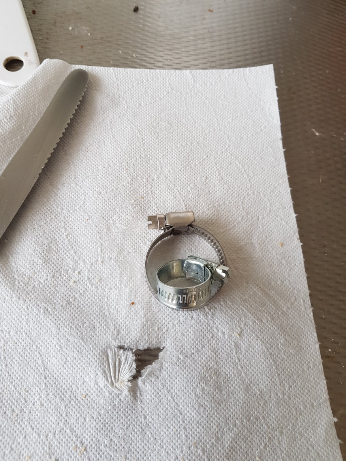

So now I have a question as someone complained that a previous owner had replaced the factory pipe clamps with jubilee clips - now I don't have the special tool that is used on the original clamps and only have access to the correct size jubilee clips.
Am I going to be OK doing this?

It's no problem to use this ones.

I have those

Nasty things that are only fit for use on a garden hose !

Yes, but if you have no choice!!
I assume that the factory crimps cannot be reused?
Or can they?
Or can they?

They can, but you have to buy a special pliers a 50 Euro.
But there's nothing wrong to use the one on the picture.

50 euros!!!! I'm not made of money - I drive a Citroen....oh, wait....
