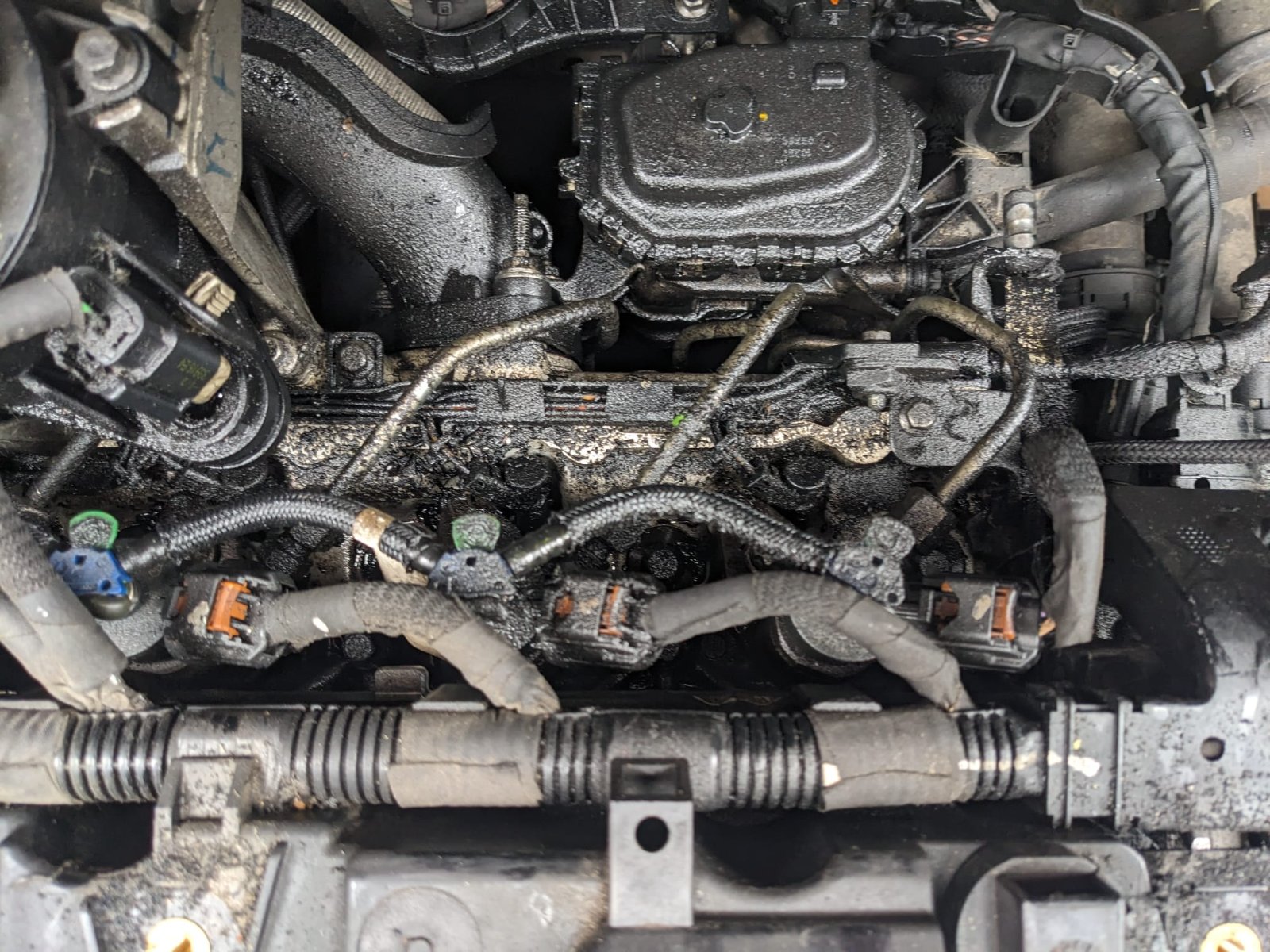

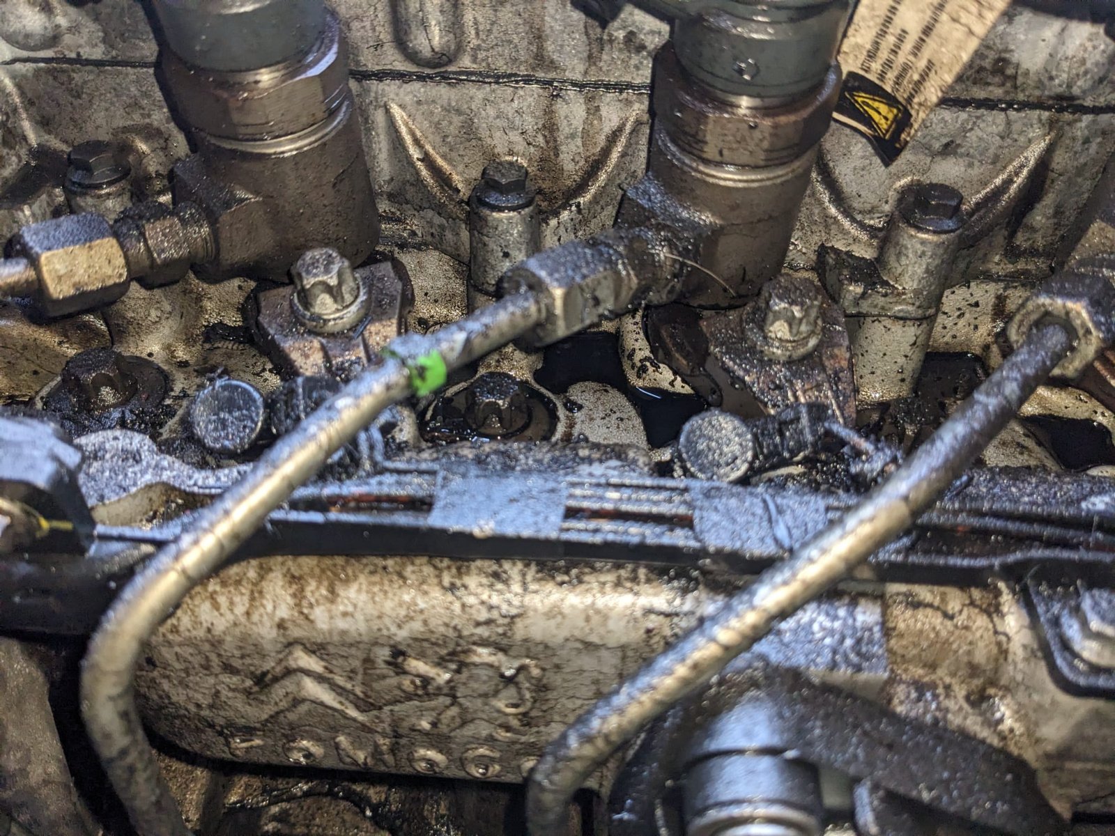

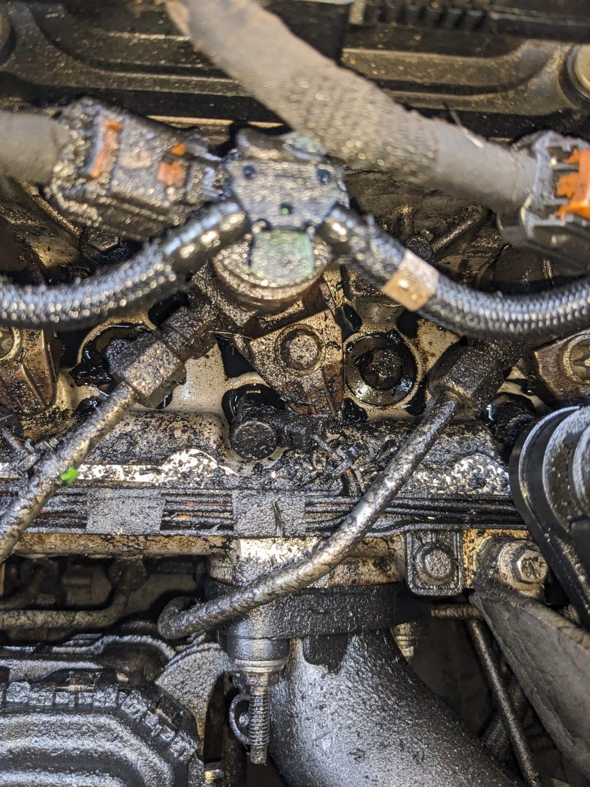

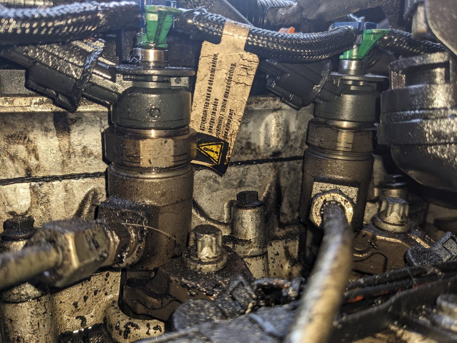

Thanks for your suggestions. I removed the air filter box and there is this same oil/diesel/carbon all over the components under the air filter box. Do you think this is all caused by an injector clamp being loose?
Do you know what the thing at the bottom is?
I think these are the middle injectors

Could well be, as I said mine was!! :)

I don't see how it could be. On the 16v engines the injector goes through the cam cover before going into the cylinder head. It's when the seal between the injector and the cam cover is compromised that you get oil leakage. It's simply not possible on the 8v engines as the injector doesn't go through the cam cover.
