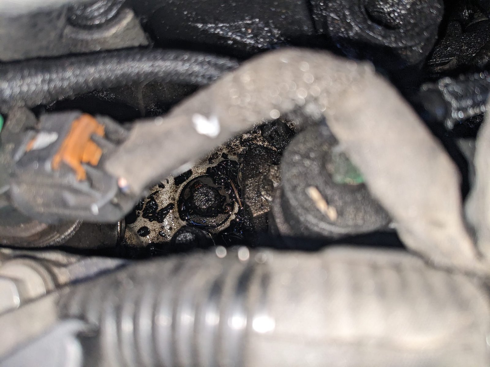

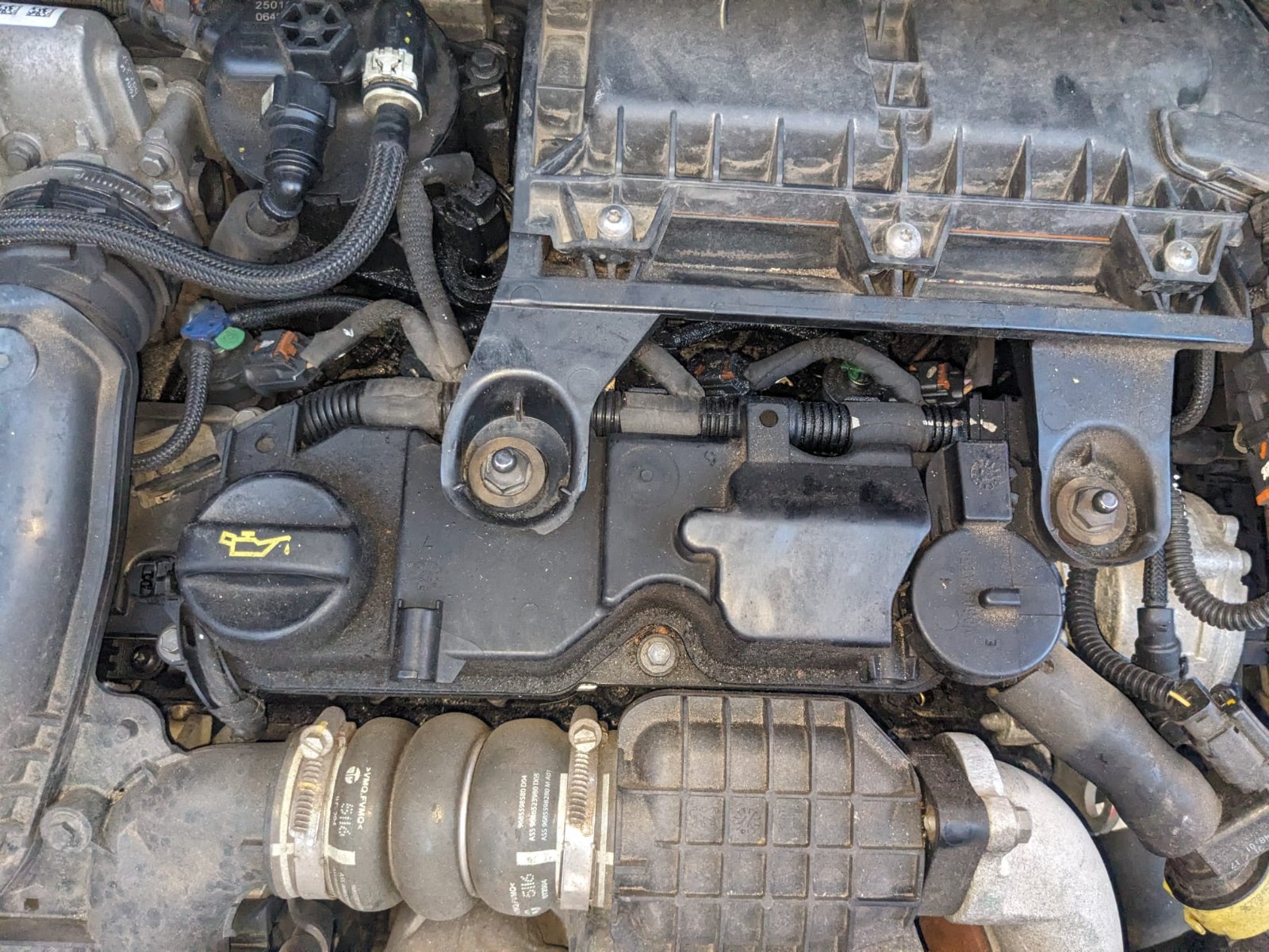

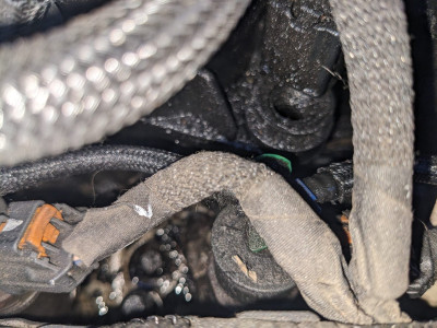

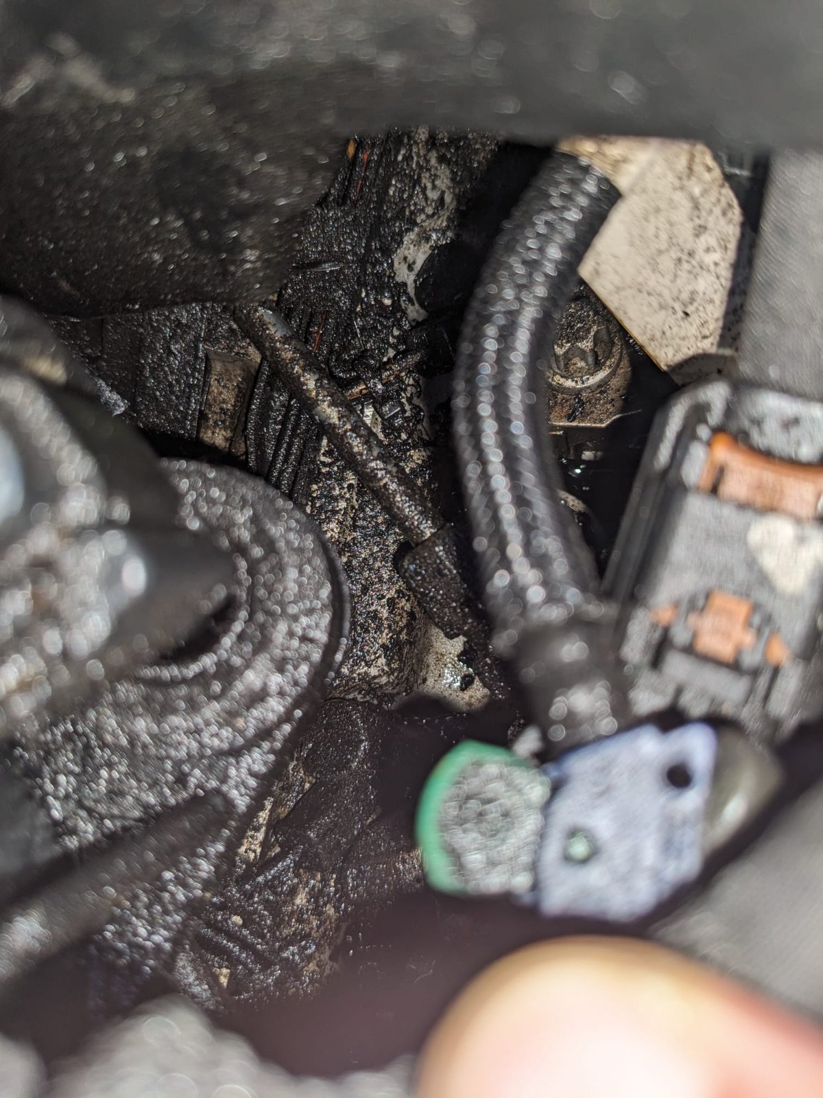

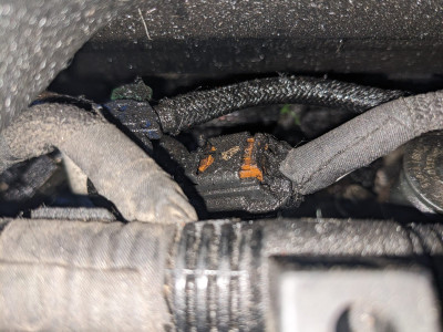

Re: 2017 1.6 hdi oil/diesel under engine cover (Peugeot 2008 120bhp)

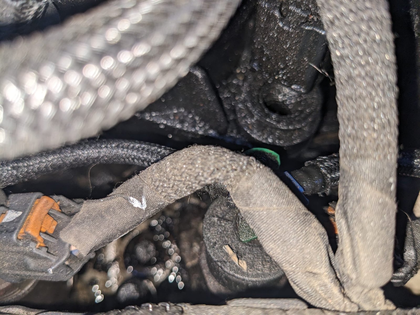

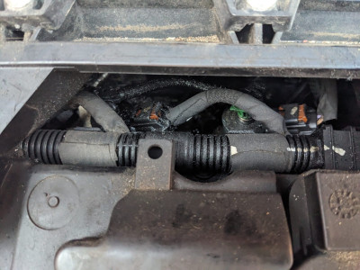

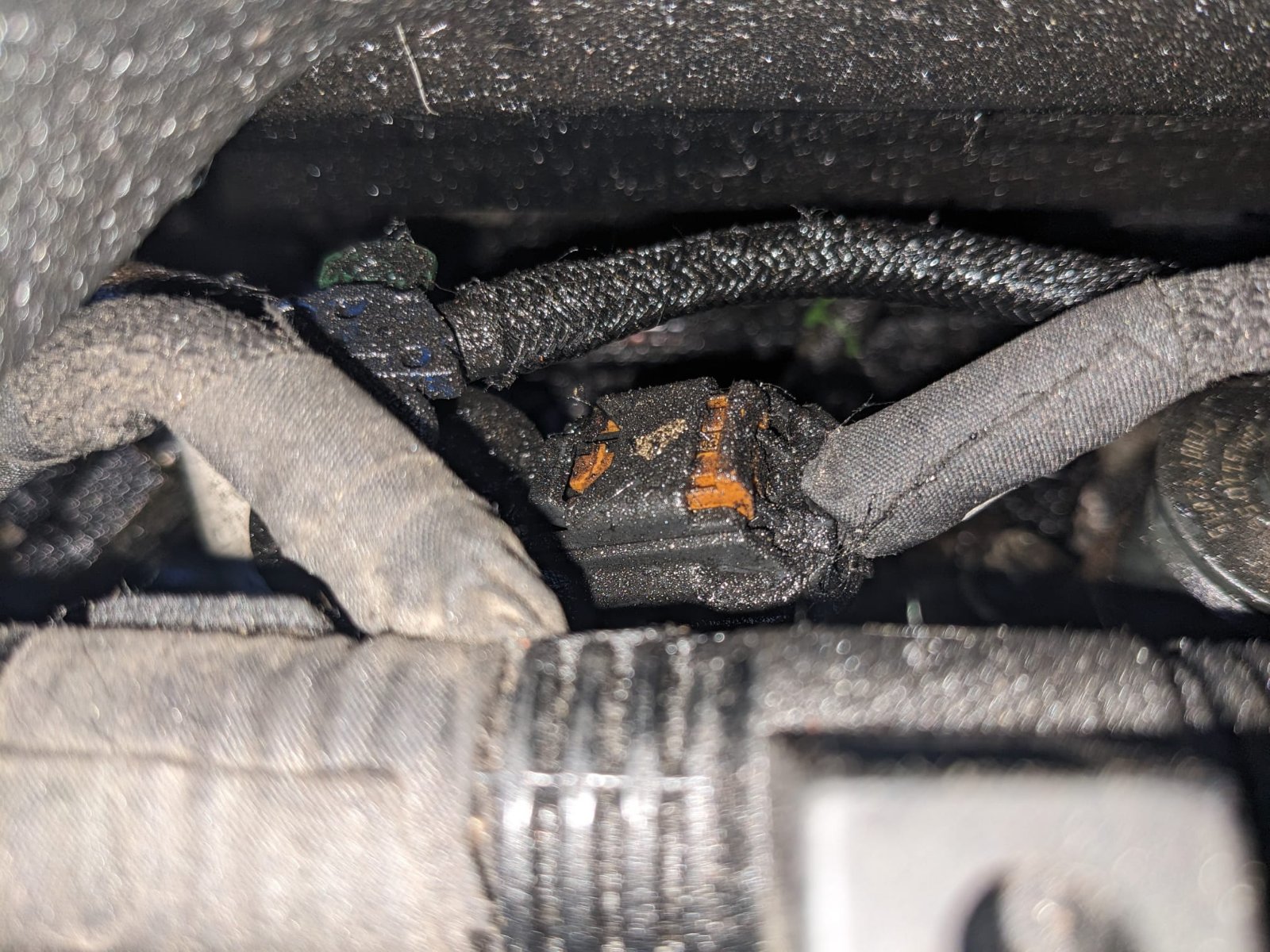

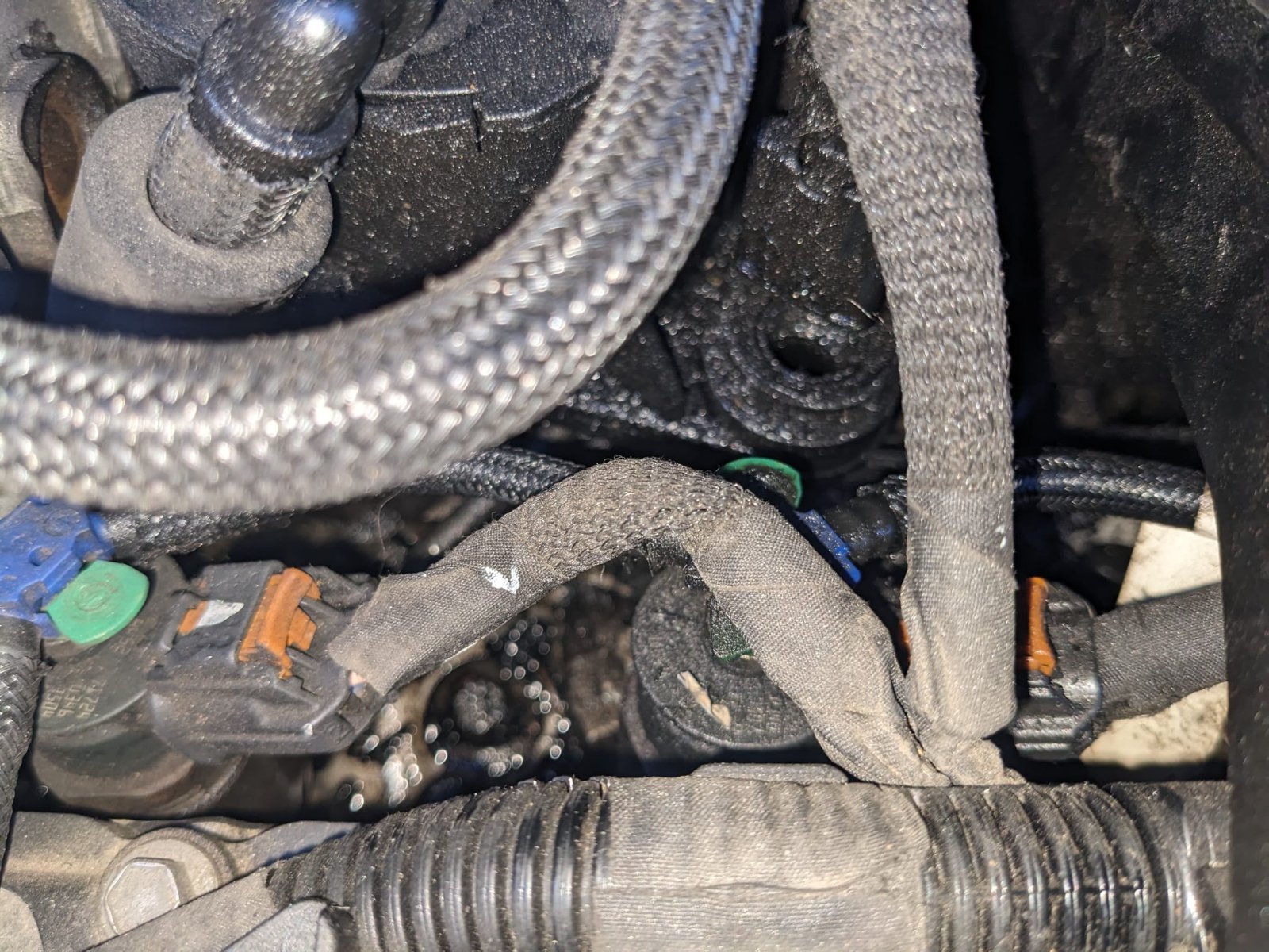

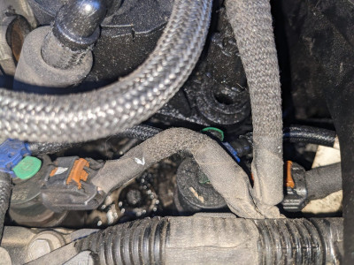

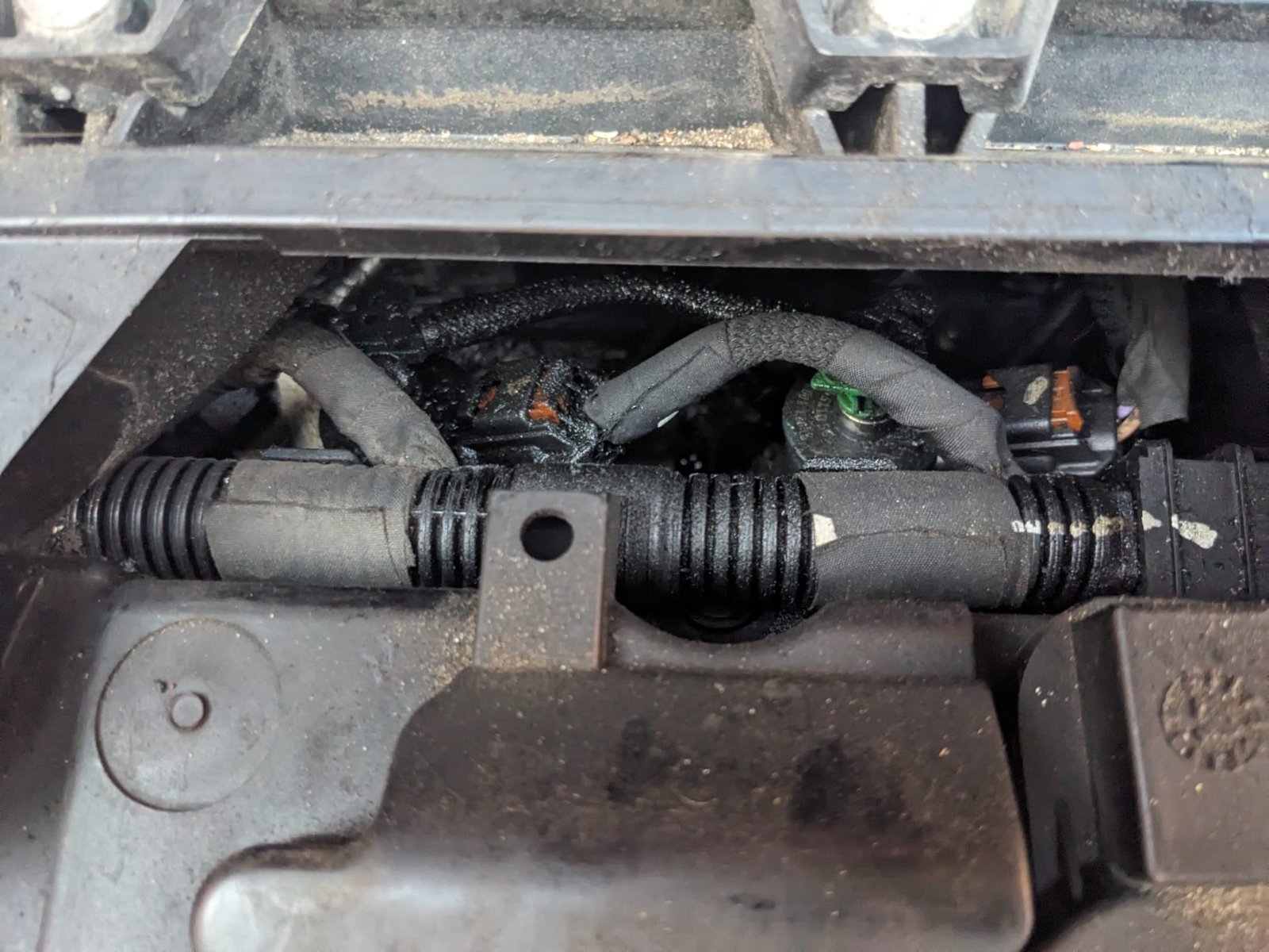

Here are some pictures - please can you have a look and advise if it really is an injector seal? Not sure if my labels are helpful.
(For my ref the pictures I've added are 0 1 5 9 10 11 17)
- Posts: 9275
- x 1931
The 8v engines seem to suffer from oil leakage at the top end which comes from either the cam housing to head joint or the oil seal on the camshaft. Our 1.6 8v has a slight leak on the top end somewhere and has had for several years. I'm waiting for the miles to build up a bit more and get it sorted out when it's time to replace the timing belt.
So do you think this is just an oil leak?
- Posts: 9275
- x 1931
It's certainly a possibility. Have a look at the photos on the second page of this thread from four years ago when I changed an injector.
viewtopic.php?t=64451
As I said in that thread, the oil level on the dipstick doesn't appear to go down. Do you have a noticeable difference on your car between oil changes?
