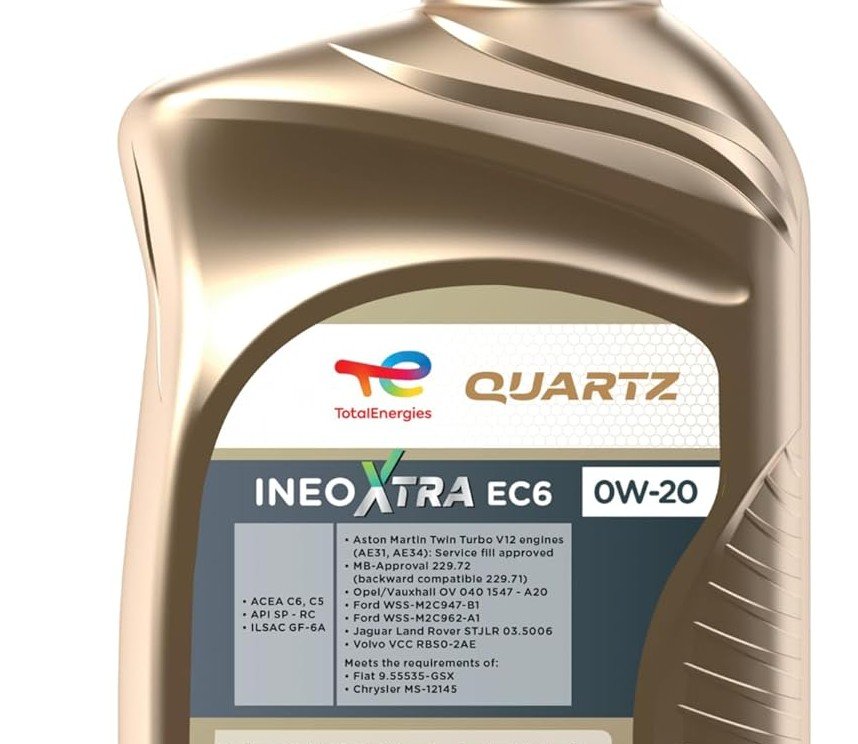

Re: Correct oil grade for C3 Aircross
Is this oil suitable?
Its a Total brand and is c5/c6 and 0w-20
https://www.amazon.co.uk/TotalEnergies- ... r=8-5&th=1
PaulC5

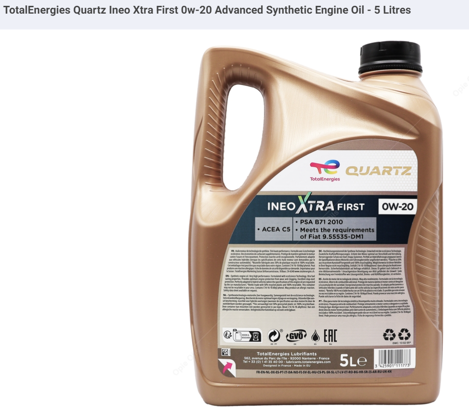

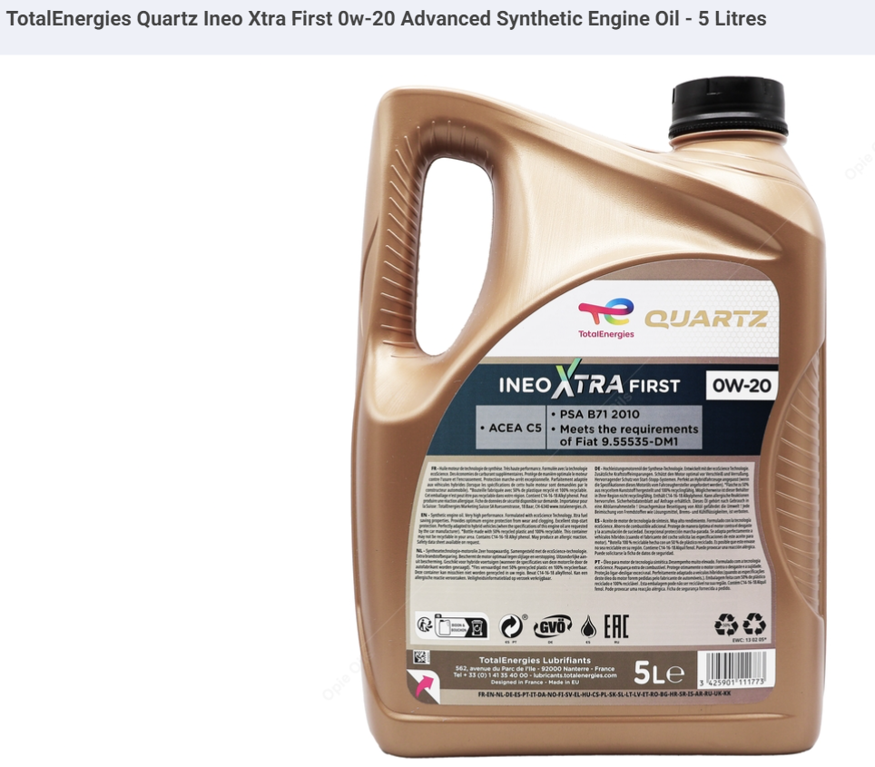

No, not that one, you need this one:Jesterstear1 wrote: 20 Oct 2024, 12:56 Is this oil suitable?
https://www.opieoils.co.uk/p-250431-tot ... tid=387557
As you can see on the back it clearly states PSA B71 2010 standards as stated in the guide I linked to.

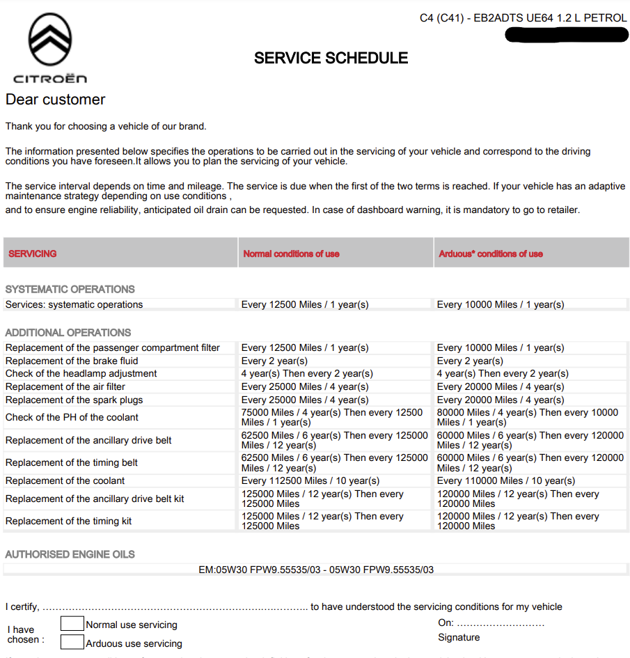

Have just bought a c4 puretech 130 max. Asked dealer for service schedule and oil spec and he sent me what looks like an official Citroen service sheet with my vin and engine type EB2ADTS code HNS but it is specifying 5w 30 oil. On the Stellantis guide it is stating 0w 20. Has my dealer got this wrong by using outdated info from Citroen. I would have thought the service schedule document would self populate using the vin. My vin is VR7**************[VIN obfuscated, can be read by forum staff]
I want to do an interim service before 12k and 1 year and really want to use the best oil.
The plot ( not the oil) thickens. Dealer insisting it’s 5w30. Citroen uk came back to my query and confirmed same. Call to customer service at Citroen and different assistant said that in the system using my vin it said 0w20 but in the service system it says 5 w 30. They are going to investigate and get back in a couple of days. Really surprising that this isn’t properly sorted by Citroen uk in its reference systems given the huge publicity given to oil related issues. ( wet belt/ consumption ).
- x 6950
@Davidcumbria: For your specific car, it is 5W30 shown on the current service for your vehicle (which is what the dealer will see when they come to service it), but the guide of July 2024 I wrote on the Forum still shows 0W20 for this engine, so let me know as I may have to check for the latest updates again if it has changed already....
The nature of these wretched EB2 wet-belt engines is probably why they are constantly changing oil grades backwards and forwards!
Citroen have reconfirmed 5w30. They asked where the 0w20 recommendation came from . Do you have a reference number for the Stellantis document or other way it can be identified?
- x 6950
Like I said the main PSA recommended oils document as of July 2024 still showed 0W20, but this may have been updated again as I said, as this was revision 122! So that's why I checked using your VIN and the official servicing schedule for your specific car as this should always be up to date, and correlates to 5W30 as I mentioned.
Given that there are constant changes to engine oil recommendations, I will probably retire the document I created as it is too unwieldly to frequently update.
