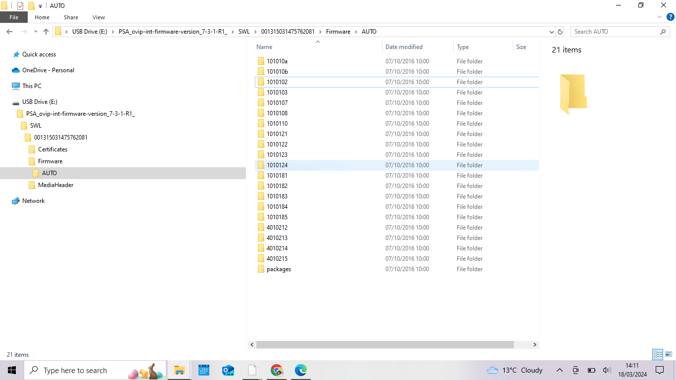

Yeah i downloaded the file to my laptop and unzipped it straight to the usb (fat32).
Started the car and let everything load. Inserted the usb and got the message about not finding media files. Didnt touch anything and sat there for about 5 mins and nothing loaded

Let me have a screenshot of the content of the USB drive (use the 'full editor & Preview' button then attachments, browse to image and then place it in the post), so I can see what structure you have on the USB.

Re: Infotainment system
hopefully Ive done it right
- x 6955
Ok, so you've extracted the whole thing including a folder with the name of the compressed firmware file into the route of the USB. You extract the contents of the compressed file ONLY, otherwise the Head Unit cannot locate the update script file as it is now buried in another folder and will not look beyond the route for this.
If you are using a utility like 7Zip and have your freshly formatted USB ready in the PC, as drive 'E:' then you only extract the contents to the E: drive and do not allow it to copy the folder name. So when you open the E: drive you only want to see the SWL folder and the 'Updateinfo.xml' file in the route and nothing else. All the remainder of the folders and files are within the SWL folder.
