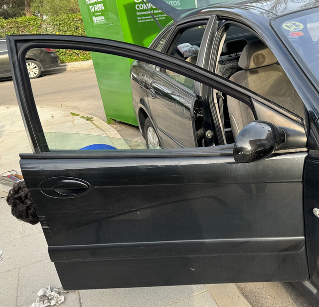

Thank you very much I will review tomorrow. Do you know if the passenger window in C5 II goes all the way down? In mine there are 5-8cm of the glass left even when you lower the front passenger glass to the bottom.
- x 6955
Re: Citroen c5 II height sensor suspension
The front windows should lower all the way - it's not normal for the front windows to remain partially lowered. Only the rear windows don't lower fully for child safety.
Sounds like the motor isn't calibrated properly or the window regulator wire is stuck / too short...
It seems to have always worked this way, what could be wrong? how to calibrate the engine? When it reaches the bottom it stops and if I press again it tries to go down but it stops due to pressure. Yesterday I dismantled the panel to check but I didn't see anything strange, everything is originalGiveMeABreak wrote: 18 Mar 2024, 00:28 The front windows should lower all the way - it's not normal for the front windows to remain partially lowered. Only the rear windows don't lower fully for child safety.
- x 6955
When the window lowers to the bottom, have you tried using the button to manually lower it, by pressing gently at the first click only (not using the 'one-touch' feature)? Keep pressing (only at the first click of the button push) to lower the window and see if it will lower in small steps.

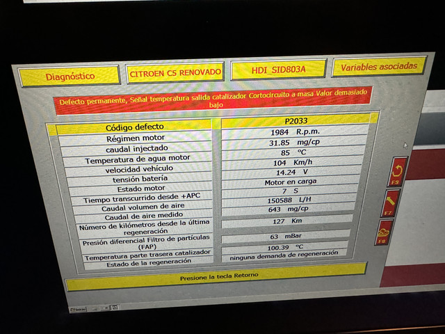

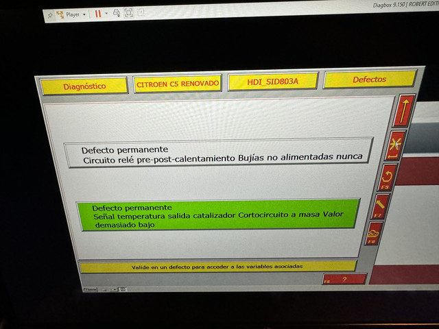

I will check tomorrow but I seem to remember that it did not go down any further and it seemed like the engine was forced to brake at the bottom. Today I scanned with Lexia to check for errors and I found this new error that I had never had before, I recently changed the distribution, water pump, thermostat, etc... I don't know if it has something to do with it or if there is a damaged cable and where. review lookGiveMeABreak wrote: 18 Mar 2024, 13:26 When the window lowers to the bottom, have you tried using the button to manually lower it, by pressing gently at the first click only (not using the 'one-touch' feature)? Keep pressing (only at the first click of the button push) to lower the window and see if it will lower in small steps.

Any guide to changing the RHR 136CV FAP exhaust temperature sensor?
- x 6955
It's a simple matter of disconnecting the plug and removing / replacing the sensor - tighten to 2 ± 0,3 m.daN).
I have tried but the same result stops in the same place; tries to go down and stops

GiveMeABreak wrote: 19 Mar 2024, 12:10 It's a simple matter of disconnecting the plug and removing / replacing the sensor - tighten to 2 ± 0,3 m.daN).
No see conector

I couldn't solve the window part either, it doesn't go down completely and I don't know the reason.
Today I will try to change the FAP sensor to see if the most serious error is solved.
