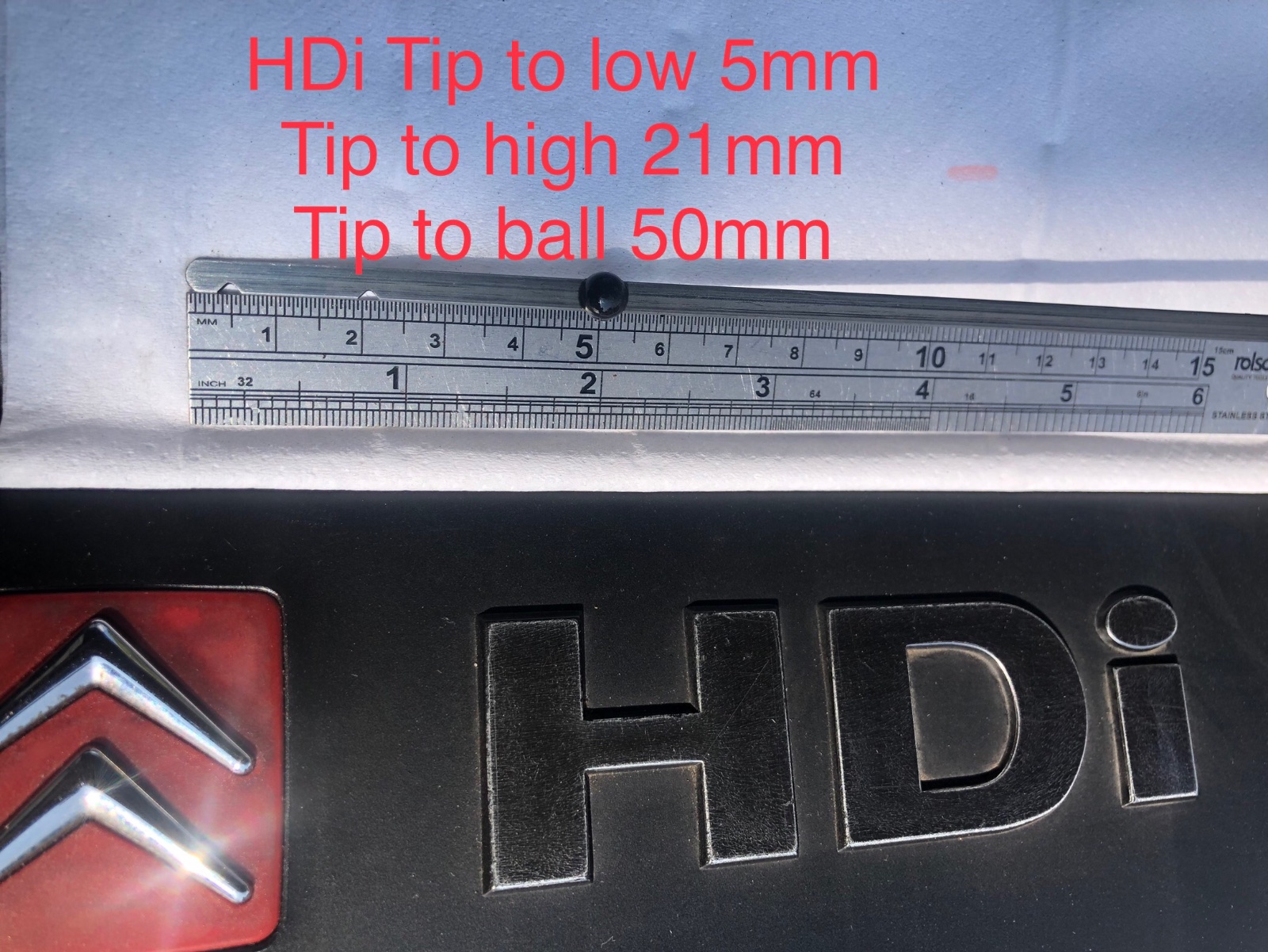

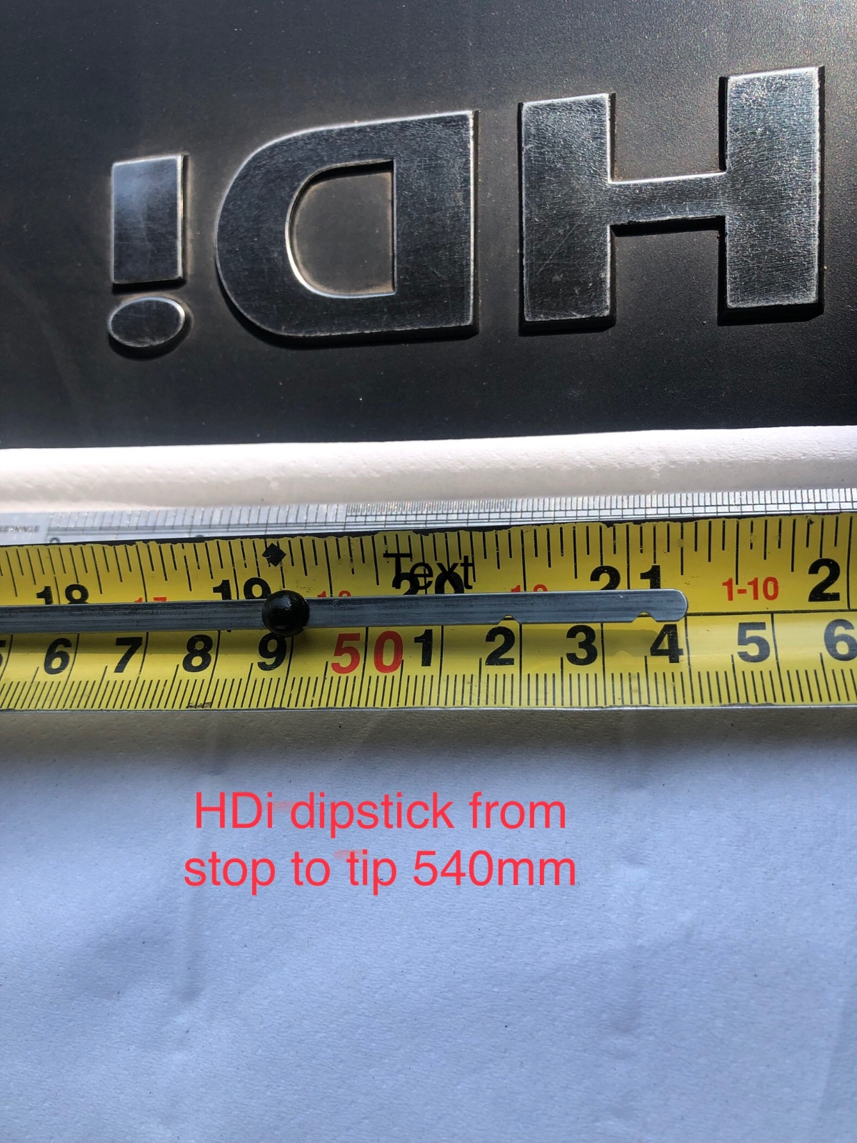

Can I ask a favour please? Can you measure your dipstick for me? See post I tagged Civvie in a couple above this one for more details of request please...
I'm going daft tagging the wrong people.
Great job on the wings.
Whoever wants it (Rothgar) :lol:
Skull’s HDi (110) dipstick
Hope that helps

Skull wrote: 02 Sep 2023, 14:35
Whoever wants it (Rothgar) :lol: ImageImage
Hope that helps
Cheers Skull.
Ot would do if mine was right!!
Is yours the original dipstick?
Mine is 530 stop to top.
My high mark should be at 519. It’s at 505!!!!
Neither does mine have a ball. Not that that matters.

Rhothgar wrote: 02 Sep 2023, 19:14
Came with the car 8 years ago :dunno: seems original (rubber loop handle) and certainly measures accurately on oil changes / re-fills.
My Haynes manual states that there is a litre between the lower and higher marks on the dipstick, which also relates to my dipstick marks.
Gary
