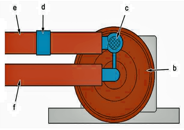

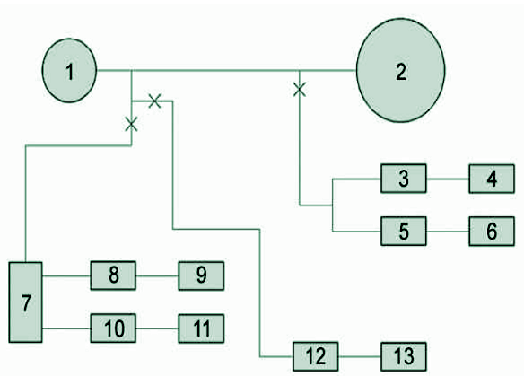

There's no operating parameters for the system that I have, but component / flow chart:
" a" Yellow colour identification on the rubber pipe supplying the inlet air heater meter.
Flow Chart (1) vacuum pump.
(2) Brake servo (ISOVAC).
(3) Butterfly housing control proportional electrovalve.
(4) Butterfly housing meter.
(5) Inlet air heater control proportional electrovalve.
(6) Inlet air metering device-heater.
(7) Vacuum reservoir.
(8) Turbocharger capsule valve proportional electrovalve.
(9) Turbocharger capsule valve.
(10) "Swirl" control electrovalve.
(11) "Swirl" diaphragm.
(12) EGR valve vacuum proportional electrovalve.
(13) EGR valve.
(14) Vacuum pipe linking the "Swirl" electrovalve to the "Swirl" diaphragm.
Connections of the unions on the electrovalves ( 3), (5), (8) and (10) :
"b" Control proportional electrovalve
"c" Colour reference on the electrovalve
"e" Electrovalve outlet pipe with colour reference (at "d")
"f" Electrovalve inlet pipe
Colour References
N.B.: The pipe ( e) should be connected facing the colour reference "c" on the electrovalve "b".

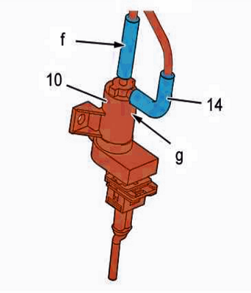

Connection of the unions on the electrovalve ( 10):
"g" Colour reference on the "Swirl" electrovalve
(14) Vacuum pipe linking the "Swirl" electrovalve (10) to the "Swirl" diaphragm (11)
Colour Reference
N.B.: The pipe ( 14) should be connected facing the colour reference "g" on the electrovalve (10).
Colour References
Colour Reference
| Reference | Designation | Electrical connector | "g" | (14) | "f" |
| (10) | "Swirl" control electrovalve | Black | White | Without | Without |

Thank you very much, Marc.

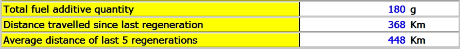

Thank you for all that detail!aspire_helen wrote: 25 Jun 2023, 15:00 Pretty clear to me your the DPF is over-loaded, and regenerations have failed. What data does Lexia give you re the particulate filter and re-generations?
Every 450km, 180g. There's a video with a run up a hill watching the PDF parameters in an earlier post, though I'm not sure what, if anything, it tells us. Whether the regen is actually doing anything or the pump is actually injecting Eolys... that I don't know.
The ECU seems to think the fuel cap sensor is missing, but Marc checked and mine isn't supposed to have a cap sensor, so I'm not sure why the ECU thinks it does - perhaps someone replaced the tank / ECU with slightly incorrect version.

Your data suggests your DPF may not be overloaded. Below is my data for comparison after I received the warning "clean diesel filter asap", which will have resulted from 3 consecutive failed regenerations. I have also noted your DPF pressure difference is 58mb. I do not know the value which triggers a regeneration (Does someone know) but 58mb seems pretty low to me. Mine was around 300mb.
My "distance since last regeneration" was 700km, yours is 368km. "last" generation would normally mean last "completed and successful" regeneration.
My "average distance of last 5 generations" was 200km, yours 448km. 400km is the official expectation, but depends upon driving conditions. 200km for my driving was very low and was a clear indication the DPF was becoming increasingly difficult to regenerate (due to long-term build up of ash). Indeed, I was aware from my DIY "LED regeneration indicator" (no patents pending!), that regeneration was being attempted a lot more frequently. What I did not appreciate was that the previous 2 attempts had been unsuccessful - the car does not tell you until it fails 3 in a row.
Regarding changing glow plugs. At your stage, I would recommend leaving the plugs alone at the moment; they are not the direct cause of your low power. But to investigate, check the glow plug controller first (to find it follow the terminal wires) - there are some good Youtube videos including one for a DW12TED4. I am reluctant to attempt to replace the plugs on mine , as one video shows what happens when they dont come out easily!!
