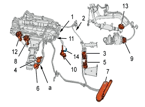

There's no operating parameters for the system that I have, but component / flow chart:
" a" Yellow colour identification on the rubber pipe supplying the inlet air heater meter.
Flow Chart
(1) vacuum pump.
(2) Brake servo (ISOVAC).
(3) Butterfly housing control proportional electrovalve.
(4) Butterfly housing meter.
(5) Inlet air heater control proportional electrovalve.
(6) Inlet air metering device-heater.
(7) Vacuum reservoir.
(8) Turbocharger capsule valve proportional electrovalve.
(9) Turbocharger capsule valve.
(10) "Swirl" control electrovalve.
(11) "Swirl" diaphragm.
(12) EGR valve vacuum proportional electrovalve.
(13) EGR valve.
(14) Vacuum pipe linking the "Swirl" electrovalve to the "Swirl" diaphragm.
Connections of the unions on the electrovalves ( 3), (5), (8) and (10) :
"b" Control proportional electrovalve
"c" Colour reference on the electrovalve
"e" Electrovalve outlet pipe with colour reference (at "d")
"f" Electrovalve inlet pipe
Colour References
ReferenceDesignationElectrical connector"c" & "d""f"
(3)Butterfly housing control proportional electrovalveBlackWhiteWithout
(5)Inlet air heater control proportional electrovalveBlue--
(8)Turbocharger capsule valve proportional electrovalveGrey--
(10)"Swirl" control proportional electrovalveBlue--
N.B.: The pipe ( e) should be connected facing the colour reference "c" on the electrovalve "b".
Connection of the unions on the electrovalve ( 10):
"g" Colour reference on the "Swirl" electrovalve
(14) Vacuum pipe linking the "Swirl" electrovalve (10) to the "Swirl" diaphragm (11)
Colour Reference
ReferenceDesignationElectrical connector"g"(14)"f"
(10)"Swirl" control electrovalveBlackWhiteWithoutWithout
N.B.: The pipe ( 14) should be connected facing the colour reference "g" on the electrovalve (10).
tearing hair out

Thank you very much, Marc.
