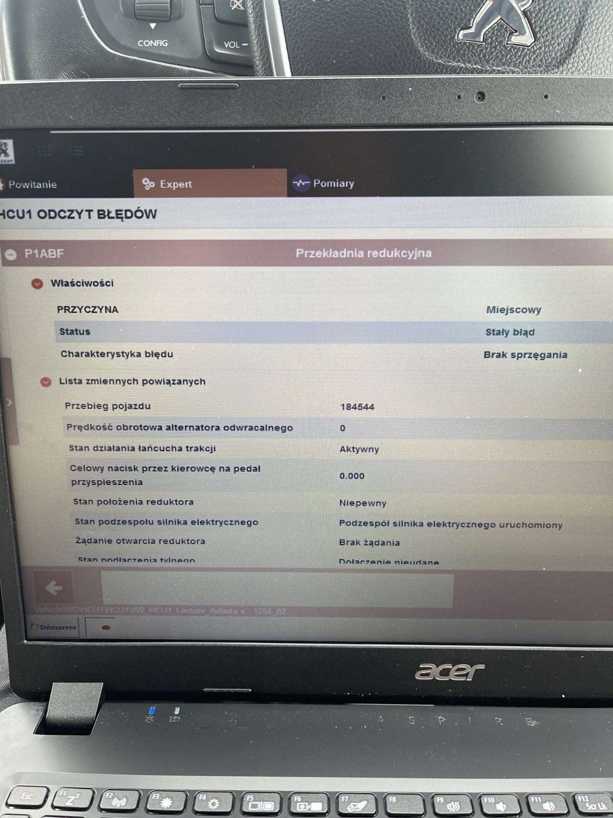

Hello, i have same problem with my car (2013 hybrid4 ds5)
We fix it the generator, and I have just the p1ac4 fault code.
How i can activate the the electromotor sub-assembly? I have Lexia diagnostic. Yesterday I try, but wrote me the message, i cant do it jet.
Thank you

I have issue with my hybrid system, the clutch on electric engine is not engaging so I have replaced the whole engine and diff with another working one but it’s still throwing this code P1ABF. I don’t know where else can I look so if someone can help me I would very appreciate that. Thanks
Hey do you reaolved your problem?thx
