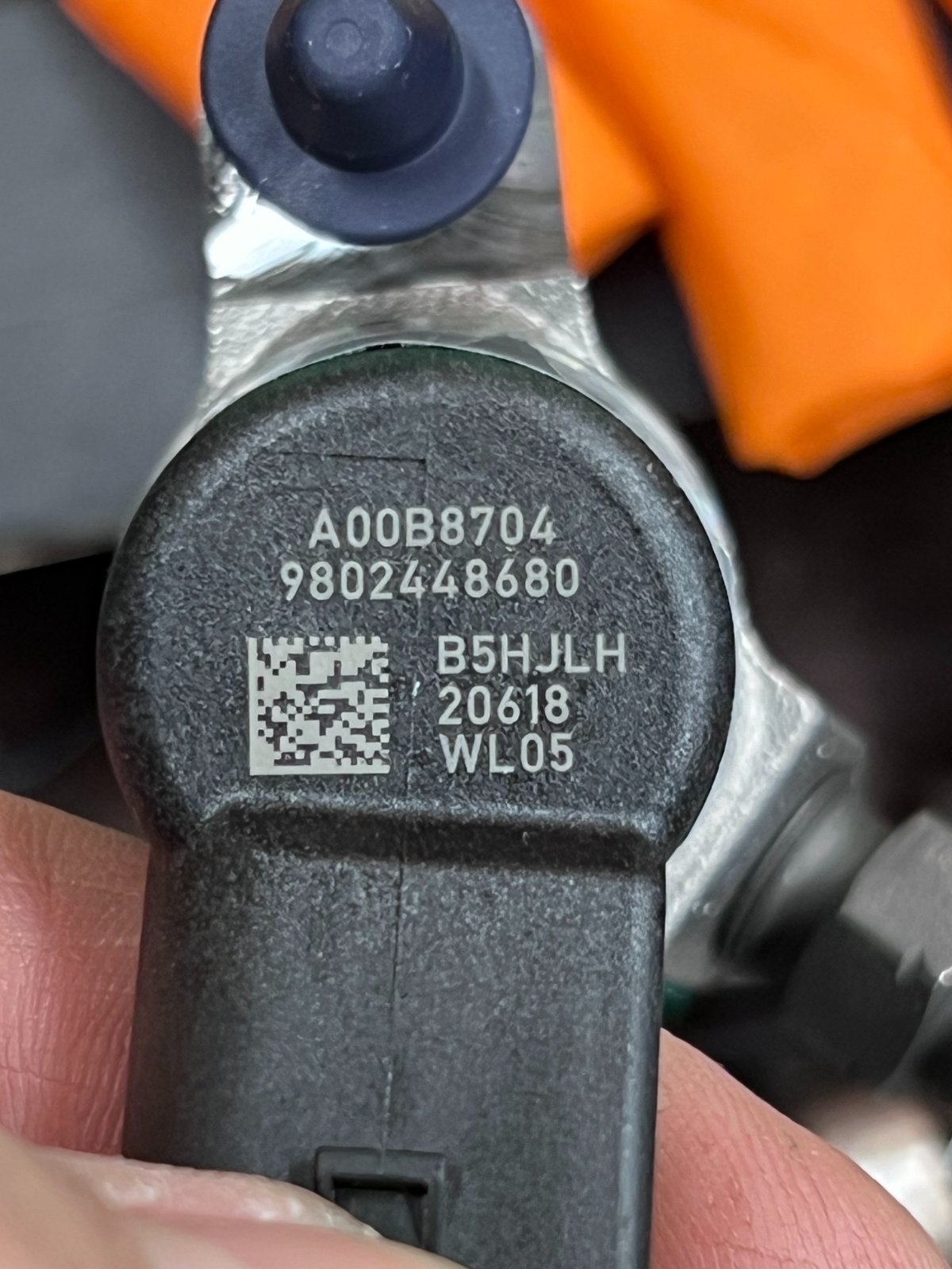

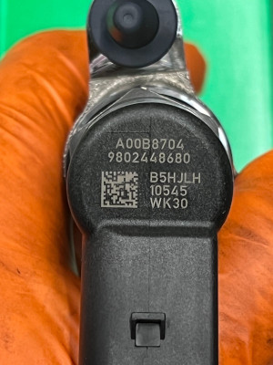

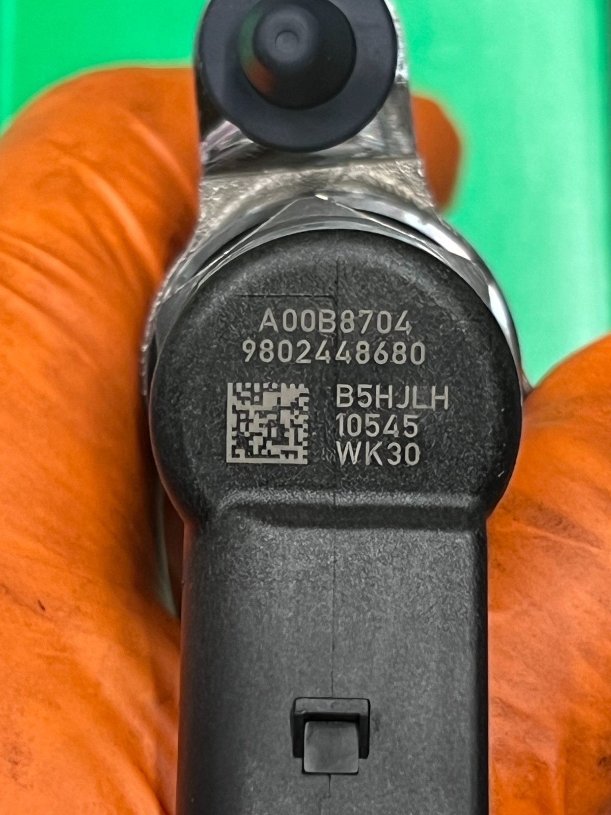

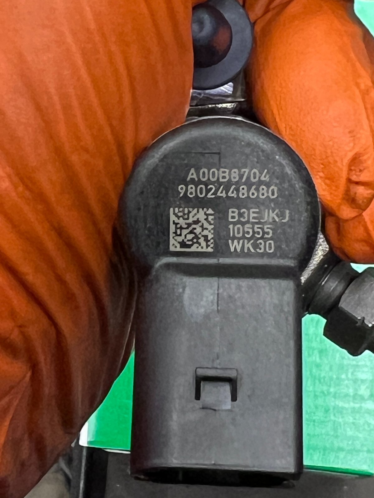

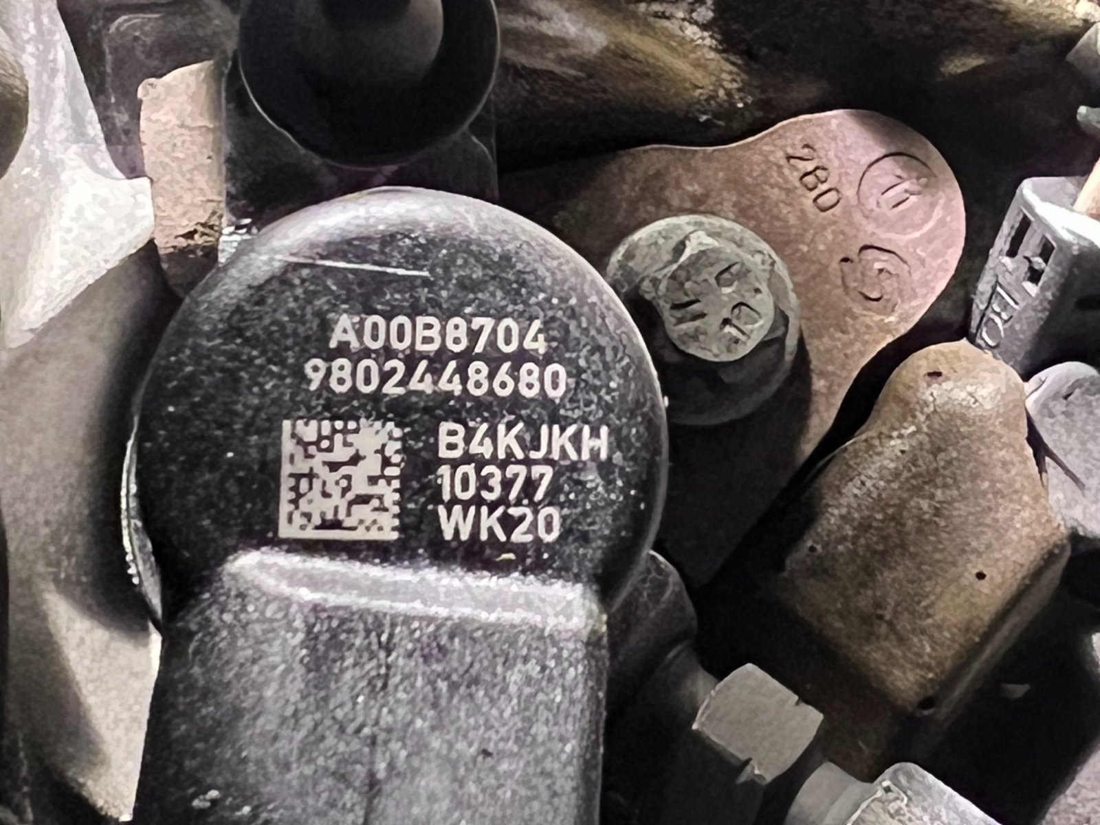

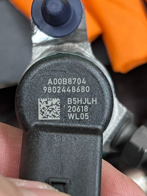

Agree. It sounds really strange if they are all almost new, but somehow they do not seem to collaborate well, 1 and 2 vs. 3 and 4.
Do you have a picture of the top of the injectors with the codes that you could share? Some letters and numbers could be misinterpreted, e.g. 0 and O and 5 and S.

I have pictures and will upload them here.
Don't understand that I can have registered a wrong ID (I was showing extremely caution doing this)
My daughter had to turn around and come back home after about 100km last night, so now I have the beast here for further investigation...
#1
#1
#3
#3
#4
#4
#2
#2
