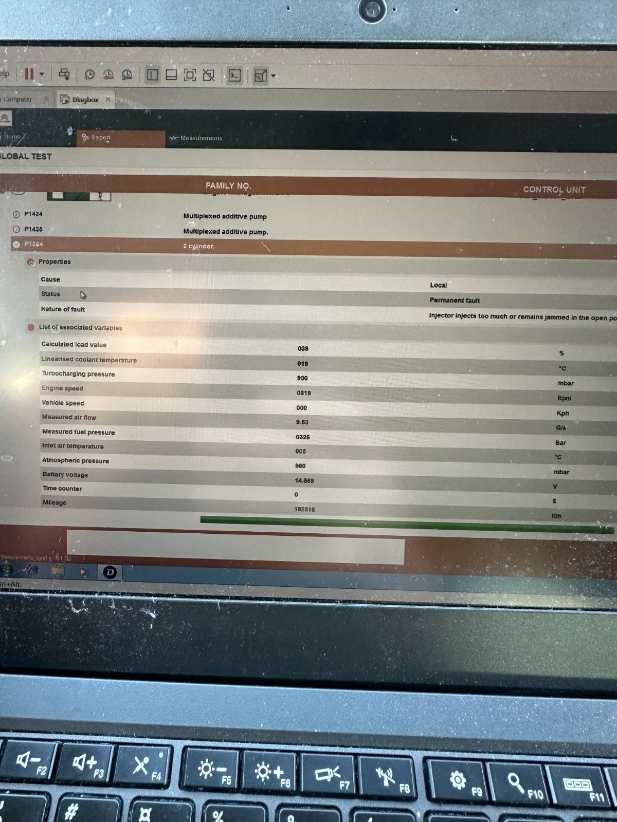

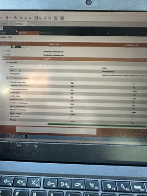

Car went into limp mode. Diagbox showed something like 'high resistance cylinder 2'. Measured the resistance on the injector, which was lower than the others. Replaced the injector with a brand new (VDO/Siemens/Continental). Recoded in Diagbox by entering the code written on top of the new injector, which was accepted in Diagbox. Runs decent, a little bit of wobbling around 1000-1200 RPM and at >2200 RPM. Diagbox now says fault code P12A4 (local/permanent fault 'Injector injects too much or remains jammed in open position, see below two screenshots:

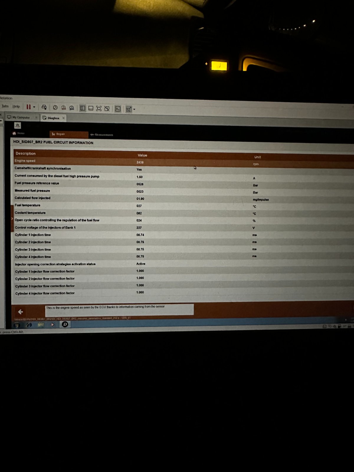

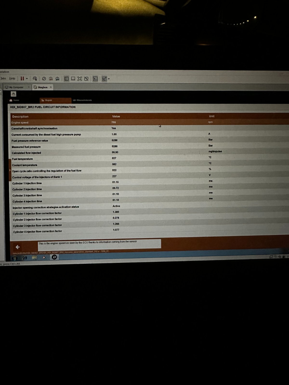

See below screenshots showing the cylinder injection time etc. at idle and at 2400 RPM. NOTE - these screenshots are taken before the ABS/ESP fault will occur.
As you can see, the cylinder injection time is off (0.72 vs 1.10-1.10-1.16 ms). At 2400 RPM cylinder injection time is spot on equal for all cylinders.

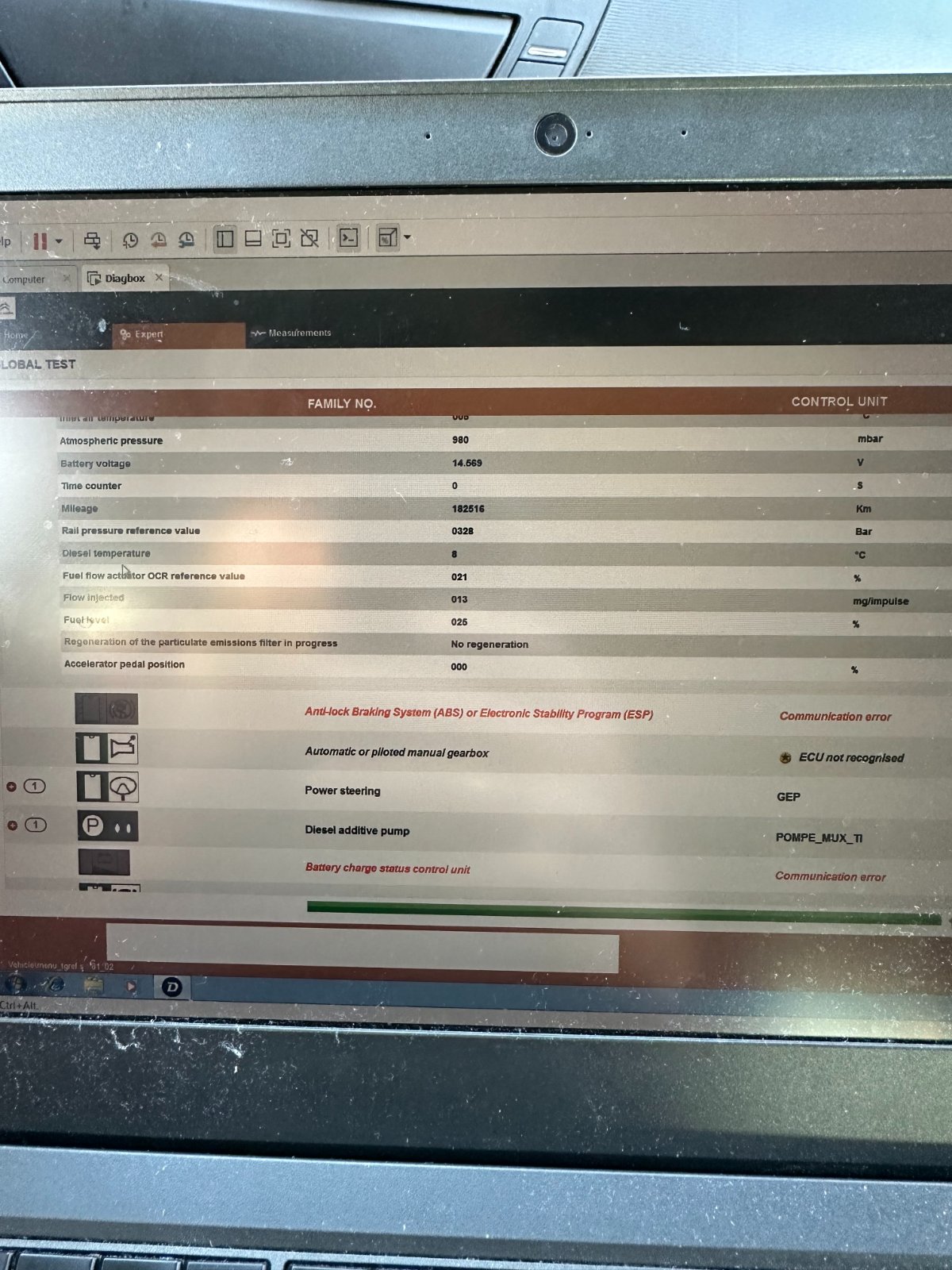

Then, after I have driven a little and the ABS/ESP fault has occured, cylinder 2 will now read 0 ms and I can confirm that the ECU has turned it off completely as a sort of safety measure, I guess.
Any ideas on what to do next? It seems a little odd that both the old injector AND the ECU/wiring or something else happened at the same time. And now, with a new injector I get this new P12A4 fault, which is probably the culprit now.

The fault would indicate this is still a possible cause:
| Fault Code: | P12A4 |
| Description of Fault: | No. 2 cylinder : Injector injects too much or remains jammed in the open position. The correction made to the fuel flow drift of injector 2 is higher than the maximum threshold. At least one of the following conditions must be fulfilled - Ignition switched on - engine running |
| Conditions for Fault to clear: | Driving for 5 minutes |
| Downgrade Modes whilst Fault is active: |
| Symptoms: |
| Suspect Areas: |

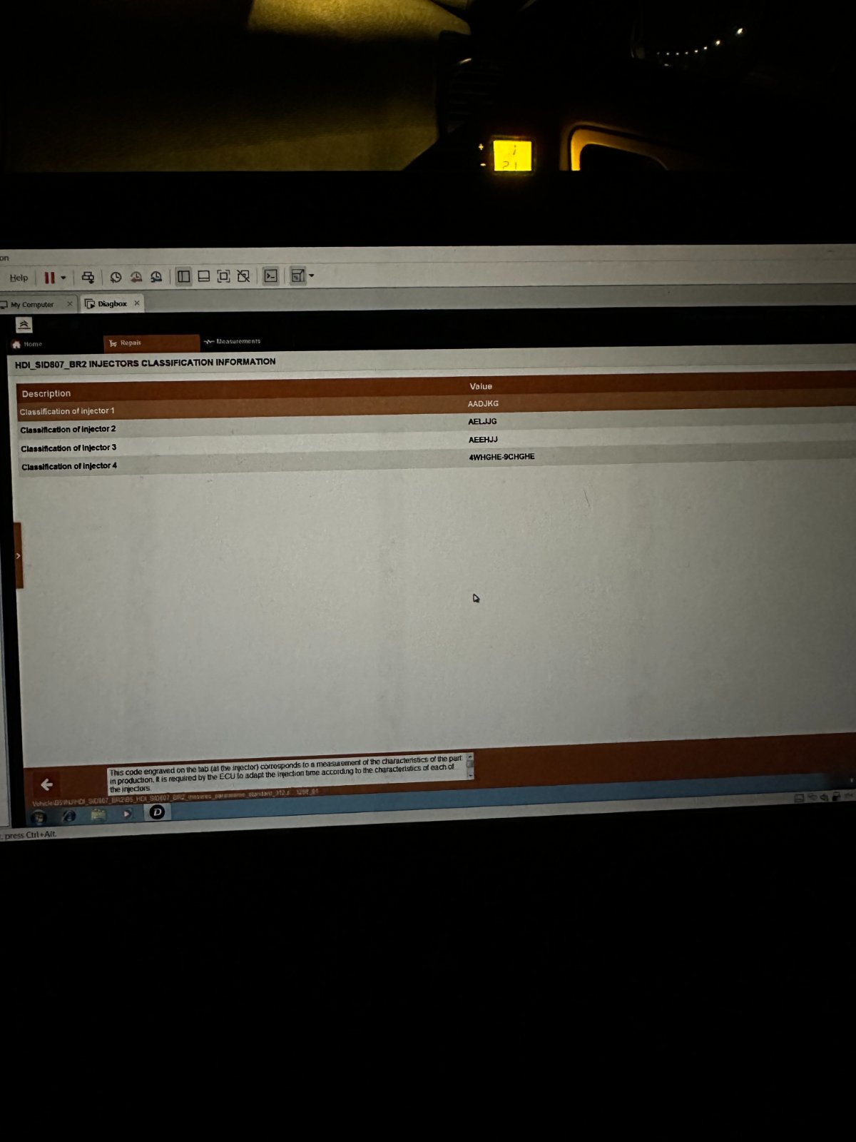

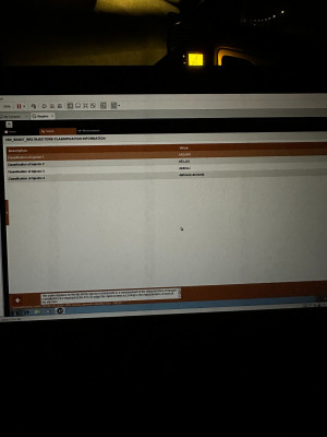

Re: New injector
Thanks for your reply
Yes. I double checked the code many times when i entered it:
