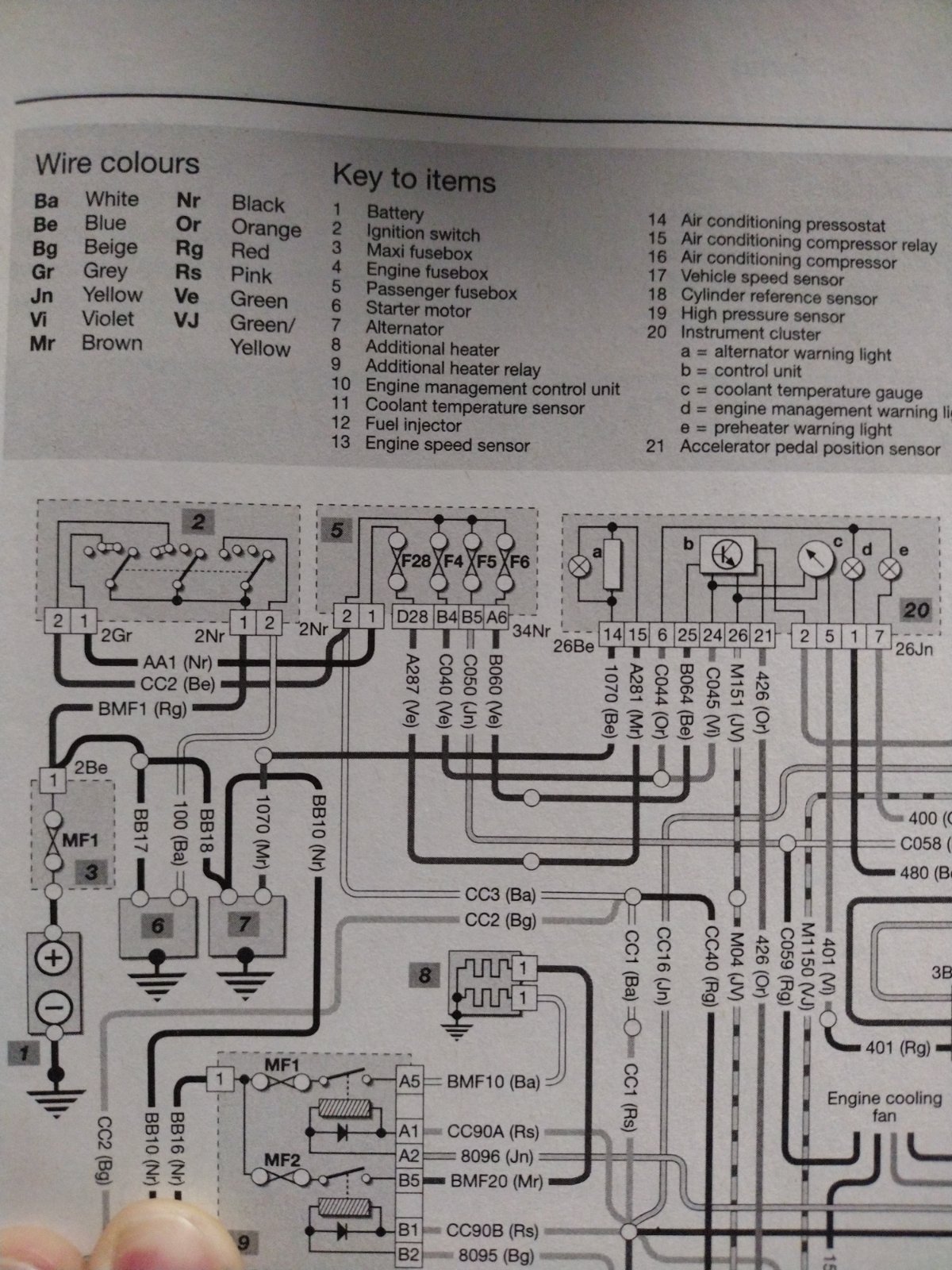

1 battery,
2 ignition switch
3 maxi fusebox (in engine bay I think)
5 passenger fusebox
6 starter motor
7 alternator
20 instrument cluster (and A is the alternator light)
So alternator has two connections,
Big one has BB18 - straight to starter motor and BB10 which is Nr = noir = black goes off elsewhere.
Small one is 1070. Mr = brown. Unhelpfully before instrument cluster it's swapped colours to Be = blue.
So ignition switch in 1st and second positions (accessory and running) should feed power via AA1 (black) to passenger fusebox, fuse F28 then feeds 12v via A287 (ve = green) to pin 15 of instrument cluster's 26 pin BE = blue connector.
From there it runs through bulb and resistor? To pin 14 and on to the alternator small terminal as described.
So check for 12 volts along that route (fuse 28, then probably easiest to jump instrument cluster and check alternator small terminal, then if at the fuse but not at the alternator, you're looking at instrument cluster out and check the pins described above.

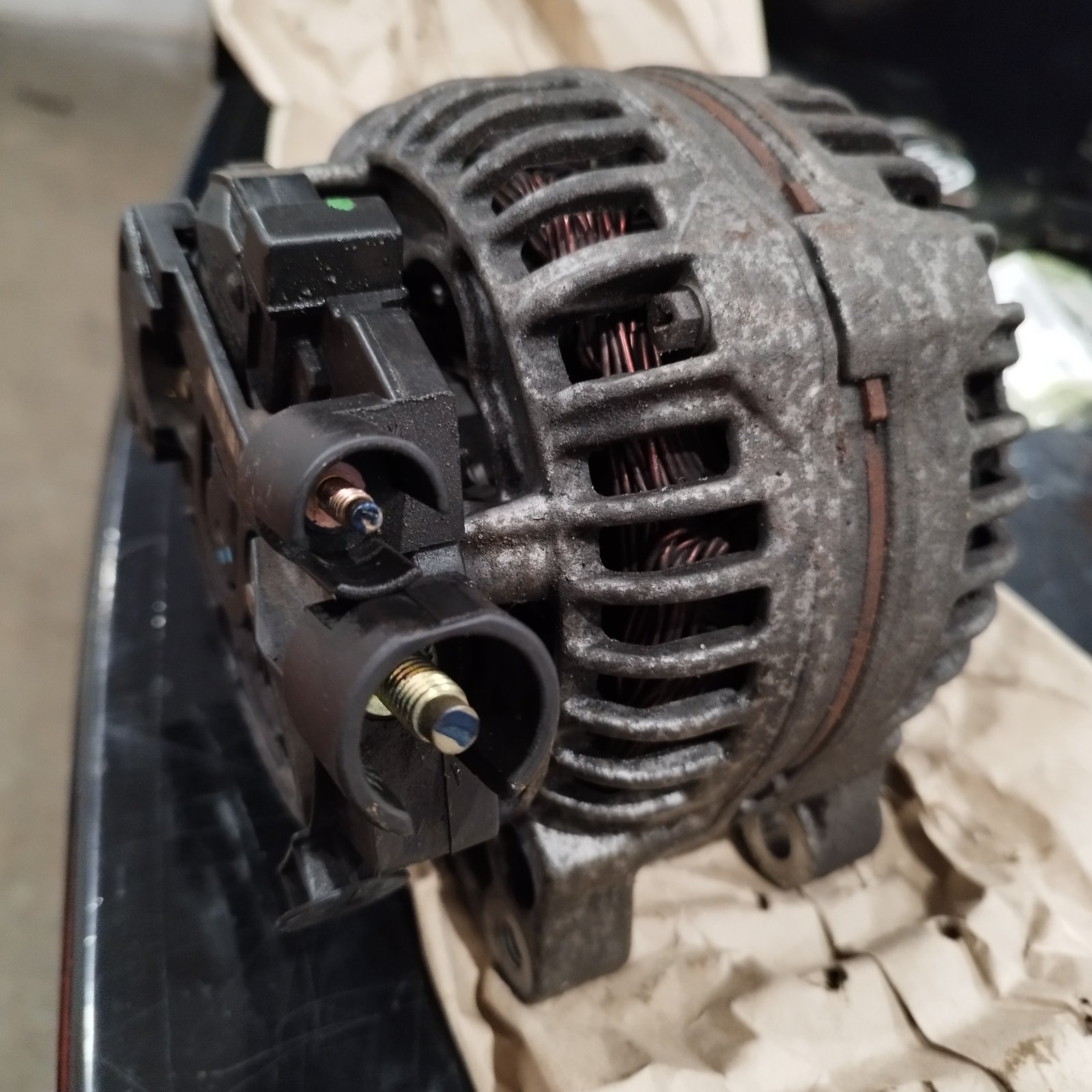

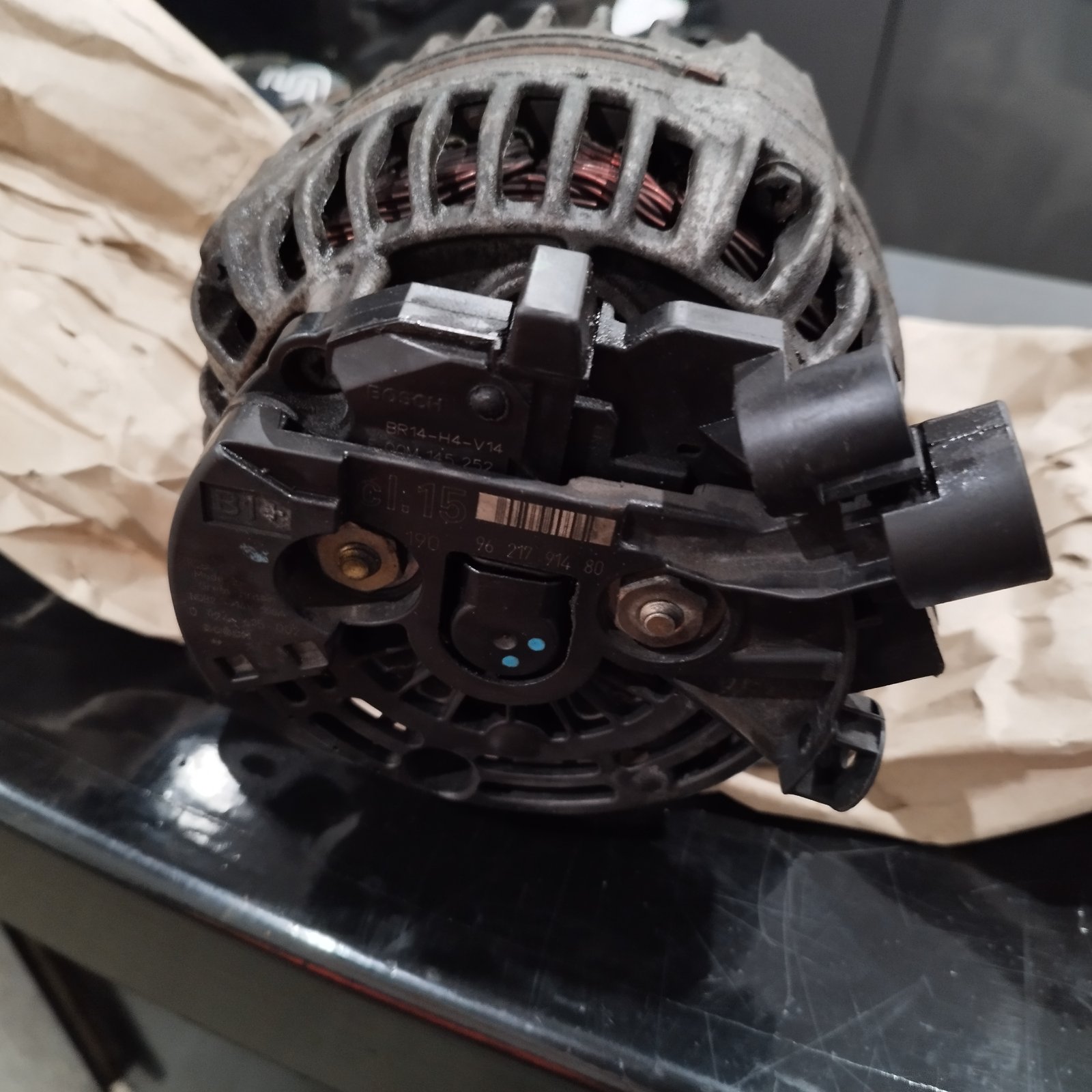

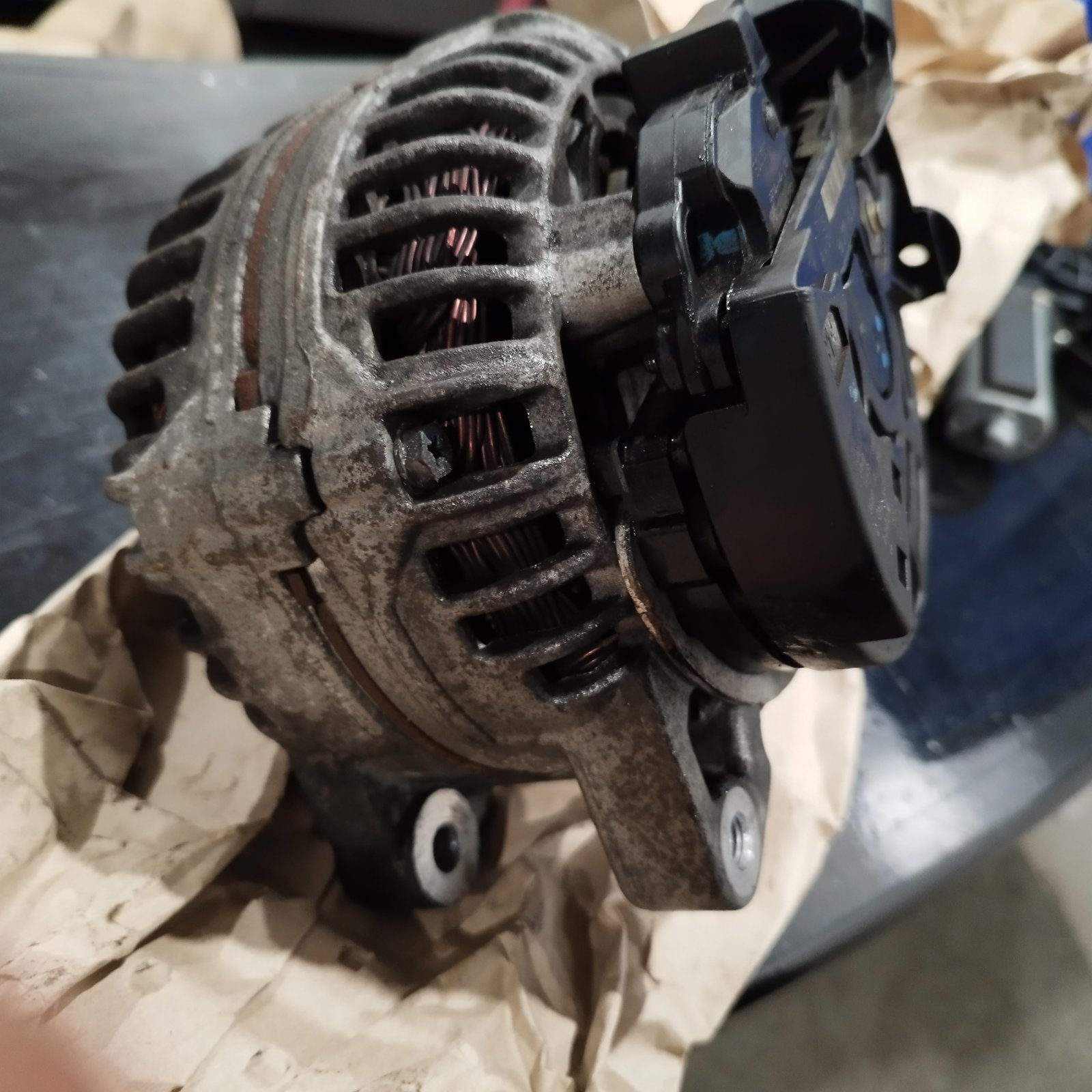

This is the one that came off, see pictures.
It was dark when I picked the car up so have not looked at the new one, yet.
The garage tested before & after, said it's now at the correct voltage, when idling, so at least that has now ruled the alternator out as being the cause?

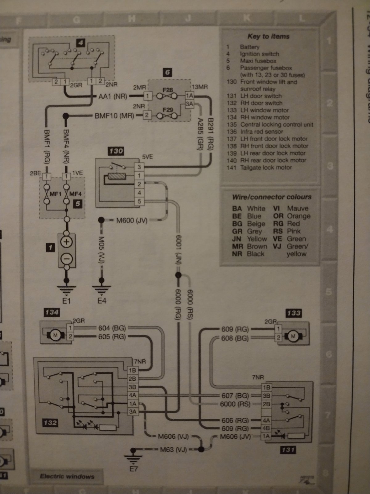

I'll see if Haynes has a wiring diagram for the elec windows shortly.

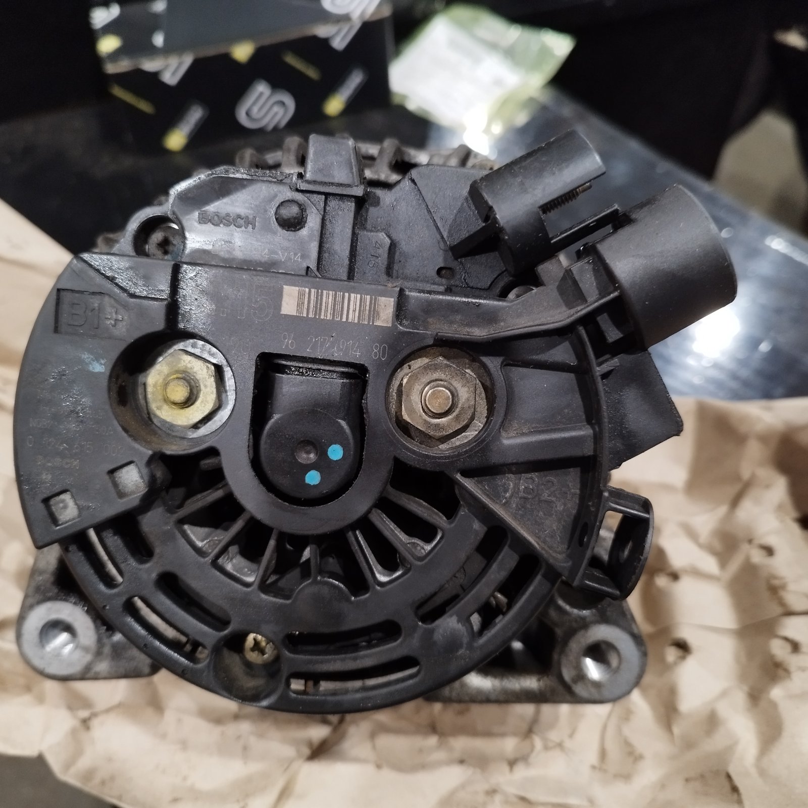

Third picture is the two pins I described on the previous post, top one is the feed in, the bigger one is the output. My memory was correct, is a standard rather than "smart" alternator

Sorry, slipped my mind completely till nowMattBLancs wrote: 08 Jan 2023, 13:02 I'll see if Haynes has a wiring diagram for the elec windows shortly.

- x 6953
Re: Peugeot Electrical fault
If you find the Haynes diagram that Matt has replicated above is not representative, just pop your VIN up and I'll put up the official vehicle-specific vectorised version for you.
