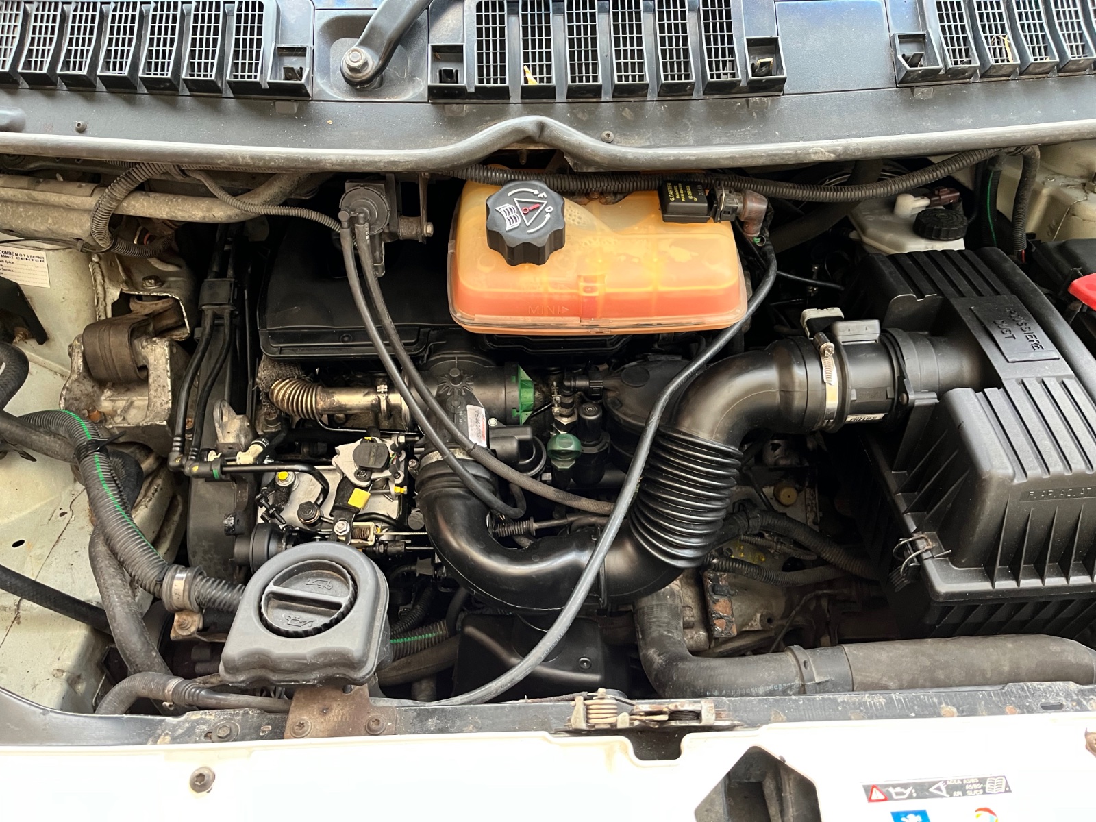

Yes is a DW8 from the pictures. Sorry bolt34 didn't see you'd already confirmed that (on page 2)moizeau wrote: 15 Oct 2022, 20:28 I this a DW8? Does it have a wax stat? Only played with real Xud's
I'm surprised it has a MAF to be honest - I don't recall one on my dad's previous DW8 206
Matt

Hi Matt, just to clear up a little confusion..
I have kind of hijacked this topic from Doggone1 who started this post..
That’s who the first picture was posted by..
My expert is a 2005 DW8B..
Doggone1 the solenoid you see on the injection pump is the advance actuator..
You should get 12v supply to it.. does it tick when ignition is switched on??
