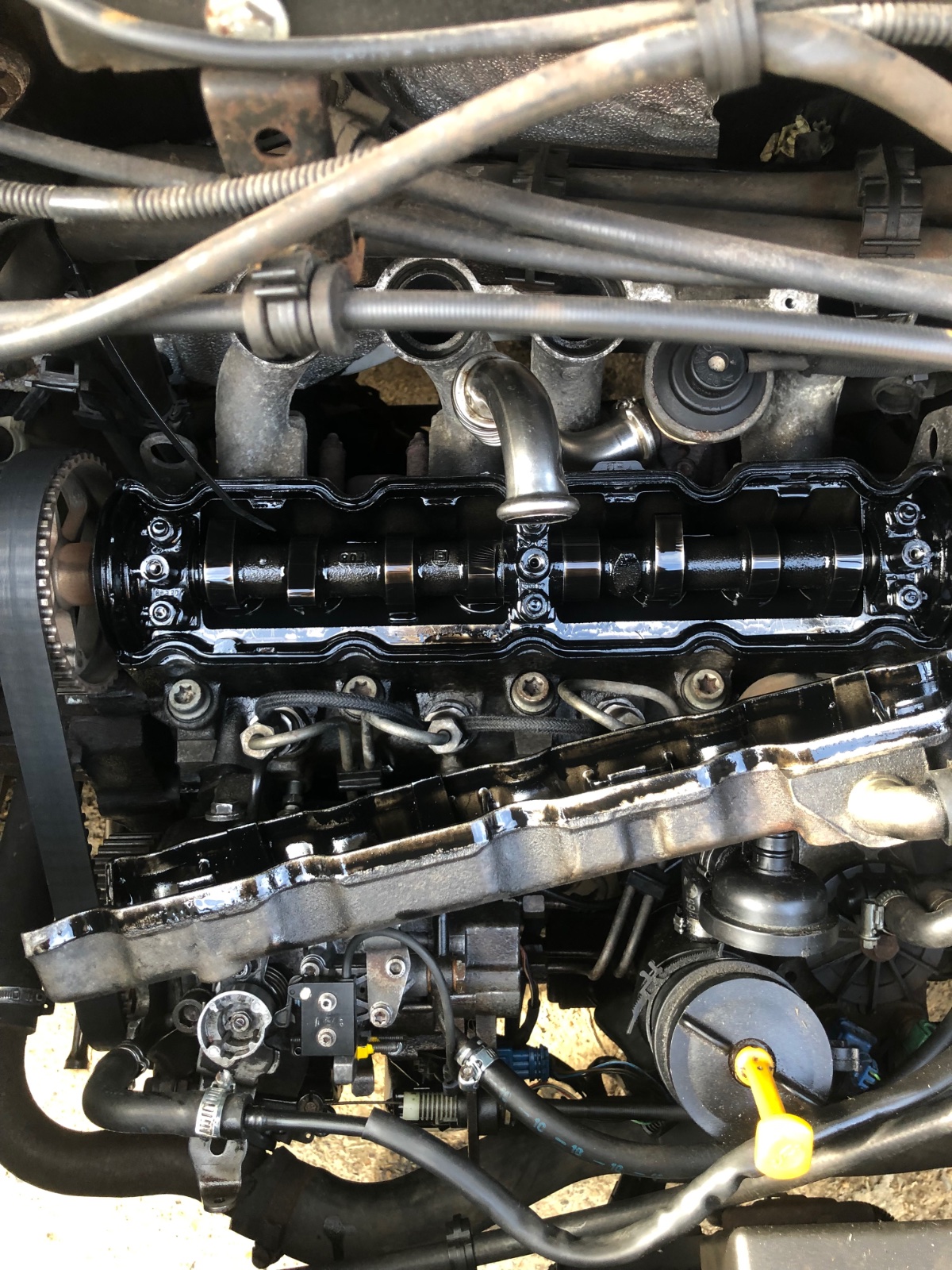

Managed to have a look at it today I’ve taken a pic of the camshaft with the flywheel pinned and pump and cam locked I think no1 cylinder is flywheel end this appears to be on the rock with it timed and cylinder camshaft end appears to be on compression I’ve attached a pic do you think it looks correct
