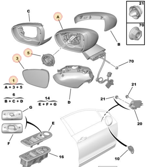

Ok, thanks for your Forum donation. Here are the part numbers for wing mirrors:
Item (1)
Left: Complete Mirror, part: 8153SR, £872.88
Right: Complete Mirror, part: 8153SL, £872.88
This is the Mirror itself (A), the Mirror Glass (3) and the Mirror Position Motor (5).
The above are UK prices direct from Citroen, VAT inclusive, so the equivalent in your country.
Any other parts you require in future, just pop your request up in the Official Parts Thread, link below, but please note that is only for parts requests, not technical queries:
viewtopic.php?t=69962
