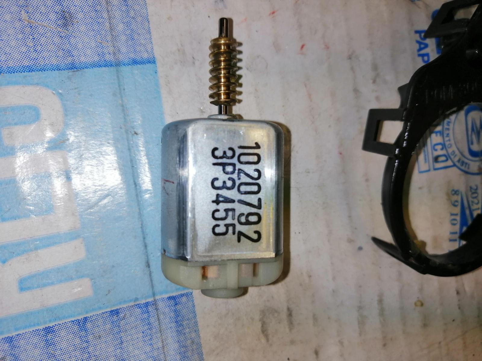

marsalek
Posts: 171
Joined: 21 May 2003, 16:37
x 19
Re: C5 X7 Folding Wing Mirror Motor Replacement
Unread post by marsalek »
On Aliexpress search for a motor 1020792. This one was on my C5 III X7 from yr. 2013. At least in my case the rest looked quite robust and I would again change only the bare motor. Given the price, it is a good idea to have one at hand. In the picture you see the original one. Probably the brushes were KO. You can even buy on Ali only the plastic cap with the brushes....
