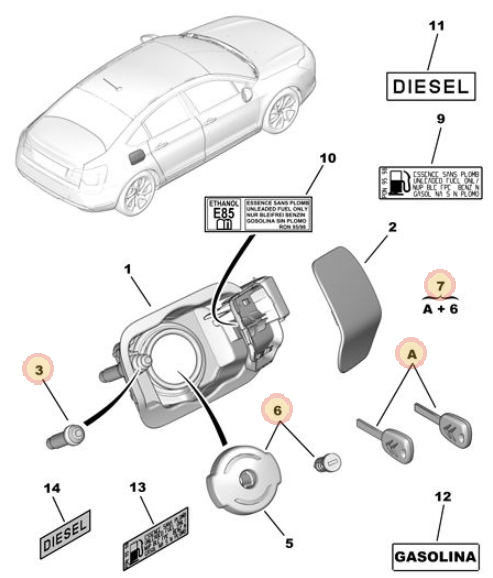

The fact that the warning concerning the cap not being connected is possibly an electrical fault in the harness between the cap and the fuel tank or the magnets in the cap.
Citroen supply a replacement cap with a random combination lock and the key for it, shown as:
Item (7), part: 1508W3, £114.60
Or you can have one without a barrel / lock, part: 1508H7, £58.85
Item (3), the actual contact switch (included for completeness) is part: 649071, £18.44
Of course UK Sterling inc. 20% VAT, direct from Citroen.
So I would first get the fuel cap issue sorted. I suspect the previous owner had disconnected it to avoid MOT failure (or NCT / Equivalent test) as that would of thrown a light up.

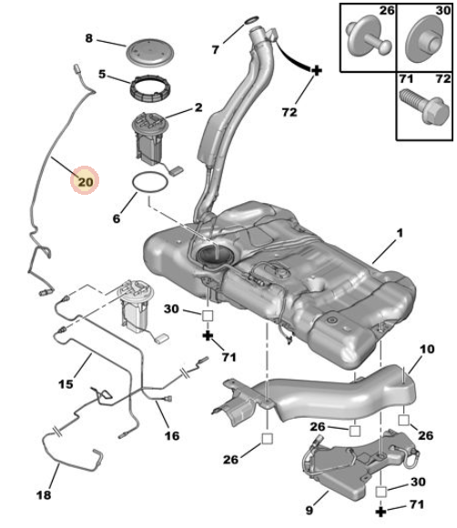

Here's the diagram for the harness itself:
Item (20), part: 6534PF, but no longer available from Citroen. But you can use the part number to find a second hand one.
