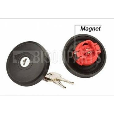

One fairly common problem is the magnets in the cap fall out, something you can easily check yourself.

Stupid question how do i check magnets? and if it is that can magnets be supplied and fitted or is it a new filler cap?

just open the lid and look inside there should be two small magnets opposite each other at the edge.Tim1968 wrote: 19 Aug 2022, 17:04 Cheers for the quick response.

Cheers. I thought that would be the answer. I've had a look and they are there.
