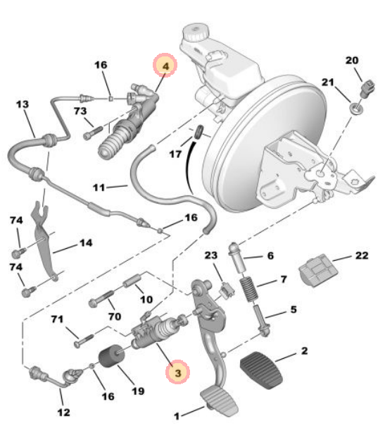

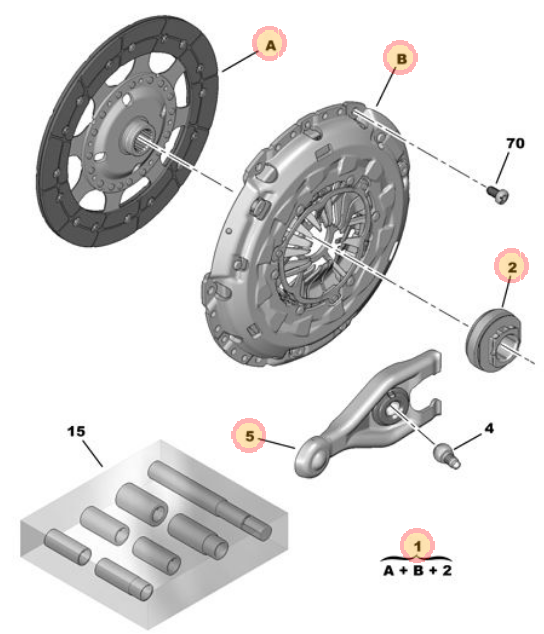

Ok so here is the diagram for the Master and Slave clutch cylinders:
Clutch Cylinders
(3) is the Master Cylinder, Part: 218283, £108.29
(4) is the Slave Cylinder, Part: 2182Y8, £72.22
Clutch Kit
(1) OEM Part: 1611271880, £553.13
Exchange Clutch Kit Part: 2051R4, £289.90
(5) Clutch Fork Part: 9808513380, £56.28
Dual Mass Flywheel
(11) OEM Part: 9800982980, £797.24
Reconditioned DMF Part: 1613939080, £478.02
(13) DMF XHead Lock bolts part: 053754 £1.28 each (you need 8 of these).
All these prices are direct from Citroen UK of course and include our VAT @ 20%. With these part numbers it should help you source the correct parts using the OEM part numbers.

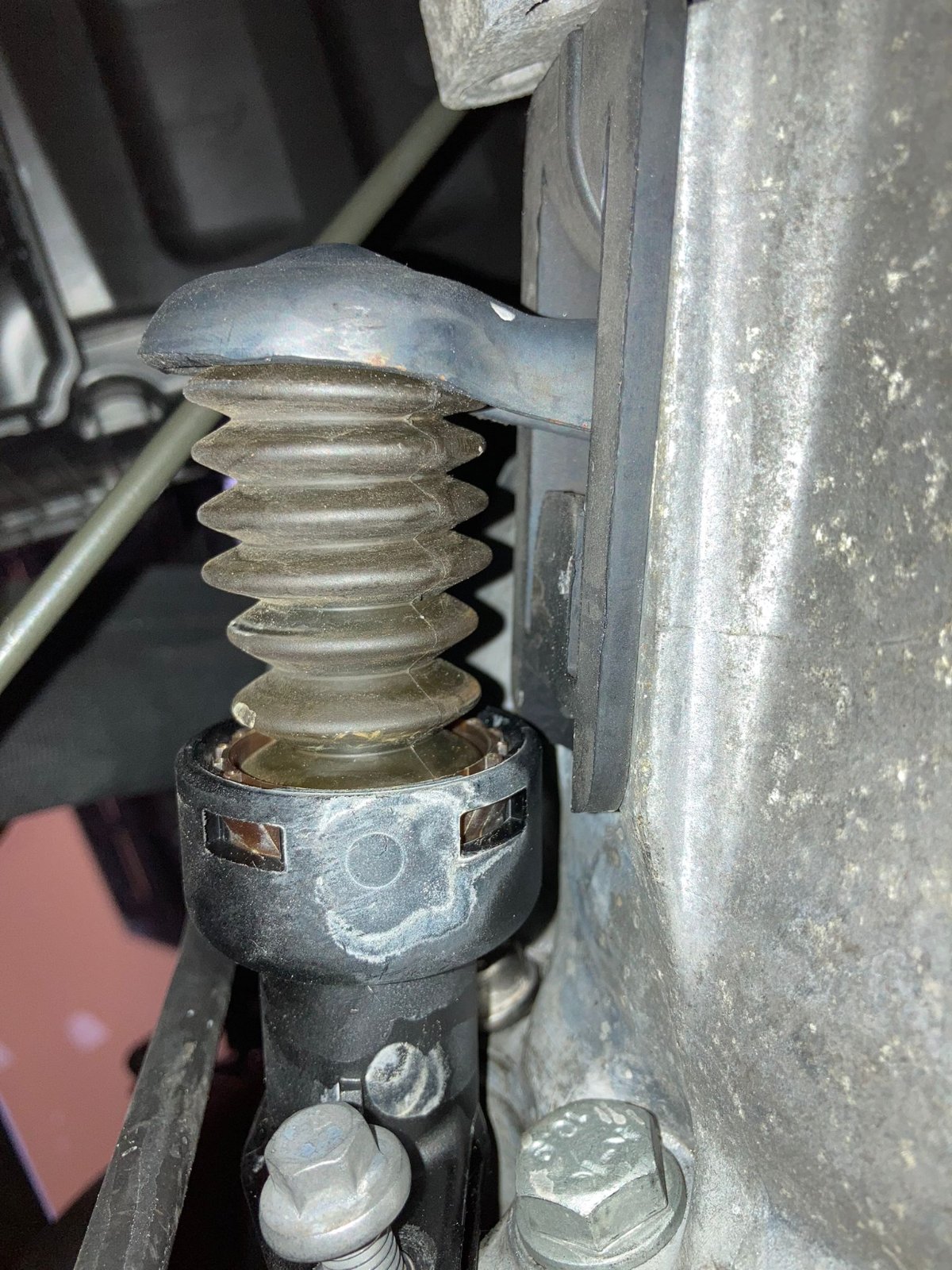

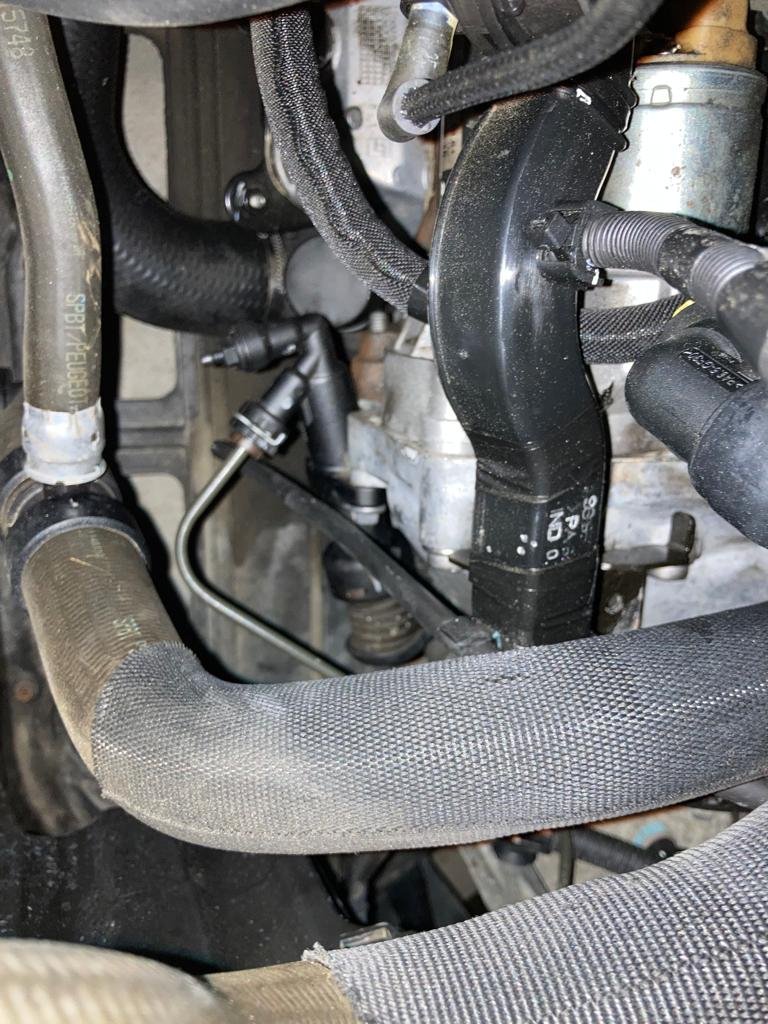

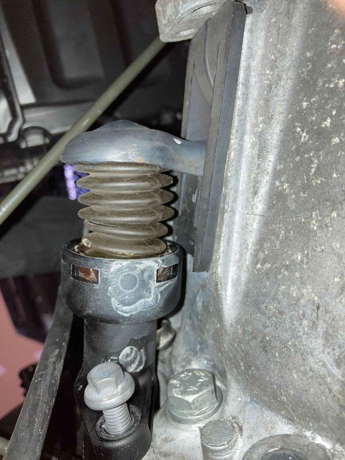

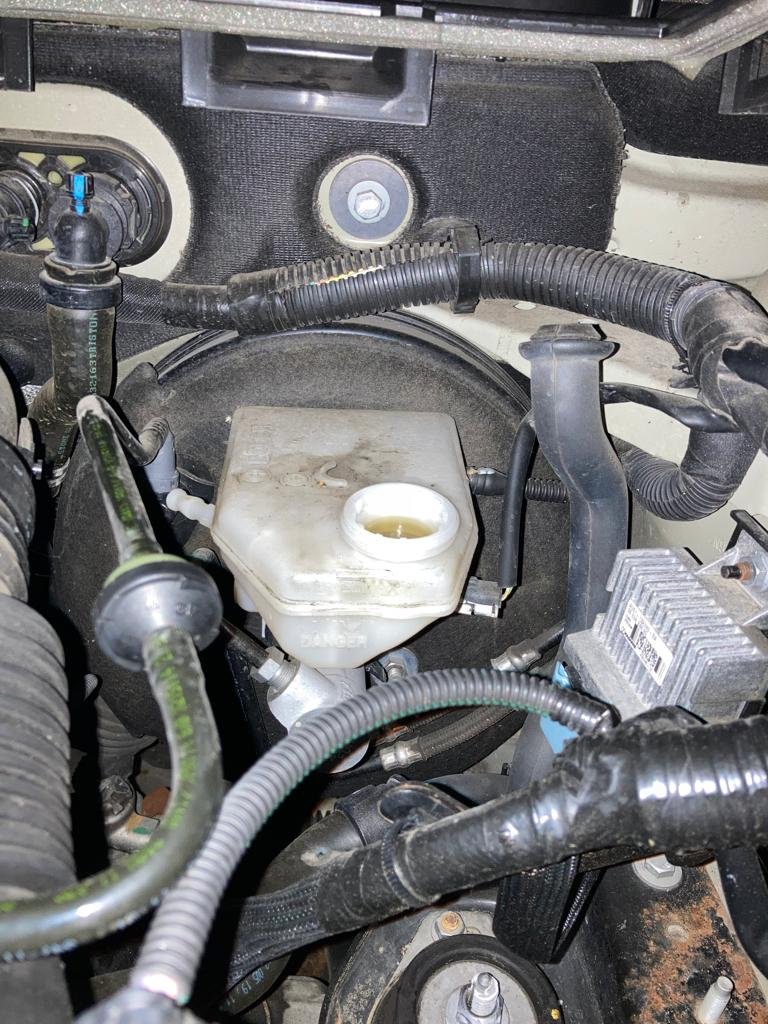

Ok guys , back to the job at hand - finally managed to get herself to help (a bit)... I do believe you're correct and the problem is hydraulic - if for no other reason than the brake fluid reservoir fluid level is significantly over the max line indication on the reservoir.
We had a go at bleeding :
  • first by taking off the reservoir lid and pumping the clutch
    next by manually moving the slave cylinder back and forth
I'm going to try to bleed the system next by the bleed valve on the slave cylinder.
The car has been inside in a perfectly dry garage for nearly 2 weeks - there is certainly no leaks of any kind that I can tell.
Finally when I started her today I could easily engage any gear - have to say that I still am pretty uncomfortable with the sponginess of the clutch - my other car's clutch pedal is far more firm.
It is very surprising to me however that the brakes are solid as a rock - I guess that simply means that the air pockets are solely in the clutch system.
Again thanks for all the help and suggestions -here's some pics for reference.
slave cylinder at rest - very clean
brake fluid reservoir - overfull

Ok quick update on the bleeding - had the helper put his foot on the clutch and opened the bleed valve on the slave - we did get a couple of small bubbles but very little. What surprised me was he had to pull the clutch pedal back up - could the problem then be with the master cylinder or the line from the reservoir to the master cylinder?
Thanks again.
Posts: 3326
Joined: 11 May 2022, 19:54
x 1077
Re: 2012 Citroen C8 2.0 Hdi FAP 165 Clutch ???
Unread post by Rp0thejester »
I don't know what other car you have but in my experience each clutch is different. I had a T reg Xsara which I always stalled but my work van was a transit and never stalled it. At this point I would say master cylinder.

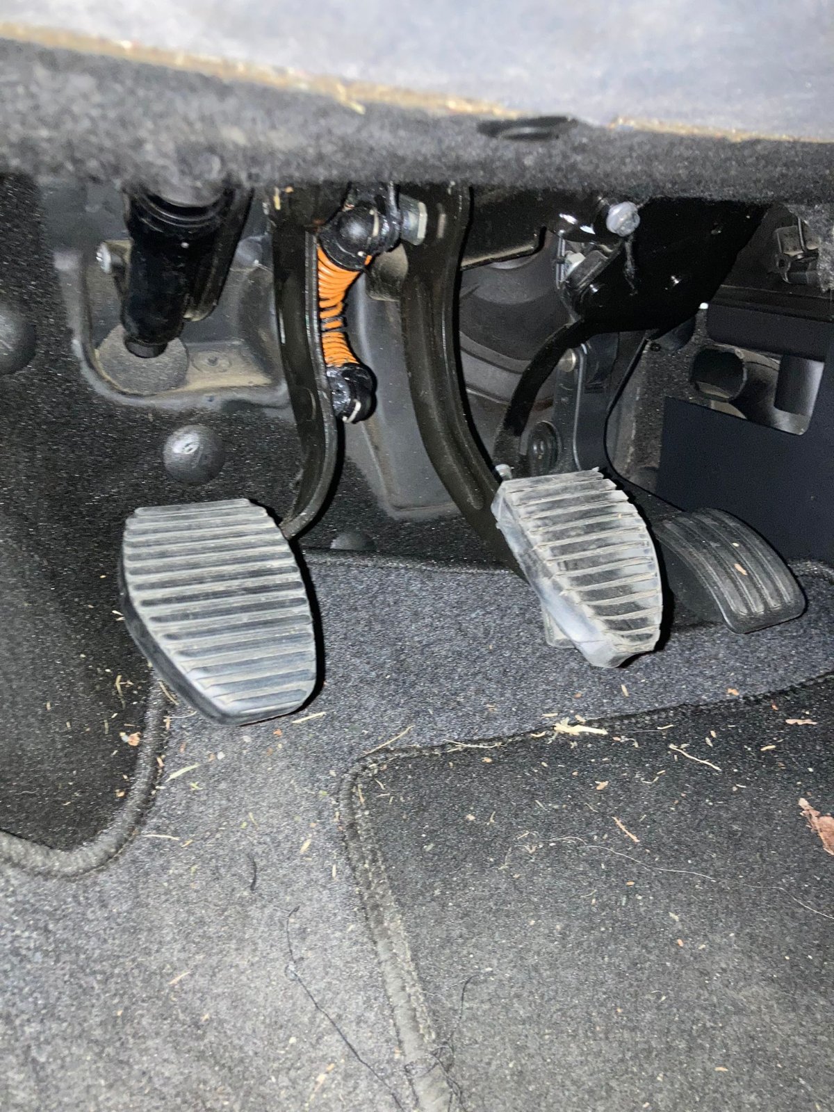

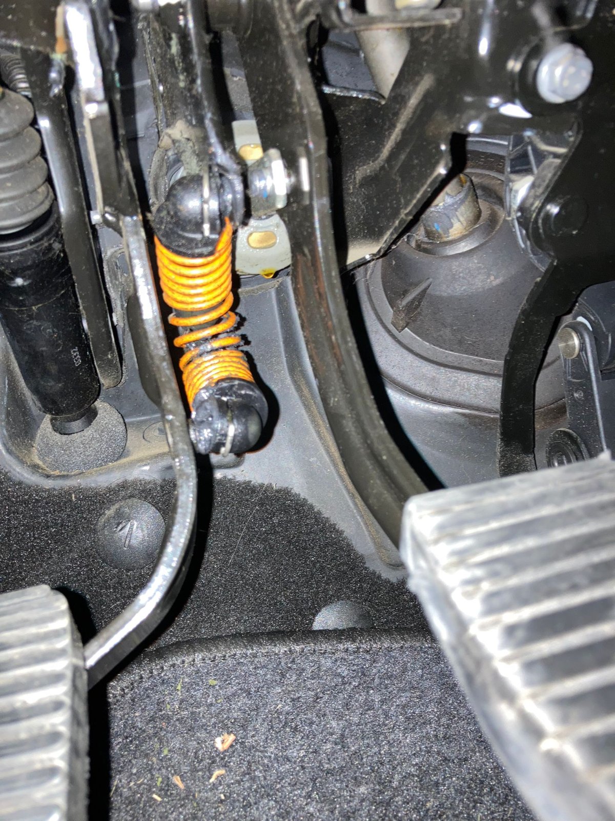

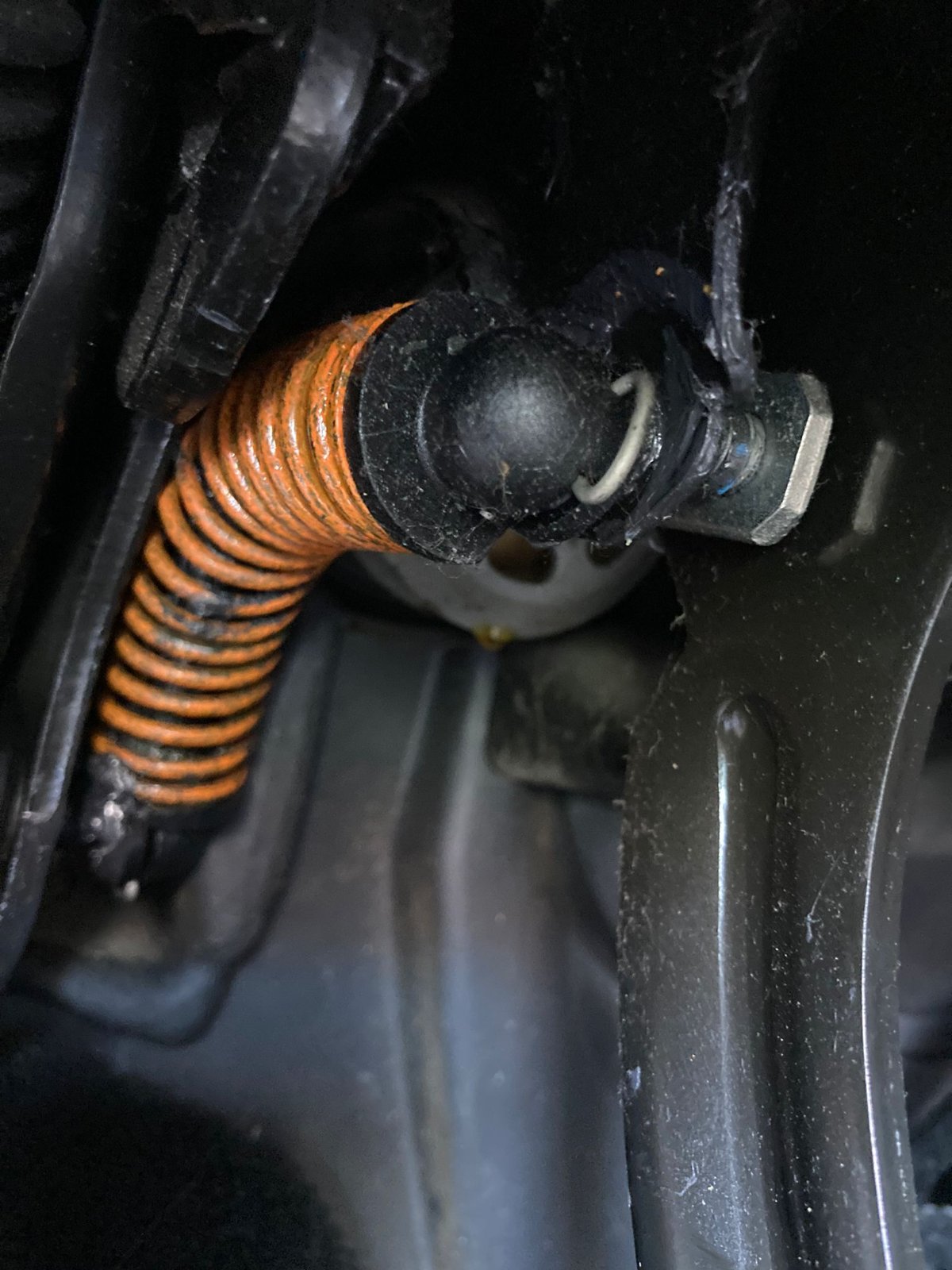

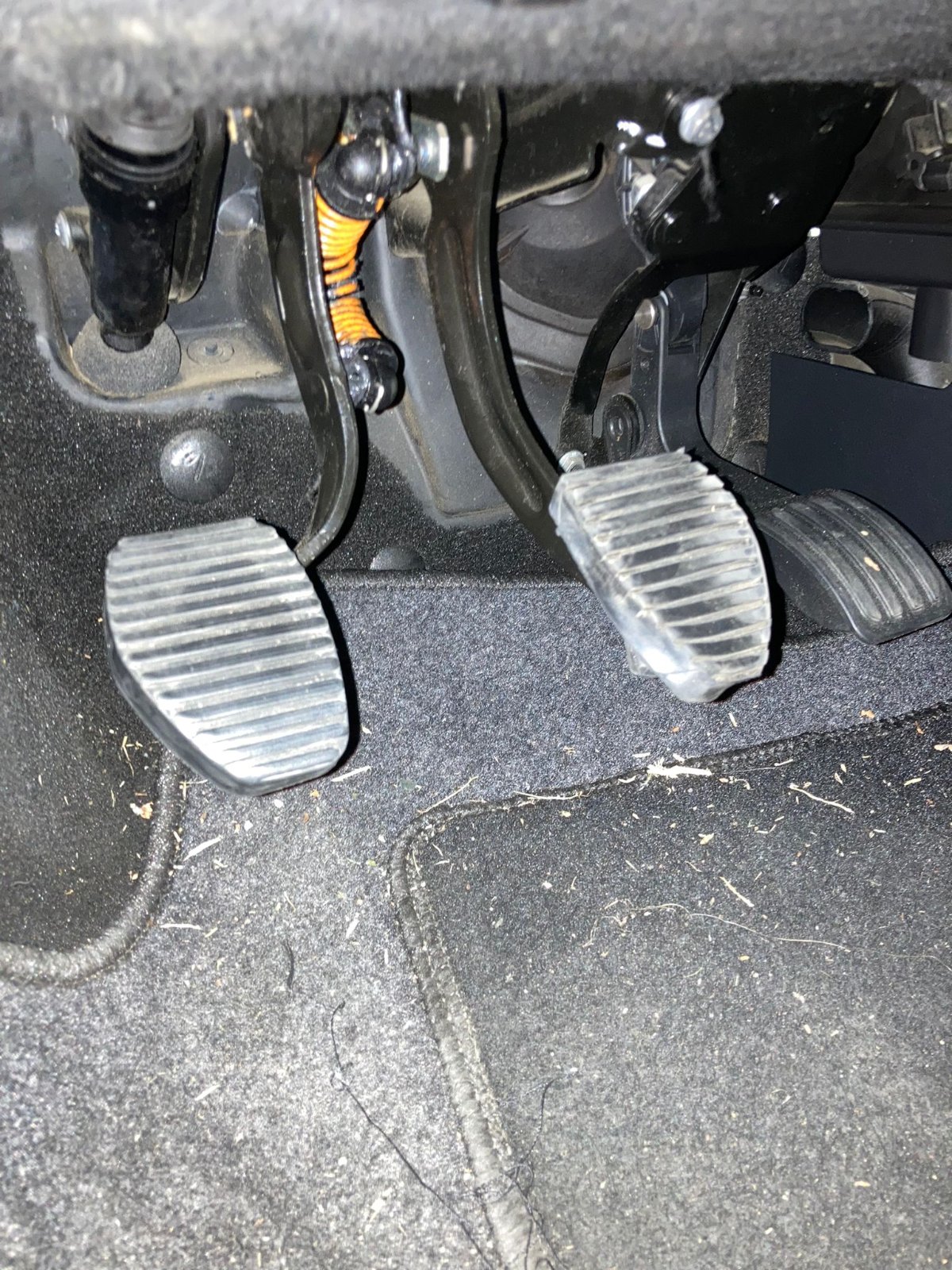

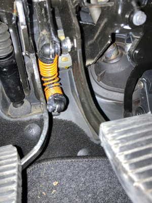

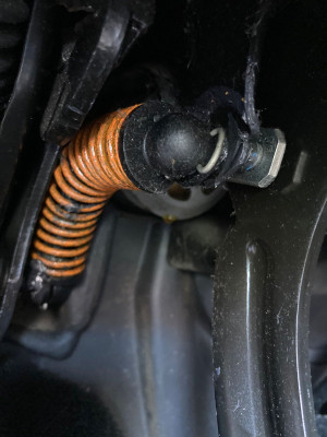

One more thing - which other C8 owners/folks might be able to help me with - if I look at Marc's picture of the clutch cylinder above - part number 7 - the spring - looks like it should operate linearly - if I look at it in my C8 it looks like a horseshoe when no pressure is applied to the pedal. Don't know why I didnt spot that before but could that be it? Its well greased mind. Thanks again. P.S. I will swap out the slave in the next few days and report back unless someone tells me I am a fool and of course its the spring.

Some pics of the spring configuration and pedal position
wheeler
Posts: 7932
Joined: 21 Sep 2002, 19:07
x 1056
Unread post by wheeler »
Yes that spring is definitely not right, the spring should always be straight no matter where it is in it's travel. Maybe parts 5 or 6 broken?
I dont think i have ever noticed one being yellow either, maybe not even the right spring? Maybe somone else with a C8 could check the colour of their spring?

thanks a lot wheeler -it could be my eyes but I see that colour as orange. Marc could you please comment and/provide part numbers for items 5, 6 & 7?

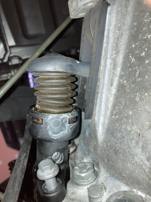

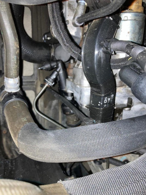

After taking away the floor pan I got some nice shots of the slave cylinder at rest and with full pressure on the pedal. The distance travelled is 14mm - so this explains fully the problem - now need to find the source.
Also got a shot of the spring - this time with pressure on the pedal.
Quick couple of questions :
Should I unbolt the slave cylinder before I remove the circlip on the brake fluid line or rather the other way around ?
When installing the slave should I try to depress it as much as possible before clipping in the brake fluid line to reduce the amount of air or it doesnt matter?
