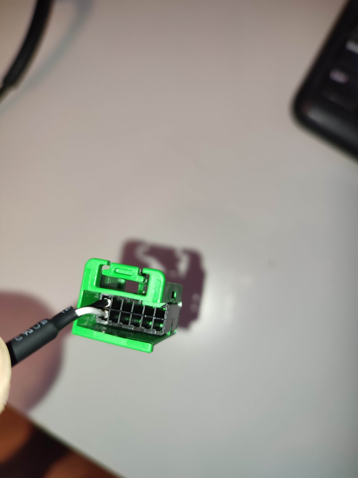

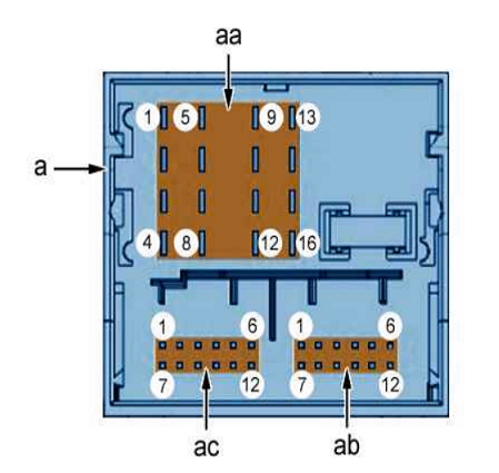

I just received cable for microphone from the ebay but I am little confused about pinout. Is this proper pin positions for it?
I think that I found someone on the net 3 i 9 positions for microphone and 1-7 for aux. Thanks.
Btw, I am still waiting for other usb cable.

- Posts: 37746
- x 5808
Re: Peugeot 308 (2008) RD4 -> RD45
RD45
Pin 3 Microphone Earth
Pin 9 Microphone Positive
Block 'ac'Pin 3 Microphone Earth

- Posts: 37746
- x 5808
Here you go:
"ab" is not used.
"ac" Natural 12-way connector
"aa" 16-way black connector
"ab" is not used.
Channel number | Allocation of channels of connector |
1 | Channel not connected |
2 | Channel not connected |
3 | Audio/telephone microphone earth input |
4 | Right-hand audio auxiliary |
5 | Channel not connected |
6 | Channel not connected |
7 | Channel not connected |
8 | Channel not connected |
9 | Audio/telephone microphone signal positive input |
10 | Left-hand audio auxiliary |
11 | Audio earth |
12 | Channel not connected |
1 | Rear right speaker positive control |
2 | Front right speaker positive control |
3 | Front left speaker positive control |
4 | Rear left speaker positive control |
5 | Rear right speaker negative control |
6 | Front right speaker negative control |
7 | Front left speaker negative control |
8 | Rear left speaker negative control |
9 | Channel not connected |
10 | Comfort CAN High |
11 | Channel not connected |
12 | Service battery positive / Audio system accessories positive supply |
13 | Comfort CAN Low |
14 | Channel not connected |
15 | "accessories positive" supply |
16 | Earth |

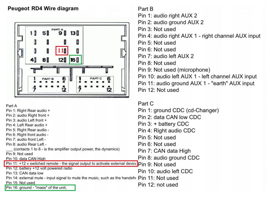

Uh, what about this? I found on the net. Is this the correct description?
- Posts: 37746
- x 5808
No, that's for an RD4 and as you're fitting an RD45 that's what I've put up as they are different.

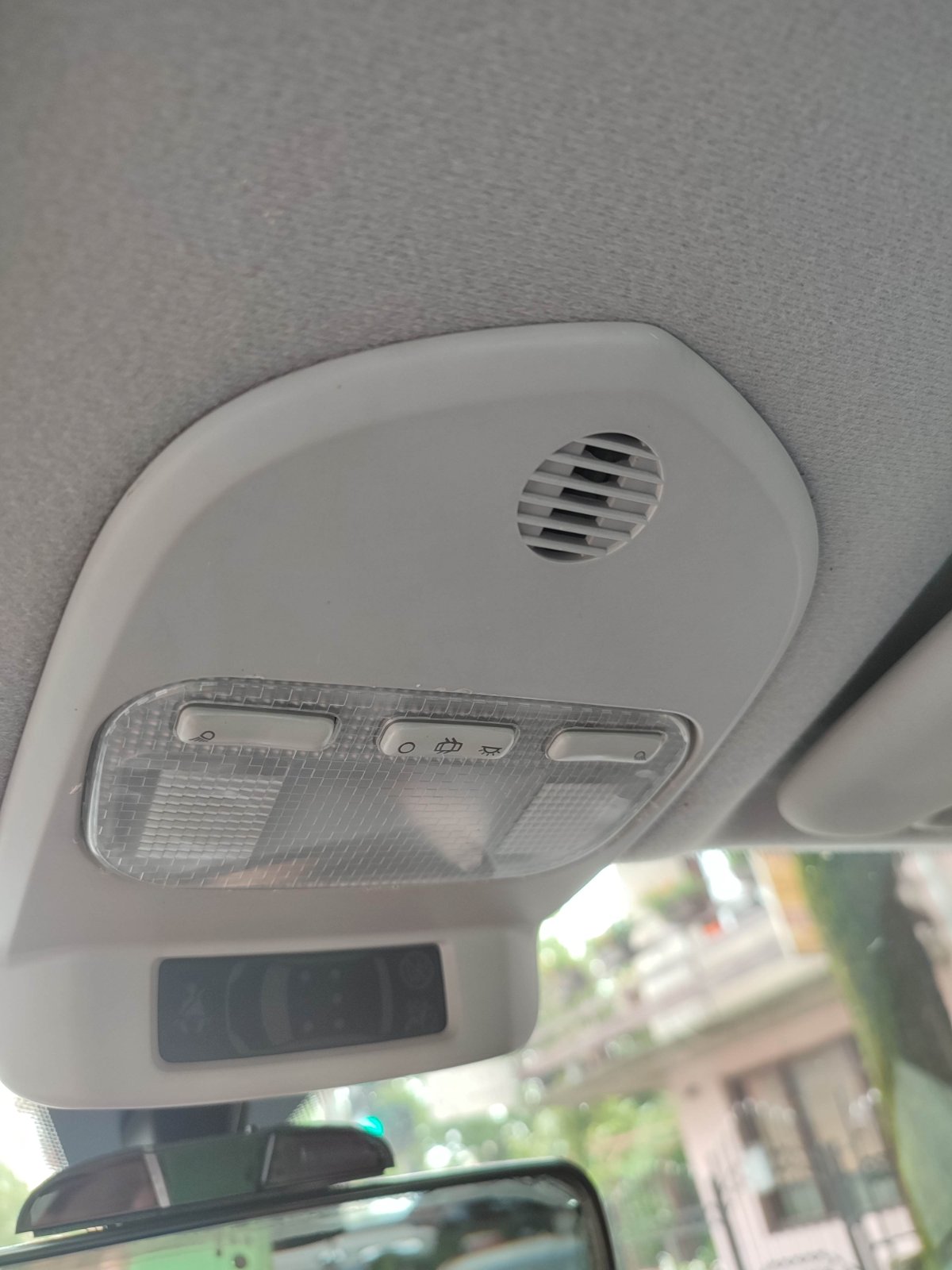

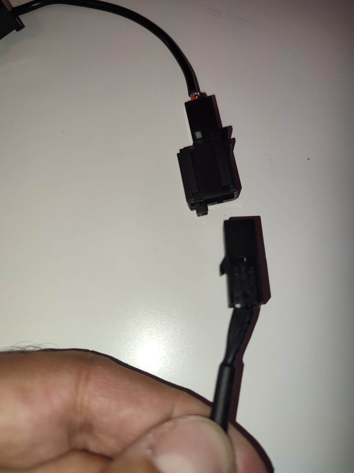

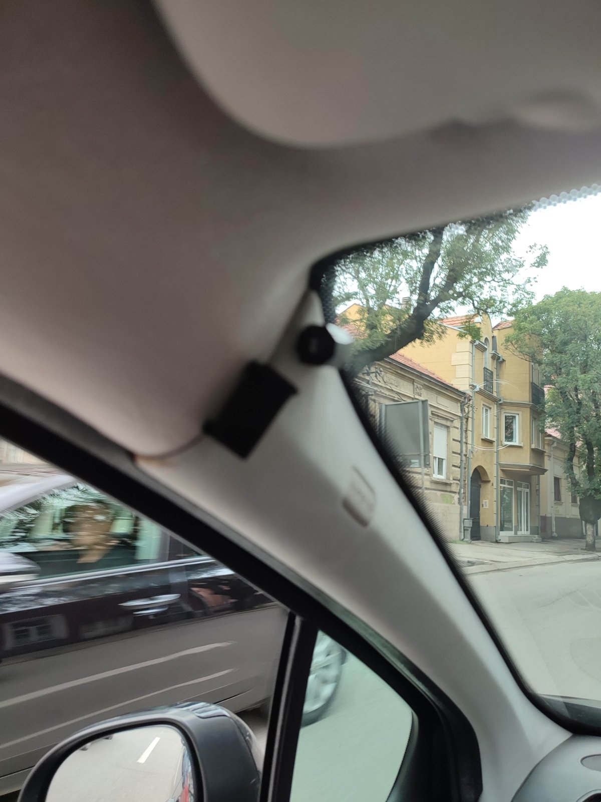

Btw, what is a proper place for microphone? I put it on the left side but after that I saw that it could be in the middle of the roof. This is a placeholder for it?
See photos ->
I had a problem with one broken pin, it was broke during moving to other position.
I am waiting for other usb cable to complete action
See photos ->
- Posts: 37746
- x 5808
That's where the official microphone is, but you may find it a job because often these are connected to the vehicle loom via a ribbon cable and trying to find out where it comes out can be almost impossible, so better to fit your own. You can generally fit one in the recess and wire it directly into the connector or keep your current setup.

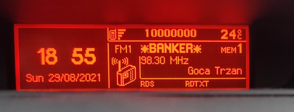

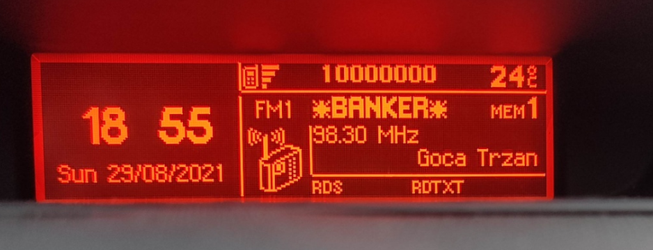

Question-related to USB: After adding new songs, the order is not correct, seems like is ordering by date instead of the name of the song.
Another issue is with BT. After starting the car, the radio was playing music but I was not able to change the source or turn off the radio until I turn off BT on my phone. BT connection made the radio freeze. Yesterday, it happened twice with some strange "10000000" on the top of the screen (attachment)
