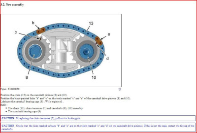

Timing the belt is easy enough, pin in the crank and cam sprocket, there's also one in the pump, but it might not be critical. Not sure about the chain, I'll see what I can find.

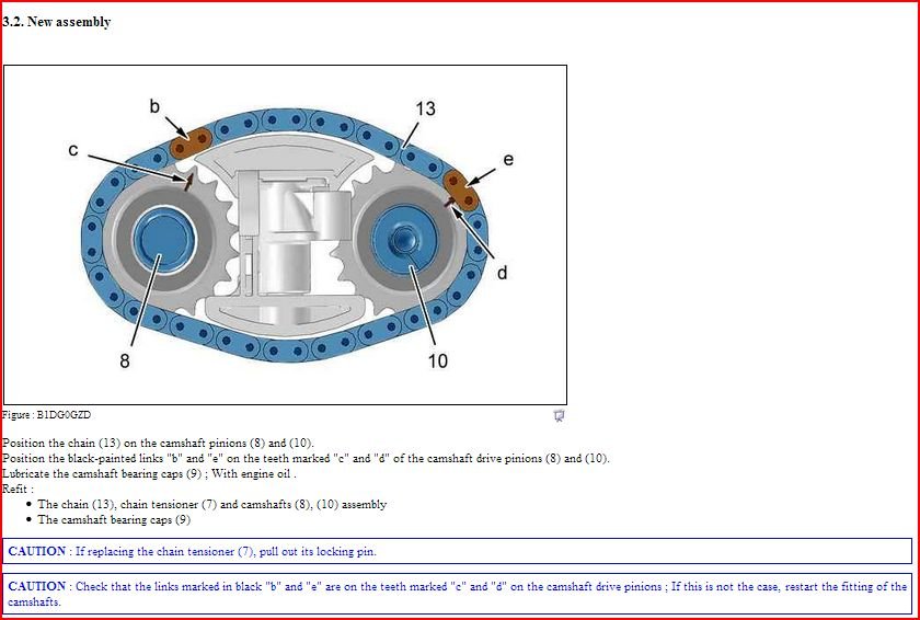

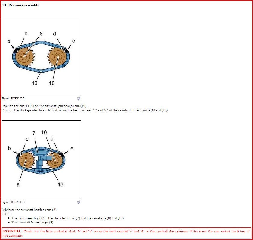

As long as you count the chain link pins between the two cam sprocket marks (from memory should be 12 pins, not links, but suggest double check) and pin the cam sprocket correctly as suggested then it will all align. Re fuel pump it’s a constant pressure unit so timing not critical but as it has a pinning hole I pinned it with the cam and crank sprockets. Pinning the crank sprocket (it’s actually the reluctor ring that has the timing hole) should put the piston halfway down the bore on the downstroke.

2 sets of instructions seem to be given, depending on whether it's 'previous' or 'new' assembly. Doesn't say what the difference is however... hopefully you still have the original chain and can count the links between the markers to work out which to apply!

I replaced the timing chain & tensioner and it is very pretty with coloured links :luv:
It's fitted to its case and awaits fitting... So I'll check on the marks and make sure it's good to go.
