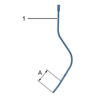

Repair
"A" = 6 cm.
Remove the dipstick guide tube (1).
Cut the bottom of the dipstick guide tube (1) according to the dimension "A".
Refit the dipstick guide tube (1).
Correct the quantity of engine oil.
Erase the fault codes.
