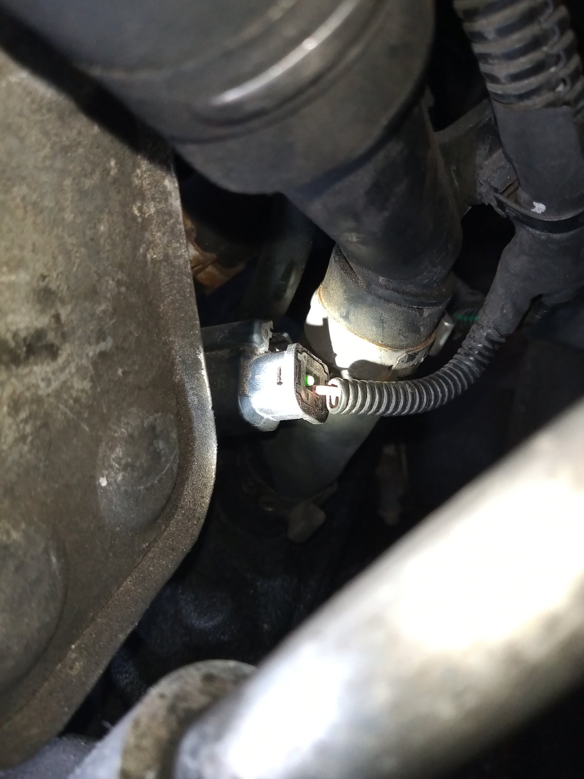

I get the invalid oil level on ignition position every time, car was low on oil when I collected it. Did a full service on it and it took over 6 litres of oil to get it just over the minimum level on the dipstick and I didn't want to add more as the book states 5.5 litres.
Found out the location of the oil level sensor to try and unplug it to clean the contacts and I see there is only one wire going to the plug as shown in photo. Maybe it only takes one wire I don't know but I'd like to check before buying a new sensor for £17 if that is the problem.

Oil sensor plug only a single wire

I'm still wondering about the wiring and trying to find out if there should be one or two wires going to it.

Besides Paul-R said his oil level sensor was at the back of the engine whereas mine is at the front beside the dipstick so must be a different engine?

I have just checked my C5 X7 same engine and there is only 1 wire on the plug going to the sensor. However i have a spare sensor Engine Oil Gauge 1131K6 for my C4 2.0 HDi and there are 2 pins on the sensor plug, hopefully someone can confirm the part numbers are the same.

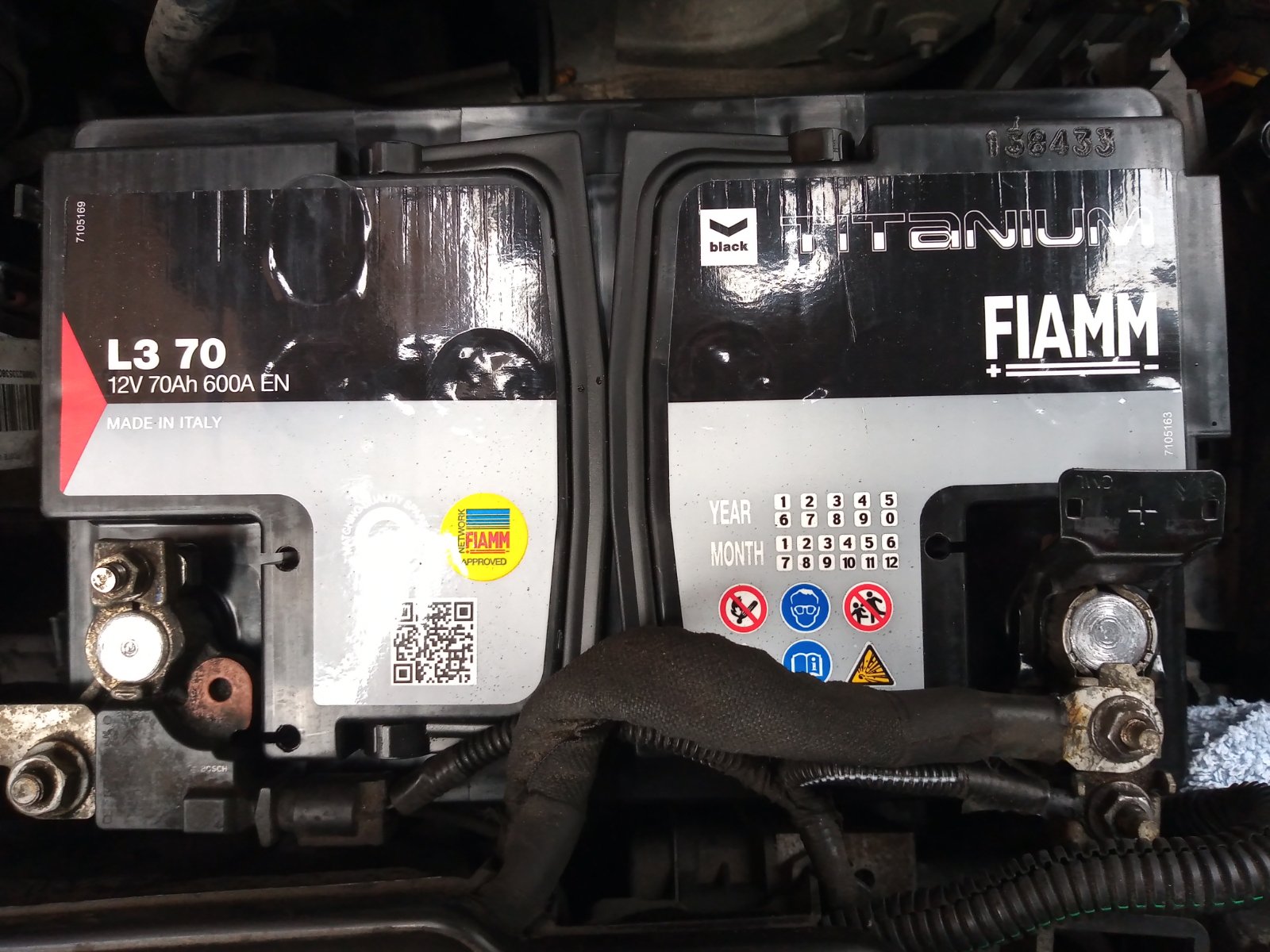

However I'm collecting a battery tomorrow, £61 is a good price for this car, 640 CCA don't know what brand but I can't keep this car for more than about a year anyway as import fees from NI into the Republic of Ireland cost over £3k

Thanks for the conformation that there is only one pin on the oil level sensor and yes I did see the part 1131K6 indeed had two pins. Single pin sensors are common as the circuit uses the sensor body and engine block as a ground.

Just fitted the new battery, was horrified to see the old battery's health indicator well suddenly turn a nice green LoL
Thanks to givemeabreak the passenger window now closes and stays closed wey hey, and I now know that holding down the lock key puts all the windows up as well as locking the doors, but why is this important information not in the Citroen manual?
Unfortunately the new battery did not solve the oil level invalid message but I didn't expect it too.
Will update when I drive it for a few days, maybe the economy mode won't come on so quick.
Hope this 70aH 600CCA is good enough for the car. The battery I took out was a 720CCA start stop even if the car isn' a start stop!
