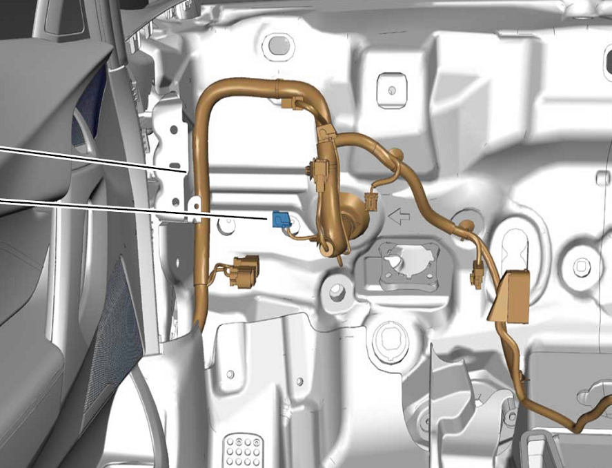

There's no replacement instructions available, so I would just locate it under the front wing somewhere, possibly behind the wheel arch protection, so unless you can see it, it could be hidden around there. Make sure you follow the BSI Reset / Battery Disconnect / Reconnect Procedure before replacing it to avoid electrical issues.

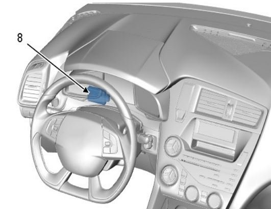

cannot find the alarm ecu at all in the glove box area. Have had it pulled apart but could not see it at all. I dont think it is behind the bsi and really did not want to disturb it at all... so if anyone has any clues?

That's the general location - they do not change. It could well be behind or up and to the side somewhere there, but that is the location. They don't make it easy to access on purpose for obvious reasons that you don't want a thief to be able to get at it easily to disable it.

ok.. to be clear... I'm in the UK. So, is it my UK glove box? or do I have to go and pull apart the UK drivers side? Just in case that was the issue!!!! In other words.. I pulled apart the left hand side of the car.. if you were sitting inside facing forward...

There's no change and the only diagram is as per my first post, and although they show this for a left hand drive vehicle these things are generally replicated exactly regardless of driving position. This includes the BSI and fuses which although tightly crammed in is also on the LHD in the same place. RHD drive models which have the glovebox there, are generally a lot more accessible. Here the image is show for location using a LHD model - there is no RHD diagram which tells you it is in the same place. If not located near the BSI then it will be behind the dash, maybe above and the right of the BSI and may need part of the fascia removing to locate it.

Now, many of you may have remembered me asking for the modules location. I pulled the passenger side apart (UK car) and could not find anything. I had a very little look around the drivers side, not up to the display.. but I cannot find it still. Has anyone got any further pointers? the car is currently disconnected from the battery and I am waiting for the siren (which i replaced last time but hasnt fixed it obvs..) to run out of battery...

It's designed not to be easy to get to. It's the little box in blue.
