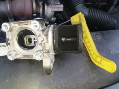

I took the EGR off and it really doesnt look that bad.. just a bit of surface soot/carbon see pics
Any advice very much welcome

Also, on further inspection to the diagnostic, the fault - U1213 Intersystems CAN is coming from ABS, so Im hoping that by clearing the gunk under sensor it will remove this fault
Should I put back EGR and box everything else up, then clear faults to see if any faults come back? or should I be checking something else before doing this?
Any further advice very welcome!

If Im understanding correctly - I will put EGR back, box everying up, making sure the suspect plug is secured somehow and clear faults.. Then hope that no faults come back, just wasnt sure if before doing this I should be checking anything else?
