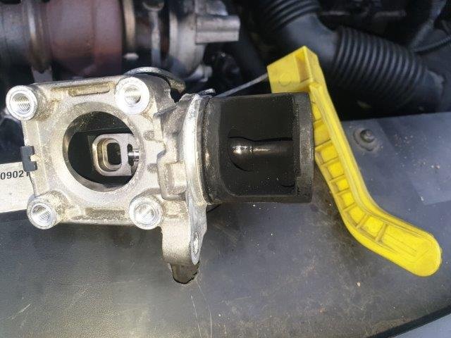

I took the EGR off and it really doesnt look that bad.. just a bit of surface soot/carbon see pics
Any advice very much welcome

Re: Berlingo Multispace 2012 Error codes P14A4, P1490, P242F
If you have the EGR off at present whilst you've been cleaning it, this will trigger some engine management faults at some point if it is not reconnected. But the pressure sensor issue needs resolving as that will trigger other conditions of course.
