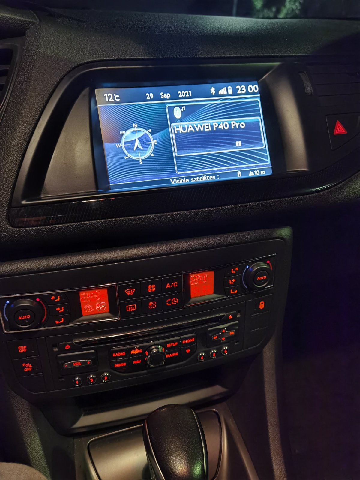

Ok. I have a question. I did a straight swap. It works, mostly. Updated the map for Scandinavia. With it it should have updated the risk areas i think. But for some reason the option for managing the risk areas is greyed out. Also, all others rt6s i've seen have the map in 3d, mine is in 2d.
Otherwise all works good. Trip computer is showing. Temp and tpms page doesnt want to, but thats maybe cause i dont have tpms and i have disabled the function with diagbox. It reacts fast, it was a sh***y job to parse the usb cable.
Maybe some tweaking with diagbox is needed? I only coded my vin..
- x 6957
Re: RNEG swap to RT5
Risk areas are separate - you can get these quite cheaply from SCDB:
https://www.scdb.info/en/plugin-peugeot-rt6/
You don't have TPMS on your vehicle, so that's why it won't display.
Map options have to be set from the navigation screen.
