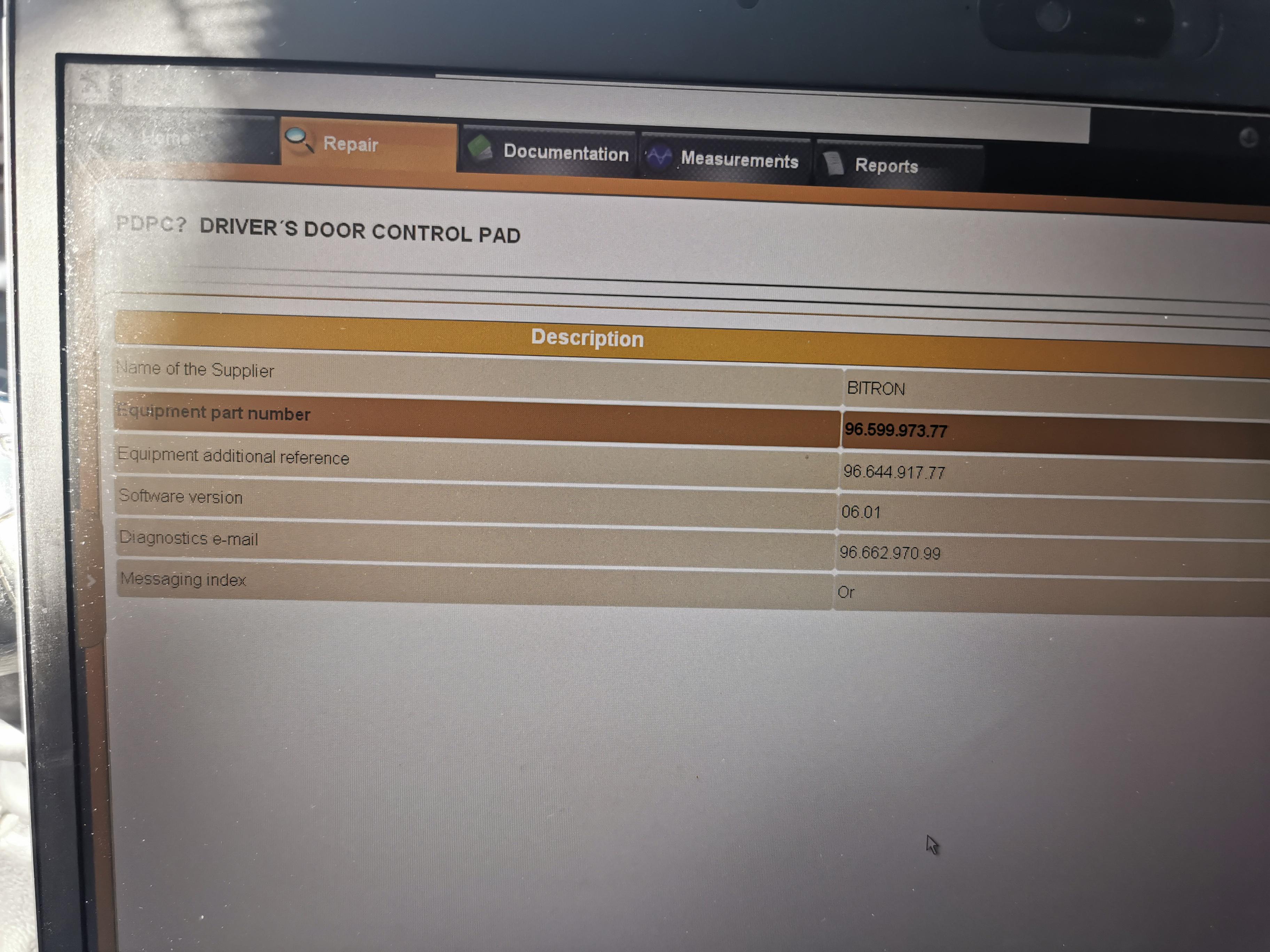

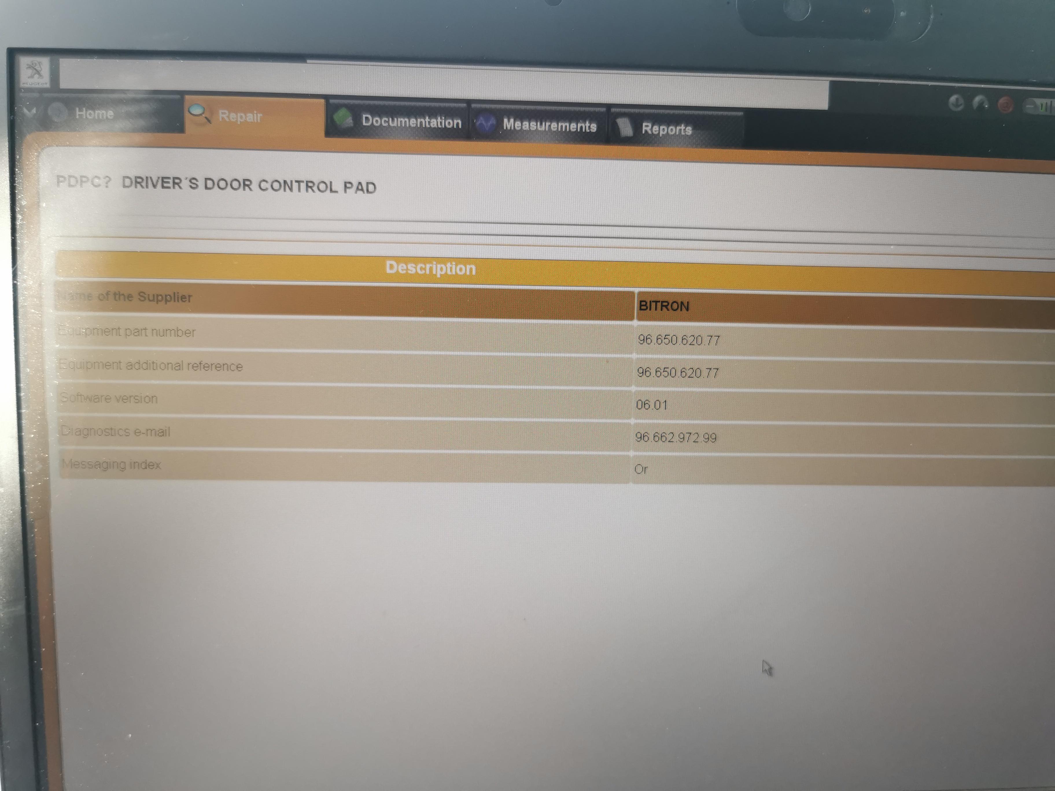

Re: 3008 MK1 powerfold mirrors retrofit
It's recognized by the Lexia:
Both pads, my original, and new one with power folding
With the new pad I can control right mirror, which is still original, so it's definitely working.
