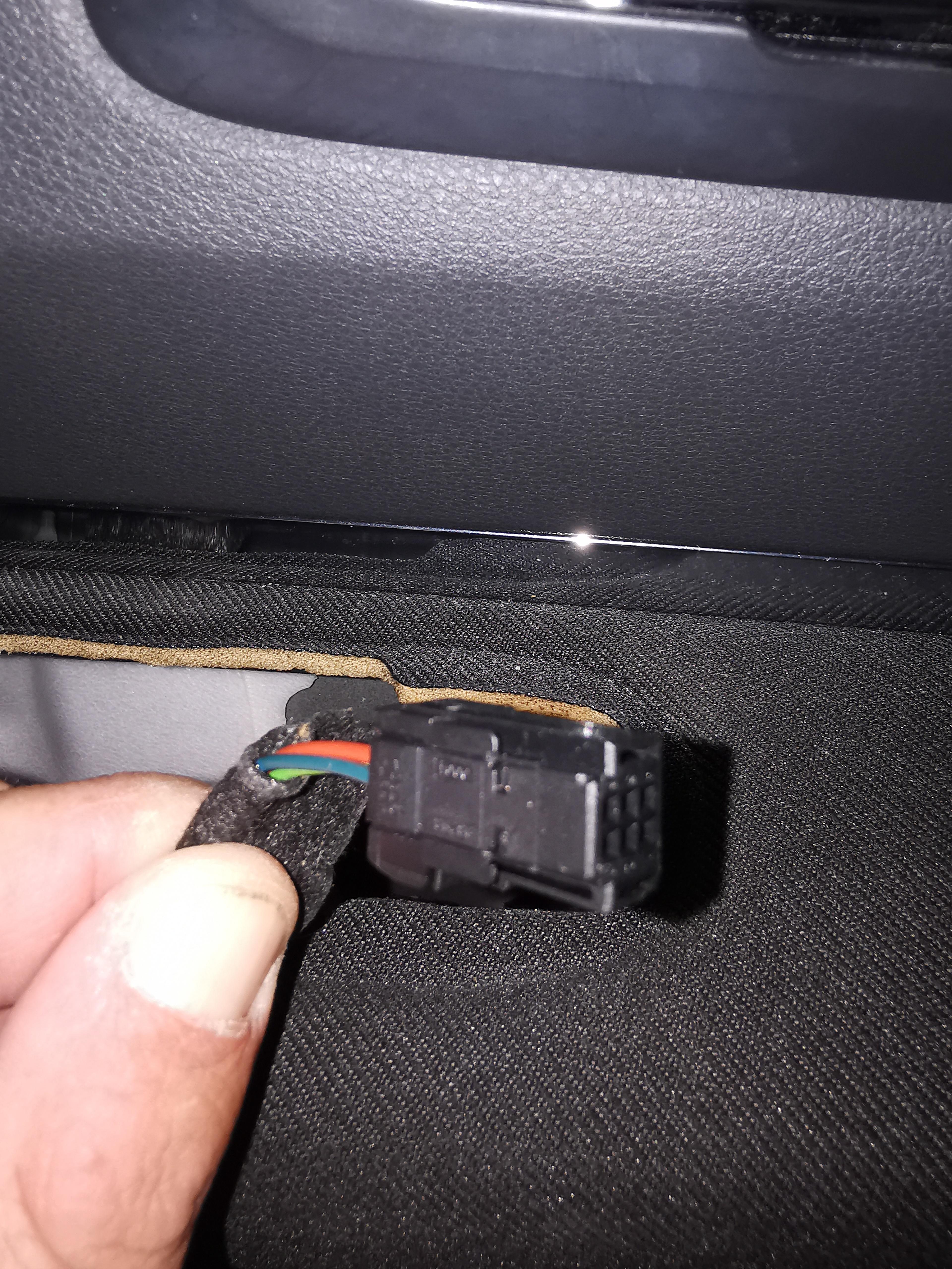

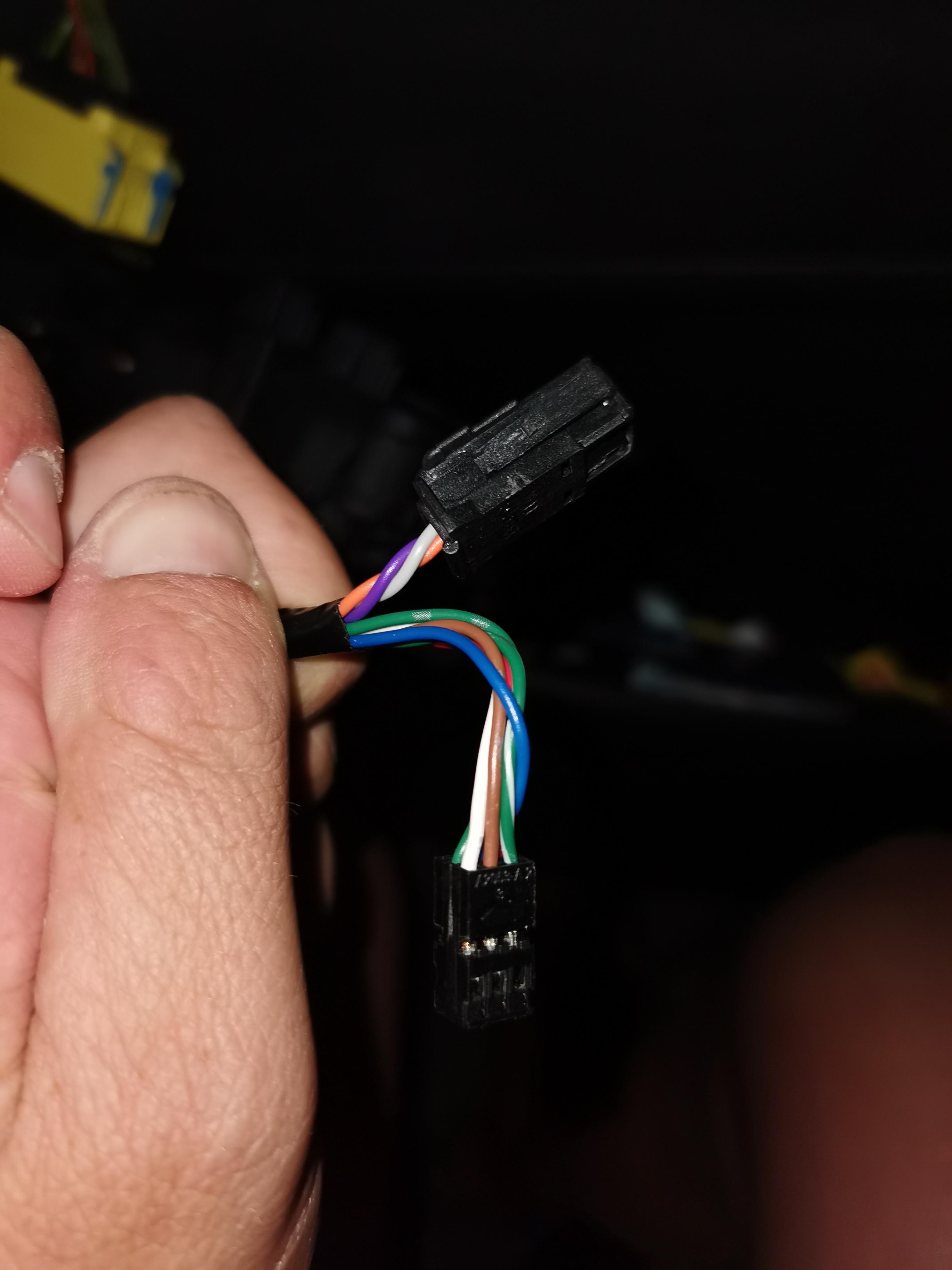

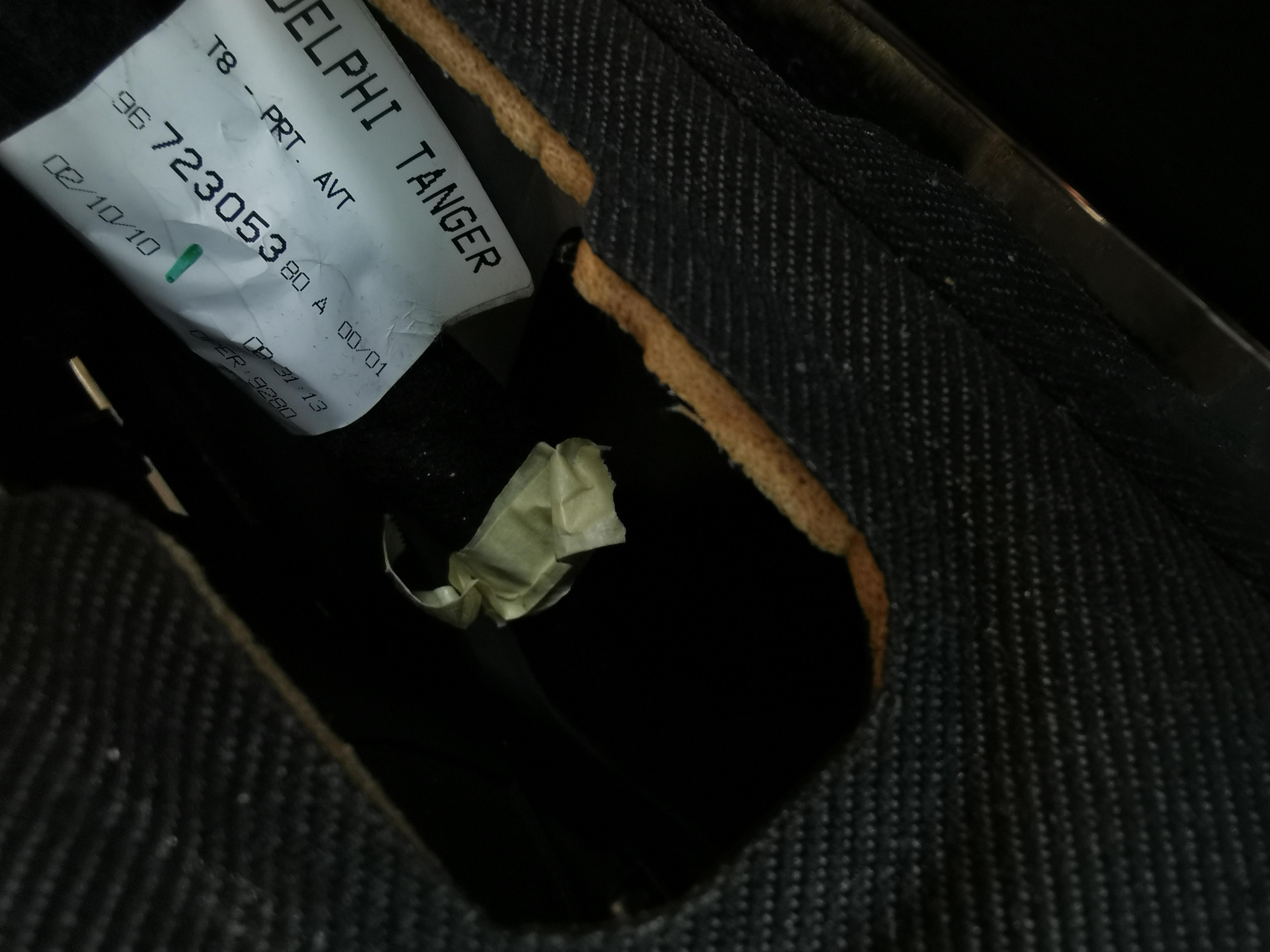

Here is my original connector, 6pin
Here is new mirror cabling, 2x6 PIN, connected to new windows/mirror switch
- x 6955
Re: 3008 MK1 powerfold mirrors retrofit
It won't work with anything you can change in the BSI!
1) The mirrors are different for the vehicle options as you now know
2) There are 2 types of electronic architecture - ordinary electric mirrors and multiplexed electric mirrors - you need the correct version for your vehicle.
3) There are different electrical harnesses in the doors depending on options - so you may not have the correct harness for the type of door control pad.

This is the door harness
So what's the easiest way to find out what I have/need.

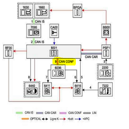

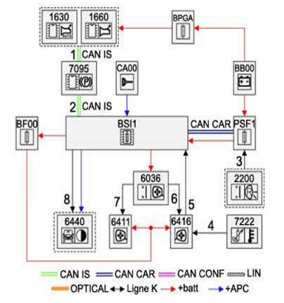

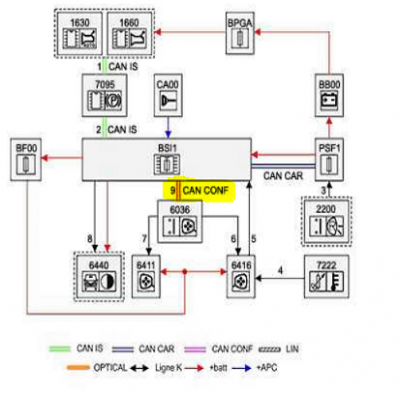

Ok, so I've checked the difference in the electric mirrors and the multiplexed version has a CAN Comfort connection to the BSI. This is an extra connection not shown on the 'ordinary mirrors' I mentioned earlier.
The new electrical door harness you have is correct for both versions after checking your VIN - so you should now have the correct harness in place.
So the Door Control Panel is the next thing to check, as this is where the additional communication is - between the door control pad and the BSI.
As you can see from the 2 images below:
So you have the incorrect door control pad - there are several versions and you need the compatible version for electric fold back mirrors with blind spot monitoring (diode) up until build date 14055 (3 May 2015). Your build date is 12407 (28 October 2010).
| Ordinary Mirrors No Multiplexed Connection from Door Control Pad (6036) to BSI | Multiplexed Mirrors Highlighted in Yellow is the Multiplexed Connection to the BSI |

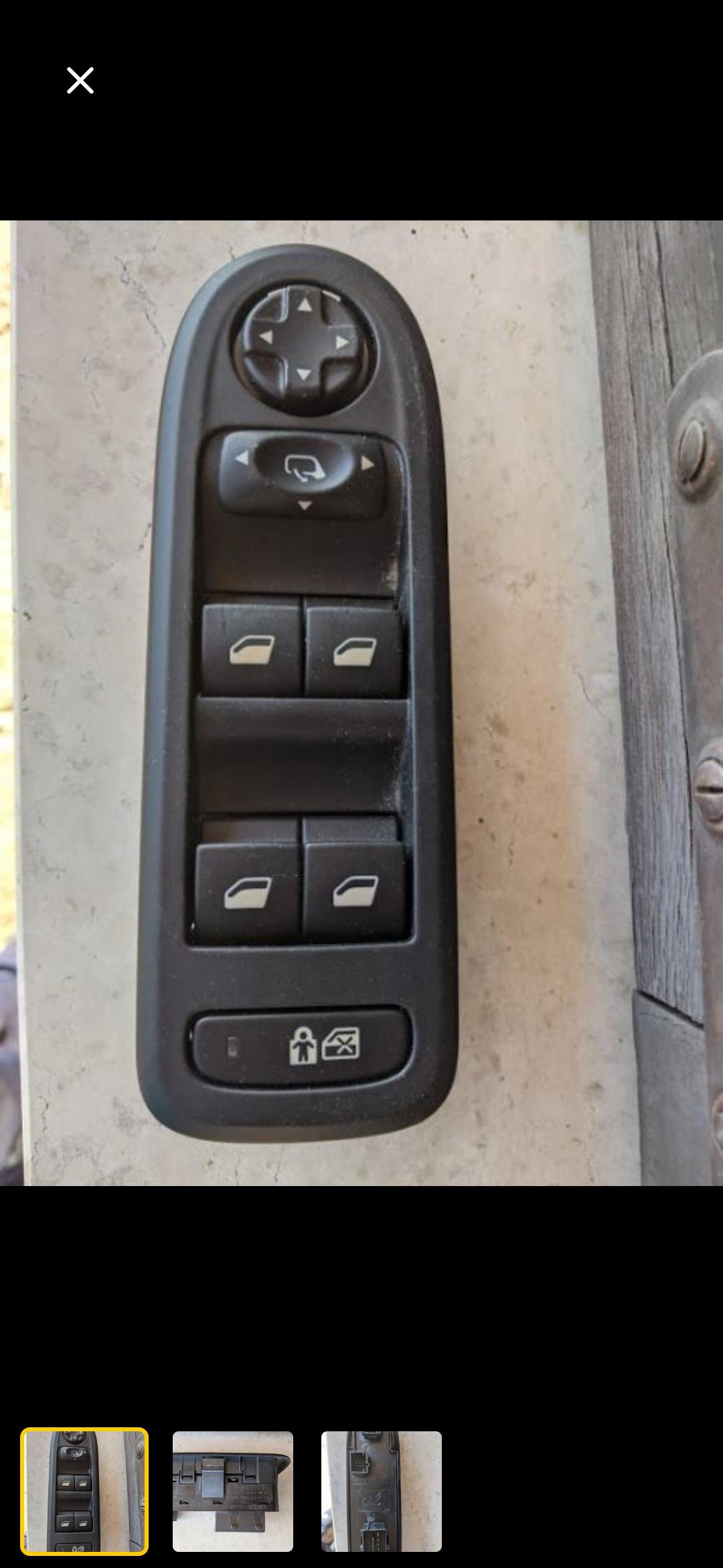

I bought pad too, with mirror folding function. And nothing work.

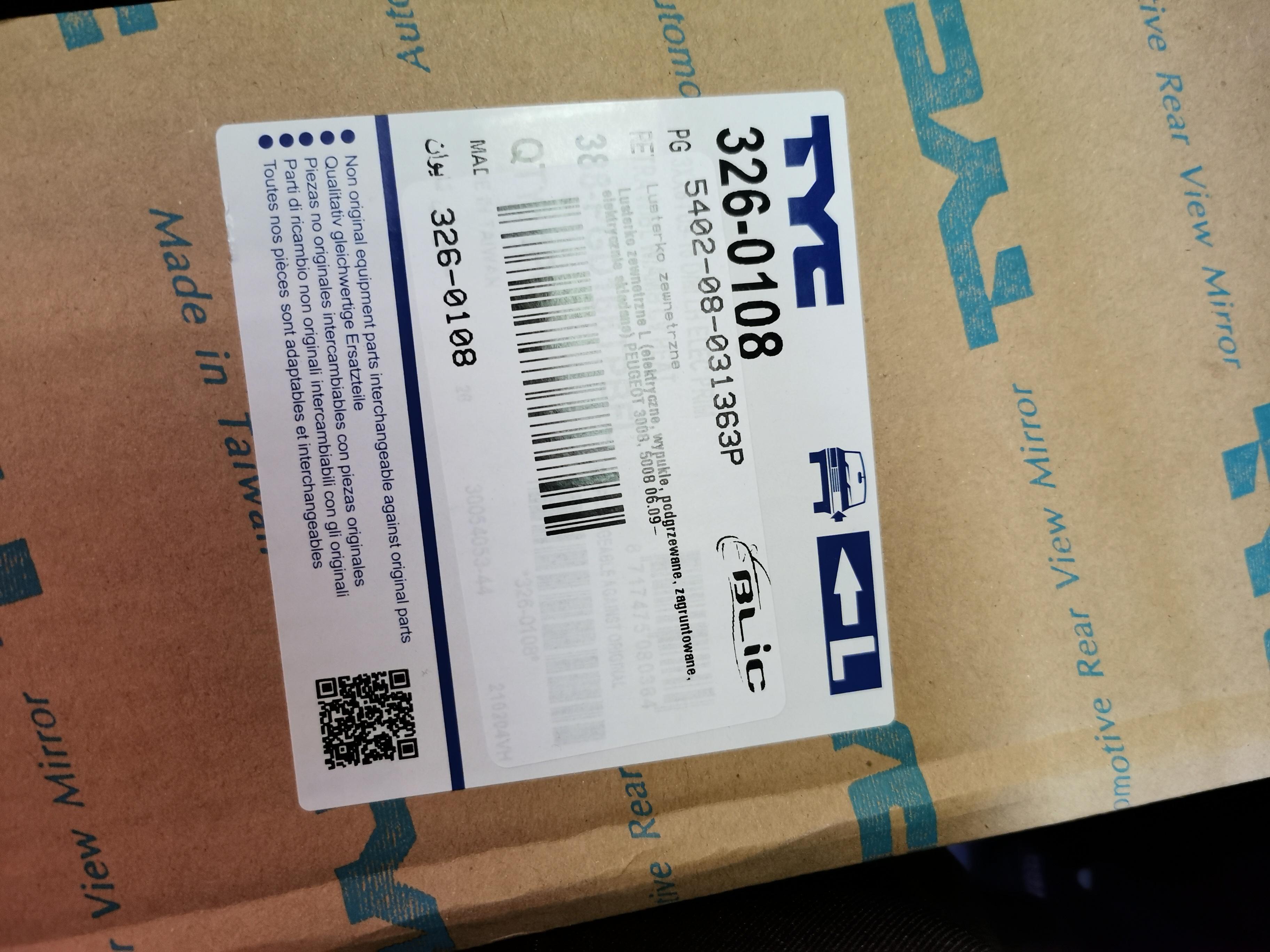

Forgot to attach which mirrors I got
Do I need to connect both mirrors?
I tried only with left one. Right one is still stock, non folding.

You may have the control pad for fold back mirrors but it must be the multiplexed version. As I mentioned, there is a multiplexed and non-multiplexed version of the control pad to go with the correct mirrors.
I can't help you with aftermarket parts - as I obviously can't compare those to original PSA part specifications.
I suspect that with multiplexed versions you may well need to have both the correct mirrors connected and the correct control pad.

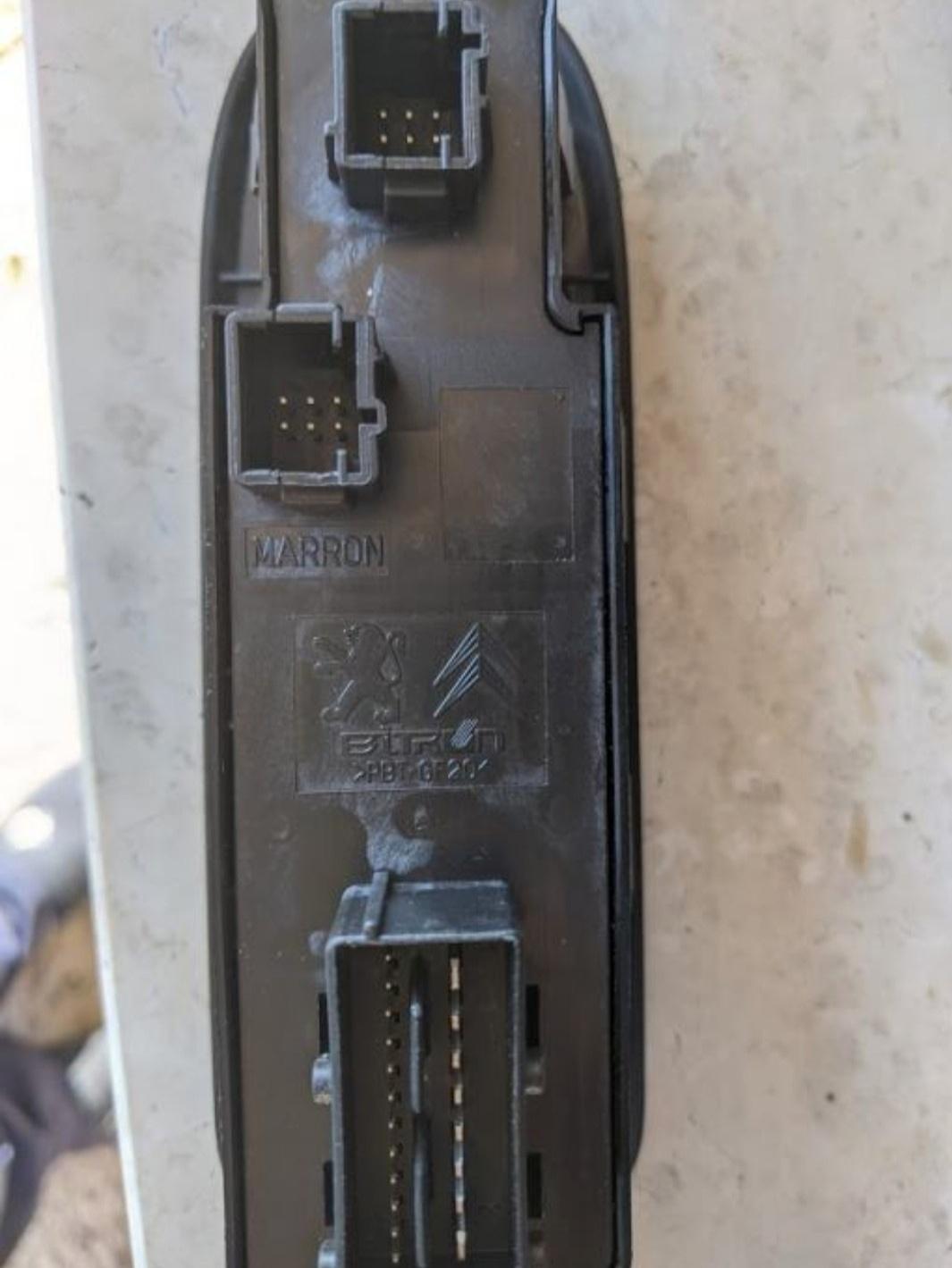

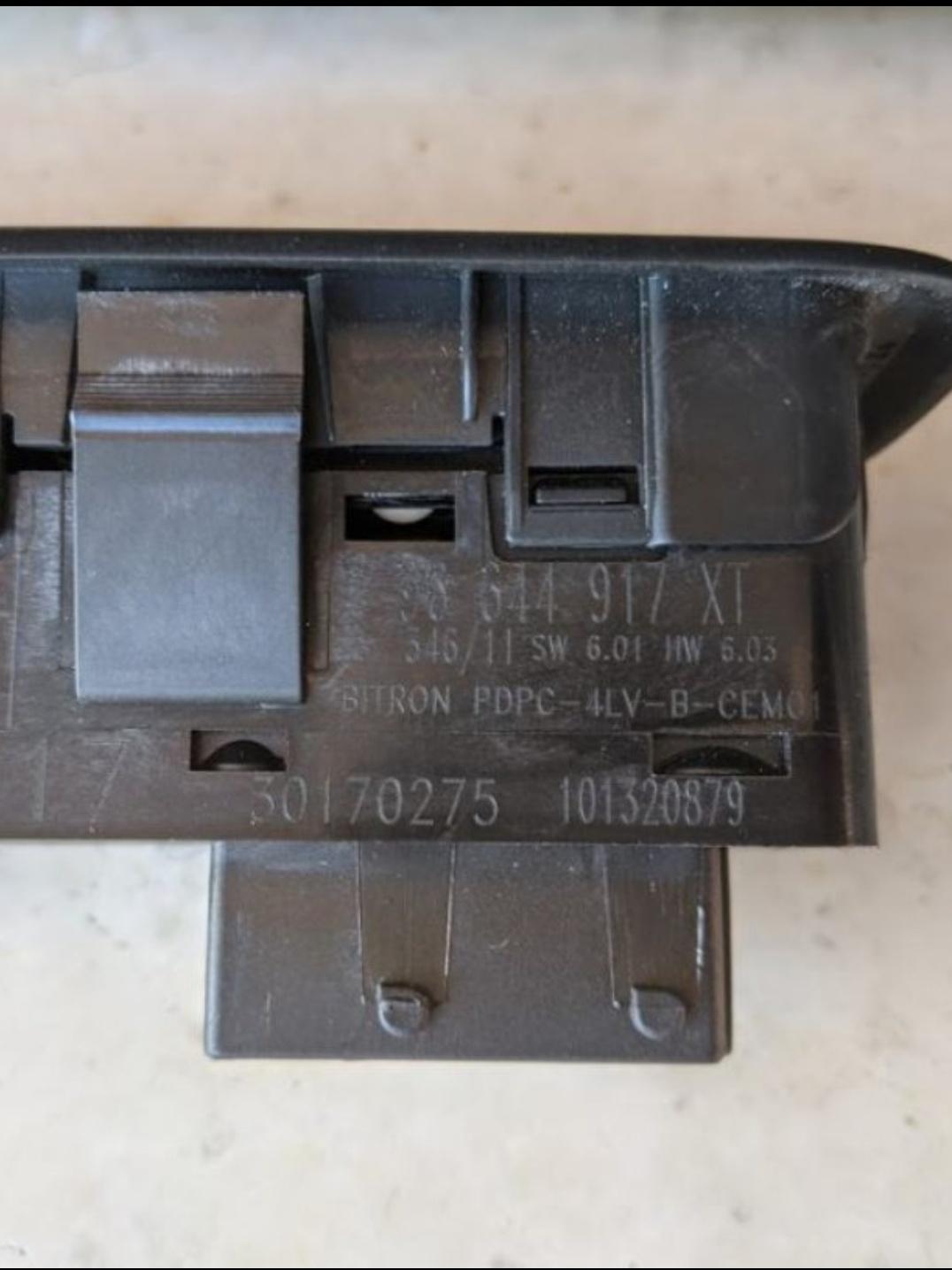

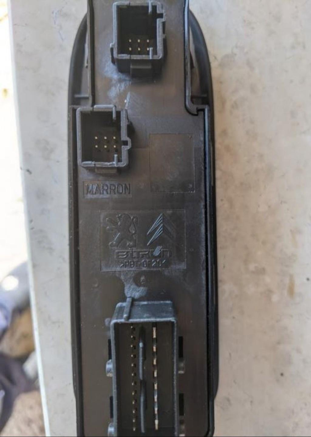

Pad is 96644917XT
Can you please check if that is correct version
And thanks again, you're really helpful
Pad is 96644917XT
- x 6955
Unfortunately that's not a recognised PSA part for this vehicle - it is probably the international number for another switch.

Thats whats written on part itself.
