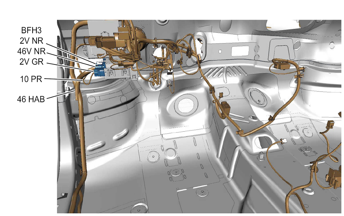

Don't want to rain on your parade Colin, but the heated seat elements are known to fail at some point with all the entering and exiting of the seat shall we say... The leather seats are more difficult to repair as they have bonded leather, so not sure about your particular seats. Do you have heated seats on both the front - and if so are they both not working?
If not check Fuse F7 in the Cabin Relay Fuse Box 1 (BFH3) shown here:
Click Image to Zoom
Click Image to Zoom

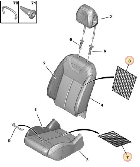

Unfortunately Marc the passenger seat works fine so looks like the element has packed up on the drivers seat. Not a big issue for now but i may look into getting it sorted in the future.
I did have a look for info prior to going to see the car and it seems a common problem which i think entails a seat base replacement
Colin
Colin
- x 6945
Re: C4 purchase advice needed on what to look out for please
They do sell the heated diaphragms separately, but I don't have any info on fitting these Colin
They are £136.50 for the Seat Squab (7) part 8925E1
and £150.29 for the Seat Cushion (8) part 8925E4
