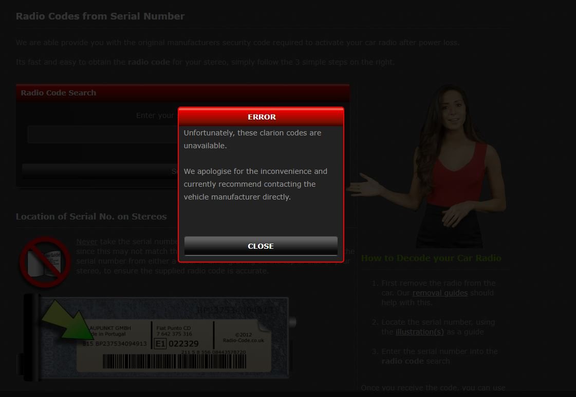

I didn't mean to be rude. I just showed that this site can no longer fulfill this type of request. Only that.white exec wrote: 23 Jun 2021, 06:54 Sorry to have to say this, but you really do need to be a tad more communicative, out of politeness to others trying to help, if nothing else.

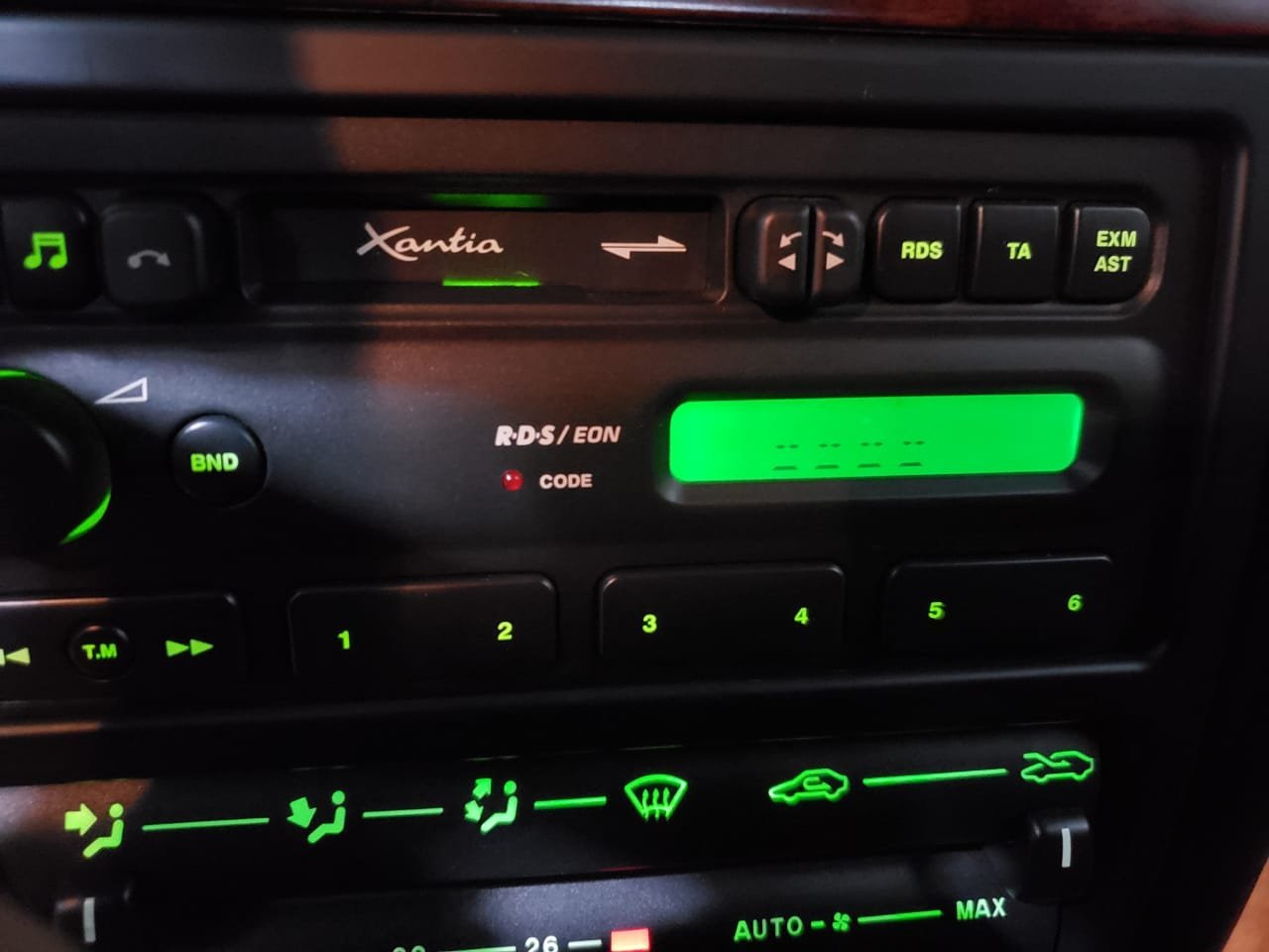

Update!
Need to left the radio with the double dash line. Within 1 hour the word "Code IN" appeared!
Thank you!

Ok, so better than waiting 30 hours and at least you know for future reference - enter the code slowly and surely to avoid a lockout - each time the code is entered wrongly, the time increases before you can try again.
