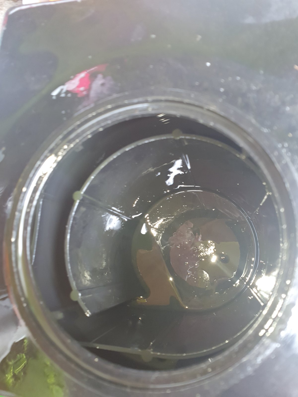

A lot of the read ups on changing the LHM I have read on here talk about removing a white plastic disc from the LHM tank which all the gunk collects underneath, but I don't see any such disc. All I can see is the internal baffles. Is the XM tank different or am I missing something?
The only white disc I found was the one that seems to have fallen off the bottom of the level indicator tube
Thanks
Thanks
