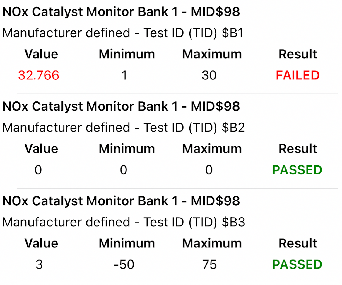

Before I did any of this I had used the "Car Scanner" App with a WiFi OBD2 dongle on my car to check for fault codes. None found.

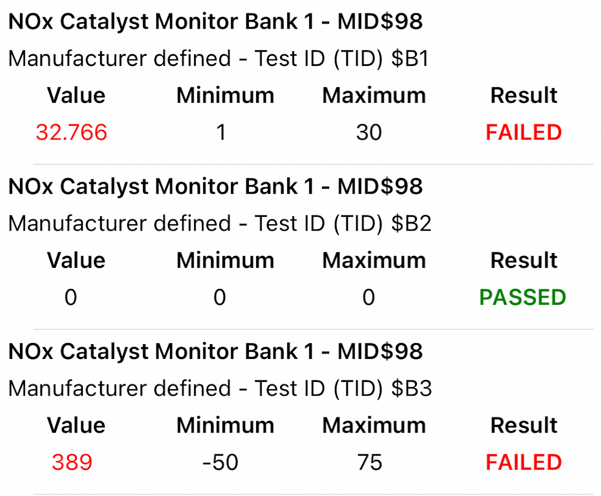

When I looked in "Noncontinuous Monitors" I discovered one fail. "NOx Catalyst Monitor Bank 1 - MID$98 Test ID $B1" ($98 & $B1 I would guess are hexidecimal addresses).
Now with the AdBlue tank empty we went on a long Sunday drive to my mother-in-laws. It was her birthday and it's also mother's day here in NZ. :)
That would be about 100Km round trip.
After this trip I plugged in my OBD2 dongle and checked the errors codes. Still no ECU errors but the "Noncontinuous Monitors" now have 2 errors.
The new error being "NOx Catalyst Monitor Bank 1 - MID$98 Test ID $B3"

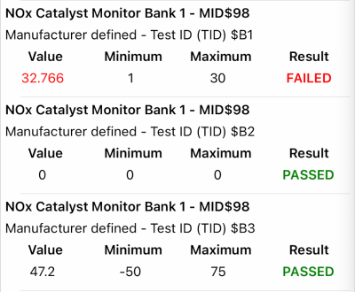

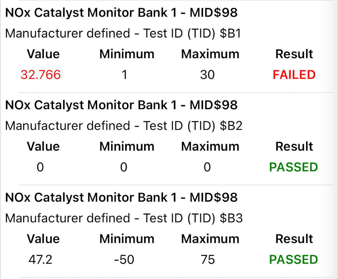

So I hooked up the OBD2 dongle and took another reading.
It's now back to just 1 error code and the reading 32.766 has never changed. It's been at that value ever since the problem started.
The other NOx sensor now reads 47.2 which is well within the manufacturers threshold of -50> <75
Wife took a very short journey so I'm not too concerned about the higher reading of 47.2 compared to 3 originally.
I'm reading these results as an indication that the AdBlue tank/pump system is working fine but that there's a NOx sensor issue.
I'm going to check in with my local garage to see if they can do anything before I take it to the dealer which is much further away and expensive.
Thoughts/opinions? :)

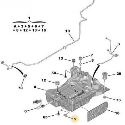

I take it that means you don't know there is a drain plug on the urea tank? (number 5) :)
You just undo a small torx screw then the plug just twists out. I wouldn't fancy getting a mouth full of urea :-&
