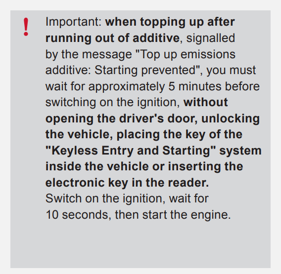

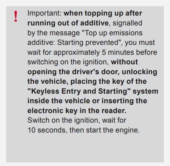

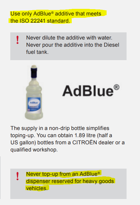

Make sure you haven't used a commercial vehicle Adblue dispenser - they can damage the system. It should also meet ISO 22241 standards. If the tank has been allowed to run dry, there is a wait of at least 5 minutes before opening any doors, putting the key in the ignition or putting the keyless entry fob anywhere near the car. The vehicle needs to go to 'sleep' which it won't do if it detects the fob on keyless entry systems.
If you've done all that, and the UREA warning light is on then you have something else going on and you will have to bite the bullet and likely get the dealer to look at it. It could well be a failing NOx sensor or other component. You can't reset anything with one of these OBD II readers.

Actually everything I have said is all in the manual.
If you don't have access to one, let me have your VIN and I'll provide you with a link to a PDF of the manual.
There's no reset you can do. Any resetting of the system can only be done with a proper dealer level diagnostic tool - depending on what the fault is of course. If you have a fault code for a NOx sensor, then that will need investigating / replacing before you look at anything else.

I don't understand why Adblue dispensed from an HGV dispenser should be forbidden. Providing it meets the ISO 2224 standard (which dictates what?) then the only problem I can see is the speed of delivery and consequent risk of overfilling and spillage.
- x 6945
Re: UREA count down not resetting after AdBlue top up
Yes - exactly why - it is the speed of delivery that is the issue - it can damage the internals - seeing that the pump heating, ECU and other electronic components are inside the tank on PSA consumer vehicles . It is not designed for the speed of delivery of commercial pumps that may not have the components inside the HGV tanks.

Well if you want to pay out over a grand for a new Adblue tank, go ahead, your choice. It's common sense to me:- Unless you are using an Adblue pump at a service station explicitly designed for passenger cars.
1) They do include that information - see the manual (although back on topic, the OP may have the incorrect early manual) - this is to be determined an am awaiting additional info.
2) Passenger vehicles have much smaller tank capacities (circa 17 litres) and only require filling about every 5600 miles depending on driving (may be slightly larger on larger passenger vehicles).
3) Some large HGVs can use 5,445 litres of Adblue a year - hence they need faster dispensers
At this stage we do not know if the OP used an Adblue dispenser designed for HGVs or not when he used a pump. But without further diagnosis we cannot ascertain whether the pump is faulty / damaged or the NOx sensor is faulty. But separate to these 2 issues, the OP may not have had the correct manual for the vehicle production year with the warnings in that I posted from the 2014 manual.
